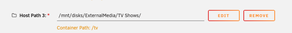

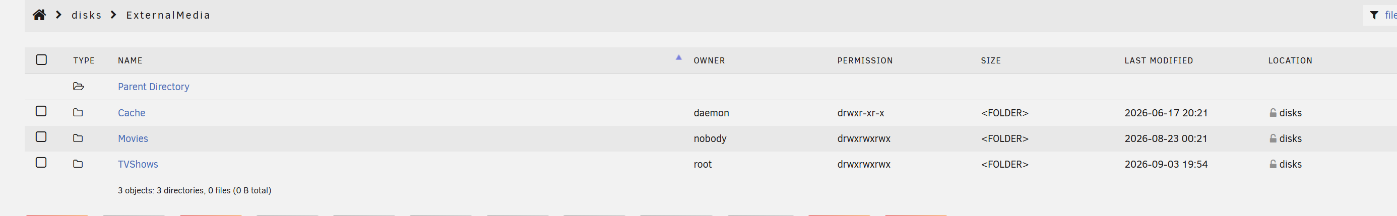

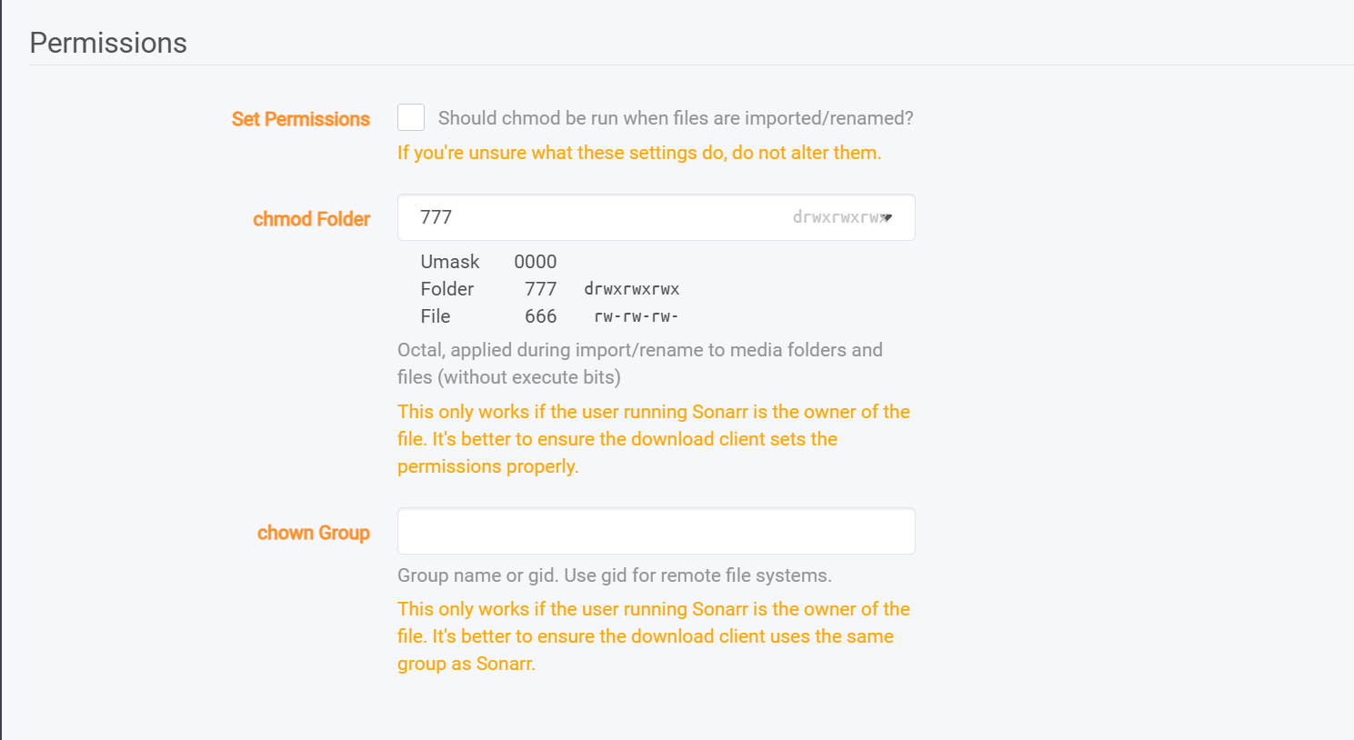

  1. Not sure what's going on but all of a sudden Sonarr is not able to import any shows for the last 2 or 3 days. I haven't made a changes, well except for updating the docker. I'm getting the following then for each episode I get Couldn't import episode /data/completed/xxx.mkv: Access to the path '/tv/xxx' is denied. I checked and as far as I can see my folders look good. Just looking for some assistance on what might have happened
  2. Well, I fixed that. For some reason had to remove the unassigned partition, format the drive, then recreate the partition. Seems to have done the trick
  3. Well, I think I fixed it. I removed the partition and formated my unassigned disk. Recreated the partition and it's now working. Not sure what happened...

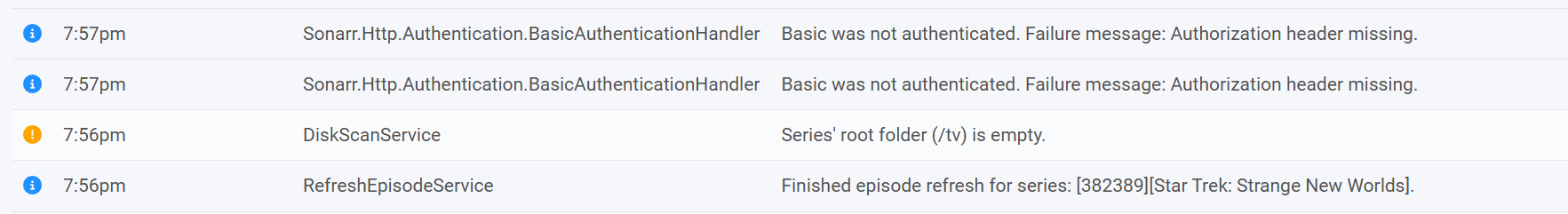

  4. I had to restore my server as I lost my usb device. Got everything pretty much back but running into a problem with Sonarr. It doesn't seem to be able to move files to the destination folder on my unassigned disk. I'm seeing the following error below. I noticed that when I add a show, it's not creating a folder for the show, so then can't copy the files I'm assuming. Series' root folder (/tv) is empty. then System.UnauthorizedAccessException: Access to the path '/tv/Daredevil - Born Again' is denied. ---> System.IO.IOException: Permission denied --- End of inner exception stack trace --- at System.IO.FileSystem.CreateDirectory(String fullPath) at System.IO.Directory.CreateDirectory(String path) at NzbDrone.Common.Disk.DiskProviderBase.CreateFolder(String path) in ./Sonarr.Common/Disk/DiskProviderBase.cs:line 218 at NzbDrone.Core.MediaFiles.EpisodeFileMovingService.CreateFolder(String directoryName) in ./Sonarr.Core/MediaFiles/EpisodeFileMovingService.cs:line 249 at NzbDrone.Core.MediaFiles.EpisodeFileMovingService.EnsureEpisodeFolder(EpisodeFile episodeFile, Series series, Int32 seasonNumber, String filePath) in ./Sonarr.Core/MediaFiles/EpisodeFileMovingService.cs:line 196 at NzbDrone.Core.MediaFiles.EpisodeFileMovingService.CopyEpisodeFile(EpisodeFile episodeFile, LocalEpisode localEpisode) in ./Sonarr.Core/MediaFiles/EpisodeFileMovingService.cs:line 96 at NzbDrone.Core.MediaFiles.UpgradeMediaFileService.UpgradeEpisodeFile(EpisodeFile episodeFile, LocalEpisode localEpisode, Boolean copyOnly) in ./Sonarr.Core/MediaFiles/UpgradeMediaFileService.cs:line 76 at NzbDrone.Core.MediaFiles.EpisodeImport.ImportApprovedEpisodes.Import(List`1 decisions, Boolean newDownload, DownloadClientItem downloadClientItem, ImportMode importMode) in ./Sonarr.Core/MediaFiles/EpisodeImport/ImportApprovedEpisodes.cs:line 159 Close Sonarr docker has the following The unassigned drive has the following I removed the TV Shows Folder and recreated it but still same error. Everything was working fine before I replaced my usb key. I copied over the config folder I had from a few months ago. Just not sure what the cause is.
  5. I ended up doing a restore of the dockers from appdata restore. Most everthing works but having one issue. It's in relation to Sonarr. When trying to copy the files to the destination folder I'm getting the following error. Couldn't import episode /data/completed/Daredevil.Born.Again.S02.2160p.DSNP.WEB-DL.DDP5.1.Atmos.DV.HDR.H.265-BLOOM/Daredevil.Born.Again.S02E07.The.Hateful.Darkness.2160p.DSNP.WEB-DL.DDP5.1.Atmos.DV.HDR.H.265-BLOOM.mkv: Access to the path '/tv/Daredevil - Born Again' is denied. Not sure why the access to the path is denied. I have this set in sonarr and the folder does exist

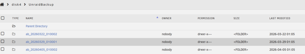

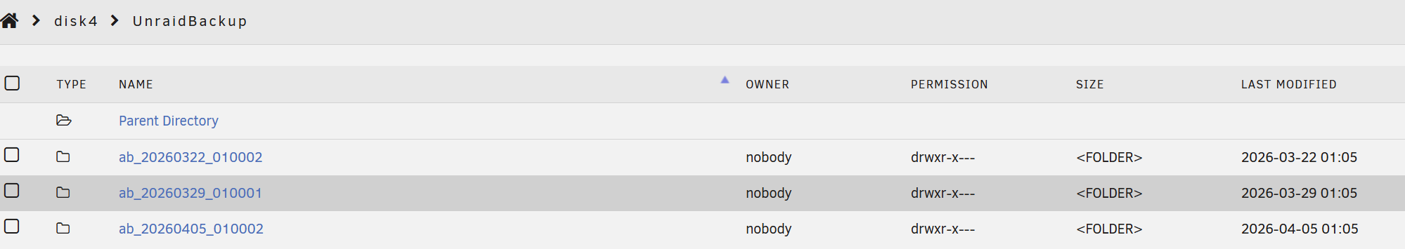

  8. I found an unraid backup from just before I shut down my server when I had to move out for my home reno which is about 2 months ago

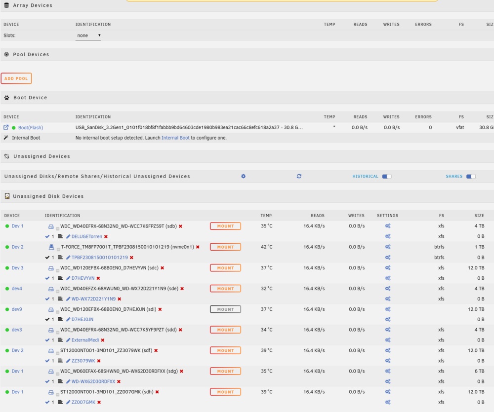

  10. I guess I have to unmount my drives, remove the read only and then assign them to the slots
  11. Good find! I looked at my posts but didn't even see that. So I could just use that and assign my drives right

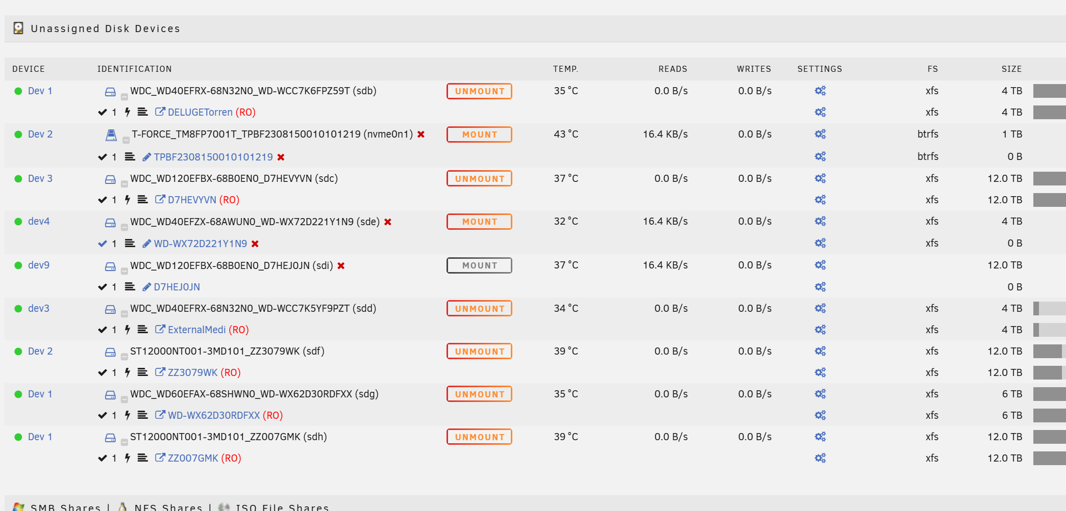

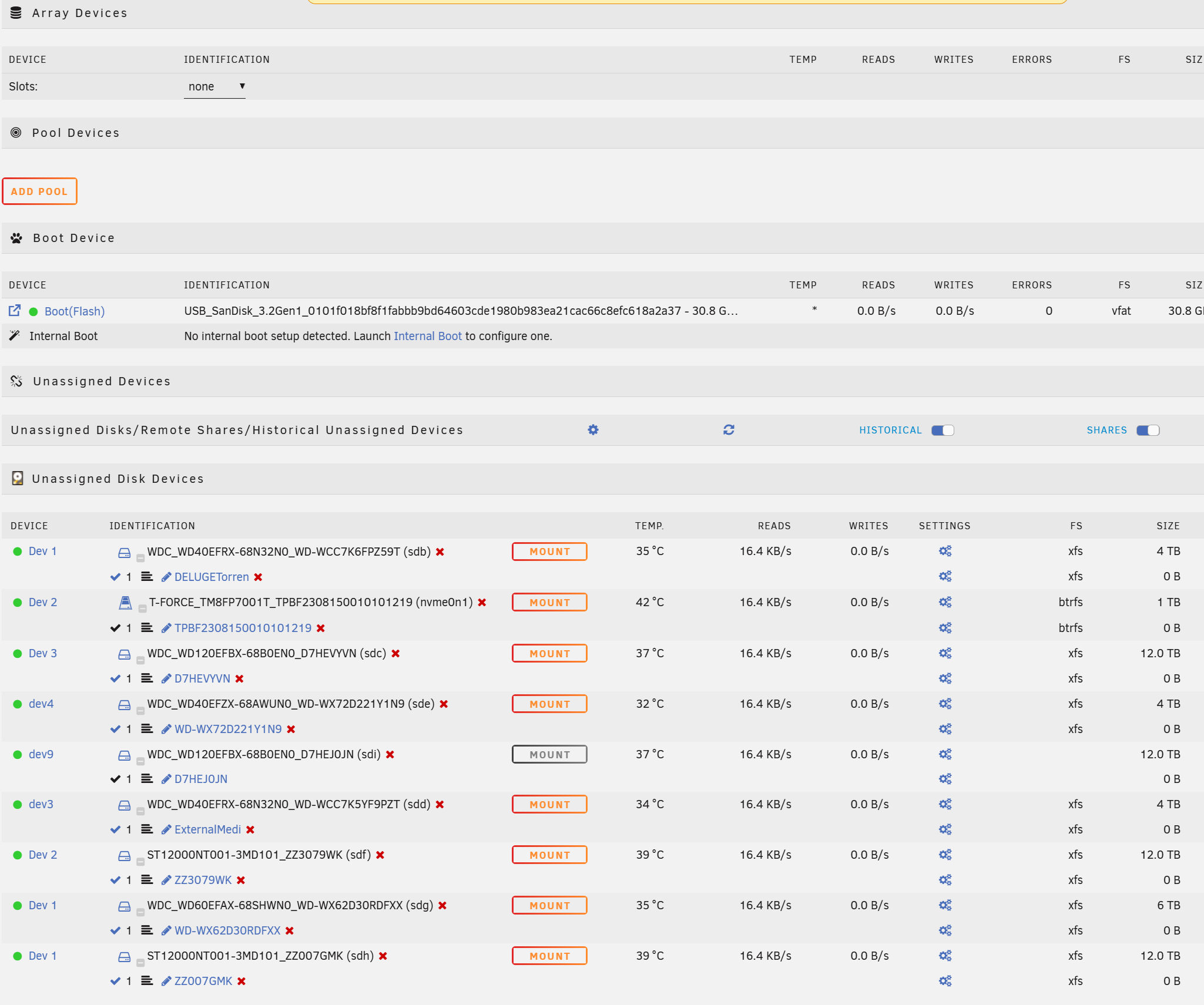

  12. This is what I now see, which would be correct. A total of 9 drives 1 x Parity 1 x cache - The T Force drive. This I know for sure 5 x data drives 2 x unassigned drives - I know which ones this are as well
  13. ok I was able to mount all the drives. I didn't try to mount the greyed out one but since I can mount all the other drives, the greyed out one must be the parity drive
  14. yup, found it. Mounting them now as read only
  15. how do I mount the drives as read only. I don't see an option anywhere
