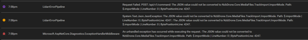

Thanks for the docker. I am getting this error when attemping to import:
Lidarr has lost it's connection to the backend and will need to be reloaded to restore functionality.
Lidarr will try to connect automatically, or you can click reload below.
This happens on chrome / firefox / edge. It presents a problem as the pages reloads and then just starts to import all over again. Let me know what other info would help.
Happens to me as well.  It is doing a lot of backend work right now though. I'm curious if that will change once everything is imported and corrected.  I do have a question about not finding artist.  I can't seem to find Jay-Z or J Cole of all people.  Any advice on what I could do to import them?  Thanks!

FWIW I have been running the volkion container for months now, and have just switched to the linuxserver.io container (because they rock). I am seeing the same error as reported above, while configuring the application (and wasn't on the volkion container. I assume that the version of the app within the container is not necessarily the same. Off to get some dinner but will dig a bit more and see if I can find some info that is a bit more helpful.

I haven't been able to find any more info.
Things I have tried.
Changed logging to debug, and then trace - have seen the backend disconnection error messages, but nothing captured in either of these files.
I have lidarr set up behind an nginx reverse proxy, and get the same error regardless of whether I am going direct via a local addressed, or via the external address.
will keep digging

volkion lidarr is the same as ours (using our baseimage in fact)
I too just tried Lidarr and had the same issue.  Have a decent sized music library.  Gave up for now, will wait for Lidarr to stabilize some and try it again.  Looking forward to moving away from headphones.
I've just switched from the binhex docker as this one has a higher version number.  No problems with disconnects on that version, but the same problem is happening to me as well
Likewise, also getting the disconnects every 5mins give or take.
working with the lidarr team we have hopefully fixed this
pull the latest image

So far it is working. It it finally able to scan all my folders and I was able to hit import the matched artists and it completed!!

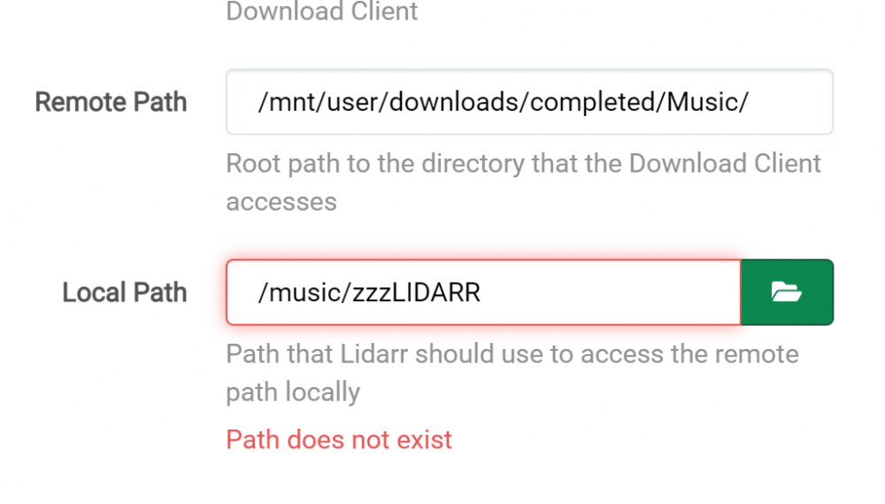

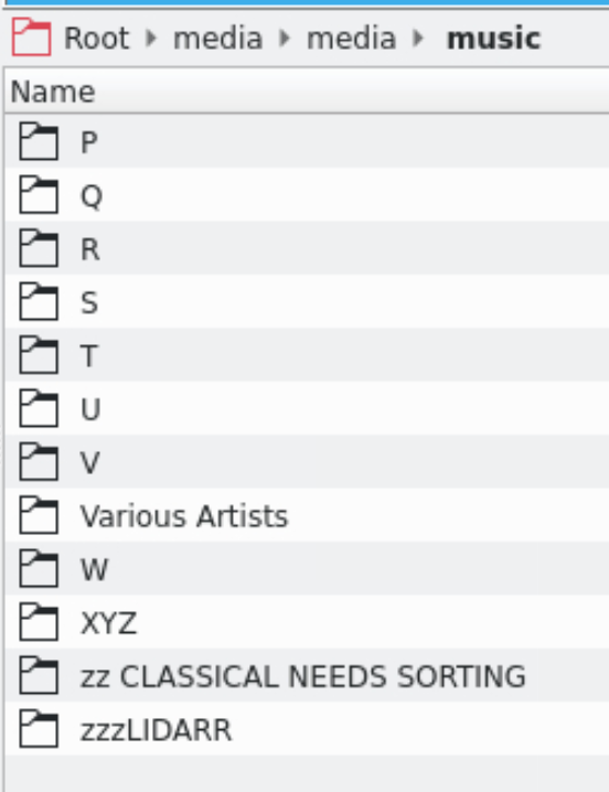

Hi, I'm getting the following error:
[Error] DownloadedTracksImportService: Import failed, path does not exist or is not accessible by Lidarr: /data/complete/
I believe my mappings are correct:
Internal Lidarr log (many like this):
19-1-7 21:20:10.1|Error|DownloadedTracksImportService|Import failed, path does not exist or is not accessible by Lidarr: /data/complete/Stevie_Ray_Vaughan_And_Double_Trouble-Texas_Flood-(Legacy_Edition)-2CD-2013-404
Edited by mcjfauser

Wrong support thread. You're using Binhex's container, not ours.
I have both installed, that was just a part of the troubleshooting. Same issue with Binhex.
I'll post there instead though seems as it's the active one in this screenshot.
