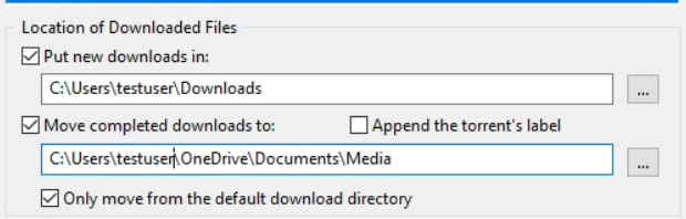

Hello guys.  I have Lidarr docker running on my unraid server.  Lidarrs download clients are SabNZDB and utorrent.   SabNZDB is also a docker on unraid but uTorrent runs on a remote PC.  I am able to connect utorrent with Lidarr and send my downloads there but the files are not being transferered back to my storage location on unraid.
On Lidarr I am getting an error "Remote download client uTorrent Remote places downloads in C:\Users\testuser\Documents\Media but this is not a valid ubuntu path. Review your remote path mappings and download client settings."
I found this guide that kind of explains how to map remote drives and local drives but I cant see mto follow it.
https://old.reddit.com/r/usenet/wiki/docker
What I want is when the files are done downloading the files are transferred back to my unraid server to my media folder.
These are my mappings:
 Lidarr Docker config
utorrent on remote PC  settings
Any help would be appreciated.

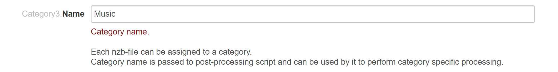

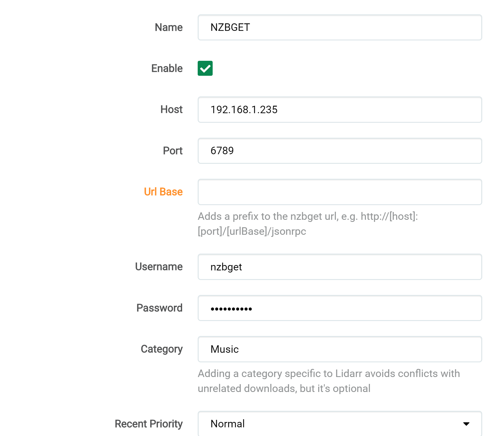

Hey All,
   Im having an issue with Lidarr. I have it connected and testing good with my NZBGET container as well as my Plex container. However, Lidarr is finding NZBs to be downloaded, loading them into NBGET, then they are downloaded and NOT imported into the media folder.
   To be clear, some are loaded but not all. its like Lidarr doesnt recognize some of the downloaded files. I dont see any correlation of which Lidarr moves, and which it doesnt.
Any guidance is greatly appreciated.

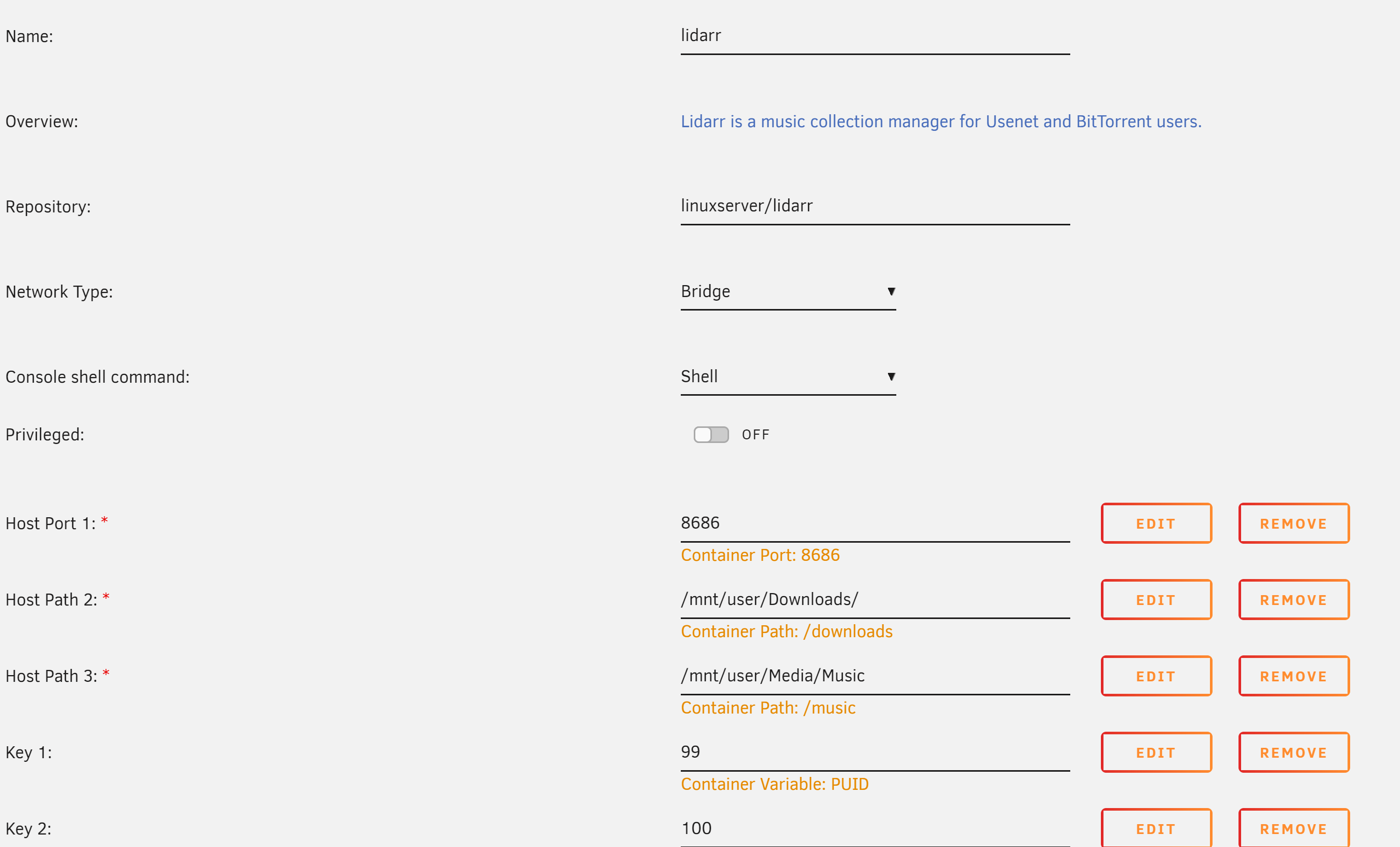

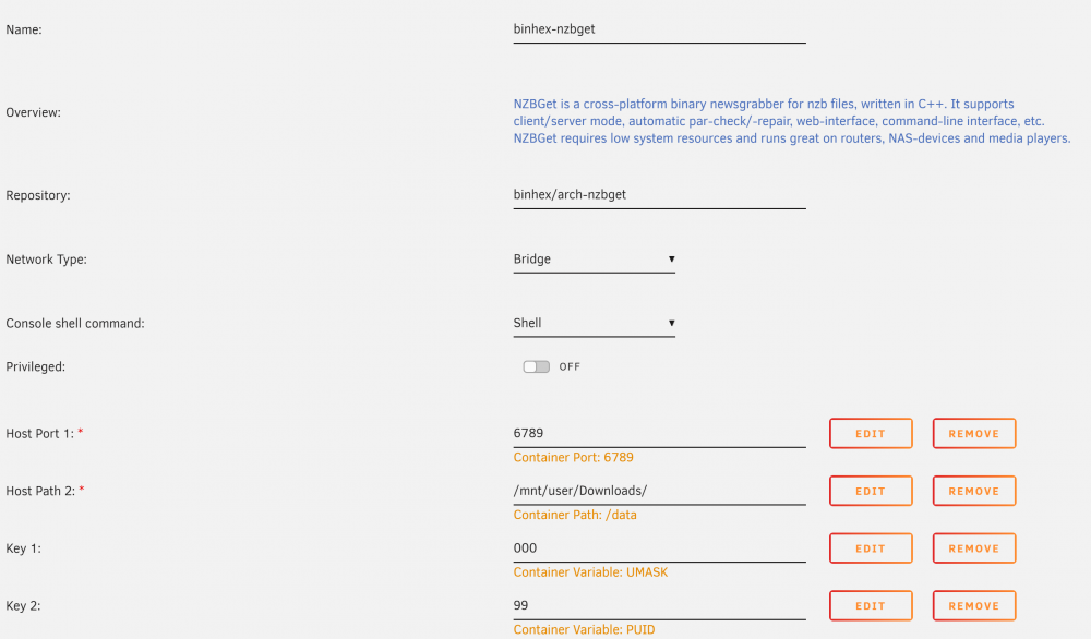

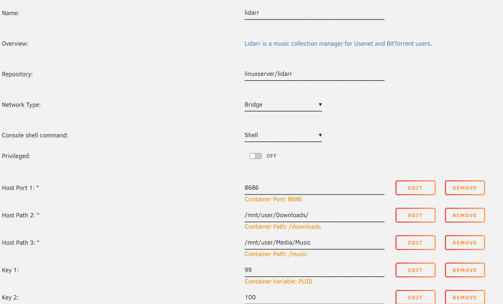

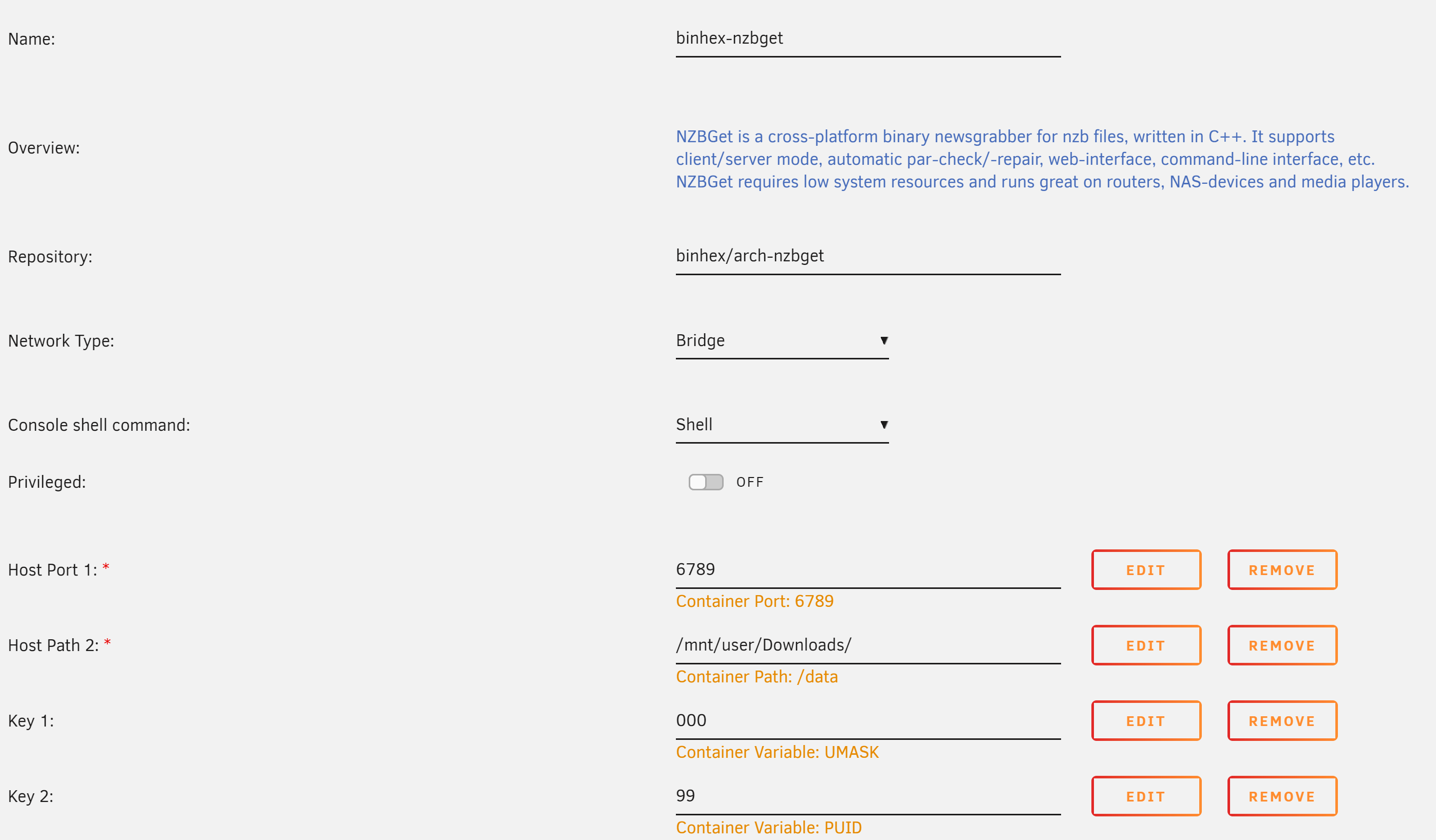

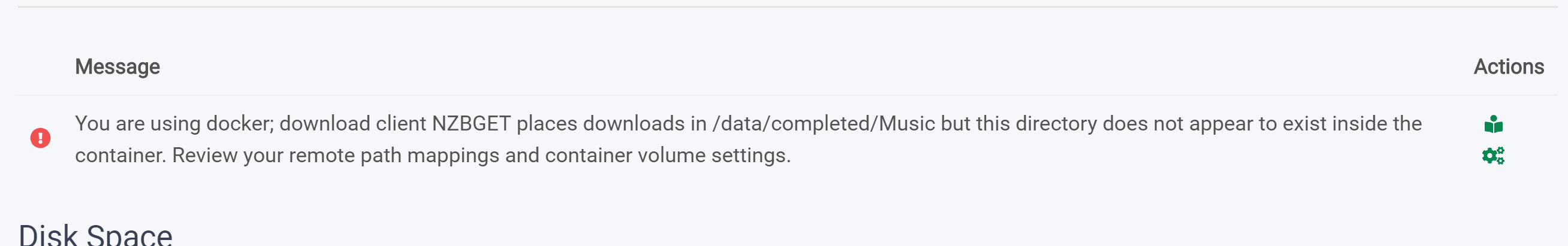

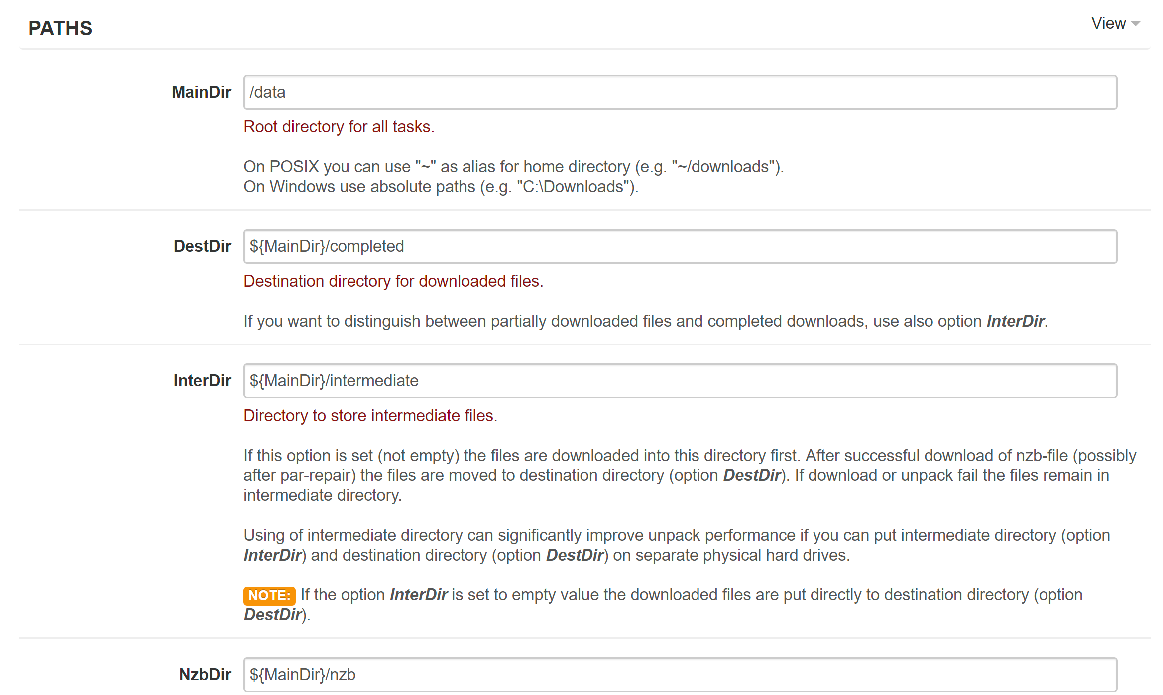

Hey guys I feel like an idiot but I have read through this forum and documentation on Github. I cant seem to wrap my head around what my issue is here. I have sonnar and radarr setup and working no problem. I am finally getting around to Lidarr but seem to have a mapping issue.
Its clear I am missing something but for the life of me it looks correct. When I try to map the downloads in LIdarr to /Media it will not select the folder. No error or anything just will not select it. Any clues on what I might be doing wrong here?
Your mapped path to /mnt/user/Downloads is different. You told nzbget to access it at /data, but you told lidarr to access it at /downloads. Both sides of the mapping must match.
Thanks a ton for your reply. I was assuming that /data was being mapped as mnt/user/Downloads so with lidarr I needed to map the /downloads to the same folder to see them hence the /downloads being mapped to /mnt/user/Downloads.
Apparently that is not the case. Oddly that’s what I am using for sonarr so I figured it was correct. Based on the shots above how would you suggest setting it to ensure it functions properly?
Edit: I believe I’ve got it. Sorry folder mapping for some reason is hard for me to fully grasp. Thanks a lot for the support
All references to /mnt/user/Downloads must have the same container mapping for all containers that pass information between them. If container A requests a file be downloaded to /data, container B must also reference /data, not /downloads to be able to find the file seamlessly.
Change the mapping and application references for any containers that don't match to a matching container path. Doesn't matter which container(s) you change, but all containers that use /mnt/user/Downloads must internally see the same path, whether that's /data or /downloads doesn't matter as long as all of them are the same.

Hey folks.
I've been reading this forum trying to find my specific issue but haven't found it yet.
Hopefully this is a very simple fix.
MY GOAL: I want Lidarr to download into a staging directory so I can review the tagging before I add the music to my collection.
I realize I could just have it stop at the Completed Downloads folder, but that is a separate and useful part of the workflow for me.
The zzzLIDARR folder is just for tag-checking and fixing.
I see a lot of folks saying to set up my paths like Radarr or Sonarr. So I tried that:
Here is how my paths are set up in the RADARR Docker page:
And here is how it looks in the Radarr Download Client page:
For Lidarr I set the docker page like this:
But when I try to set the download client paths I get this:
The only difference is that I'm routing the downloads to a sub-folder.
The path does exist as we can see here in Krusader:
So, what am I doing wrong?
Edited by kennelfort
On 11/24/2020 at 3:37 PM, kennelfort said:
Hey folks.
shouldnt local path be /media as thats what you told your docker it is
Oh wow. How did I miss that? I'll fix that and report back. Pretty sure that's my problem!  Thanks!!!
