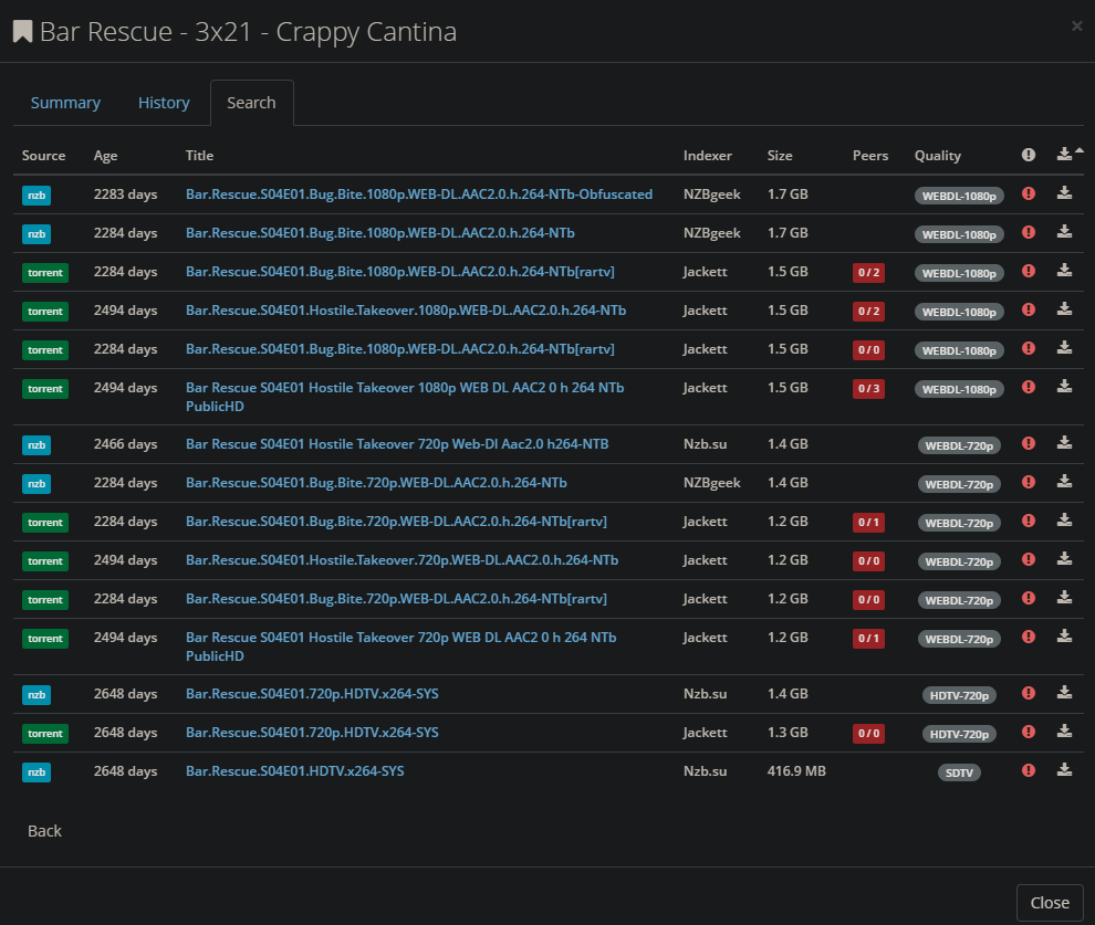

  11. Hi, So when I search for an episode in Sonarr, for instance bar rescue I see s03E21 but when I click on the manual search button it only shows S04E01. This happens for a few episodes. And when I hover over the red circle it just says that the file is larger than the maximum allowed. It does not say "Wrong Series". I read a post that says refreshing the series in drone fixed this but I think they were running docker on an actual PC and not in unraid. https://forums.sonarr.tv/t/wrong-season-numbering/1008/8 Can anyone help with getting sonarr to show the correct episodes when I click manual search? Thanks

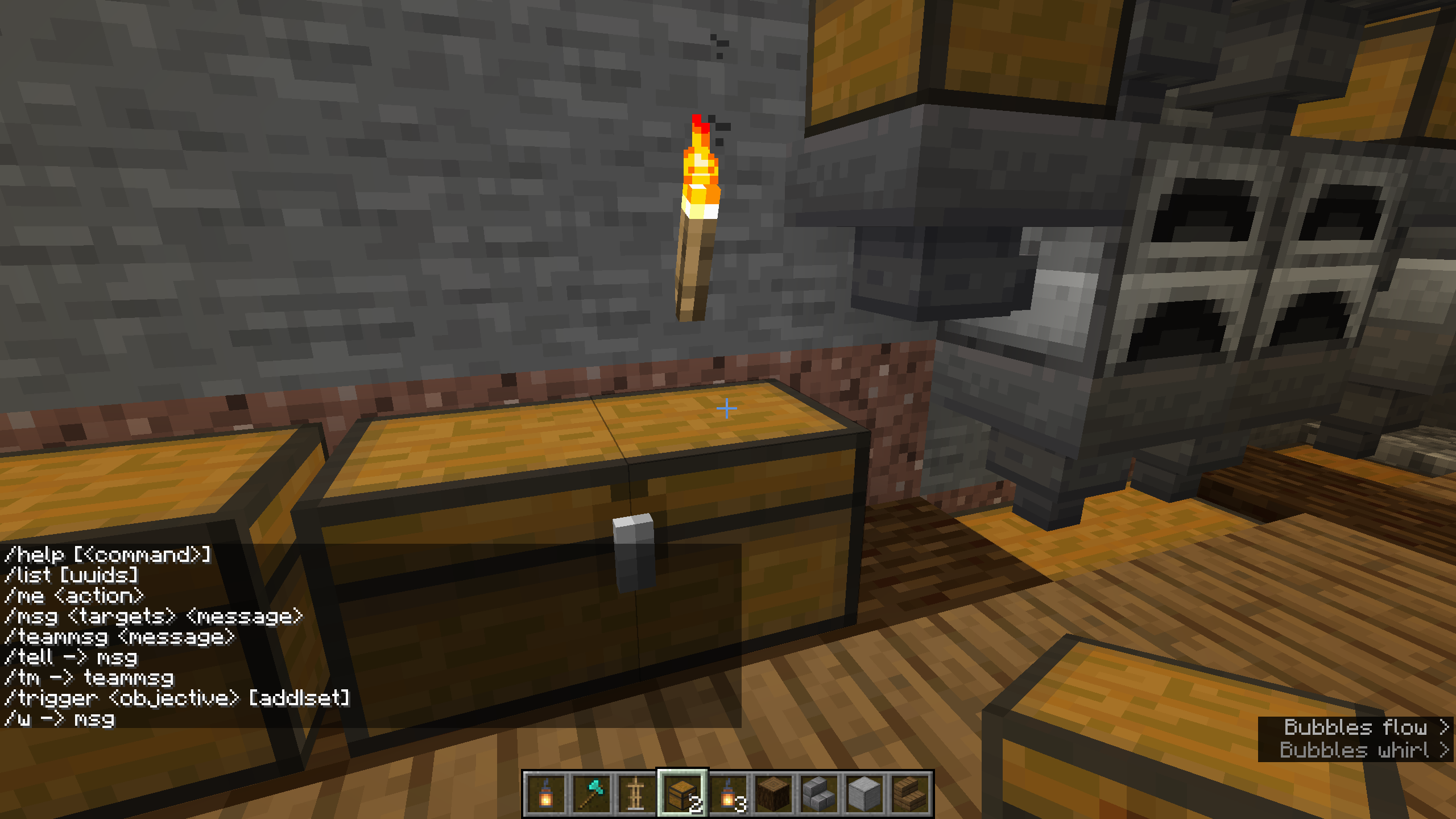

  12. left click icon in deluge unraid web ui, select 'web ui' and enable cheats This does not work when you sleepct multiplayer. You just join the server. I guess I left that part out. no. I actually found a command that works. 1. Launch the unraid terminal 2. Run the following command "docker exec -u nobody -it binhex-minecraftserver screen -r minecraft". replace 'binhex-minecraftserver' with whatever the name of your docker is. Then the console launches. Thanks for the help.
  13. I moved my Single player world to my minecraft server. It launches fine and all of my buildings are there. Cheats are enabled on the Single Player world. But when I launch the server I am unable to do any commands like changing the game mode. It only gives me a list of the commands in my screenshot. I tried launching the console by using the following command but I get an error. docker exec -u nobody -it binhex-minecraftserver /usr/bin/minecraftd console https://github.com/binhex/documentation/blob/master/docker/faq/minecraftserver.md OCI runtime exec failed: exec failed: container_linux.go:346: starting container process caused "exec: \"/usr/bin/minecraftd\": stat /usr/bin/minecraftd: no such file or directory": unknown So from the error its saying that it doesnt exist there. Im sure it has to do with me having my appdata on my unassigned devices drive instead of the default location. I looked in the binhex-mincraftserver folder but cant find the path to the minecraftd Below is the path to the minecraft folder on my unassigned devices. /unraid_unassigned_disks/Samsung_SSD_860_EVO_500GB_S59UNJ0N109855F/appdata/binhex-minecraftserver/ What I am looking to do is enable cheat commands on my Minecraft server and the only way I can find is through the console. I am open to other ideas as well. So summary 1. How do I access the Minecraft Console through Unraid terminal? 2. Is there another way I can get the in-game cheat commands enabled if I cannot access the console? Thanks
