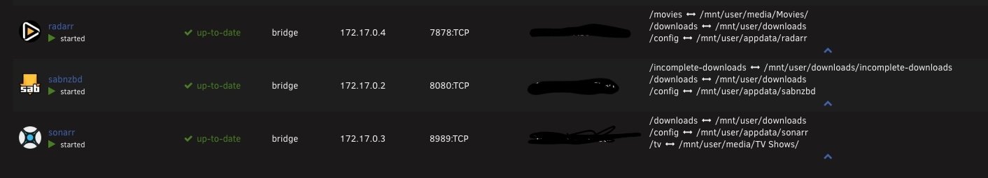

  1. I just am moving everything over from Synology 1019+ that died. So I am totally loosing my mind. I cannot wrap my head around why I can't fix this. I have Sonarr,Radarr and Sabnzbd set up. Sab goes and downloads the file but I can not get Sonarr or Radarr to import the file. -You are using docker; download client SABnzbd places downloads in /incomplete-downloads/complete but this directory does not appear to exist inside the container. Review your remote path mappings and container volume settings. I have reviewed the remote path and can not understand how to fix it

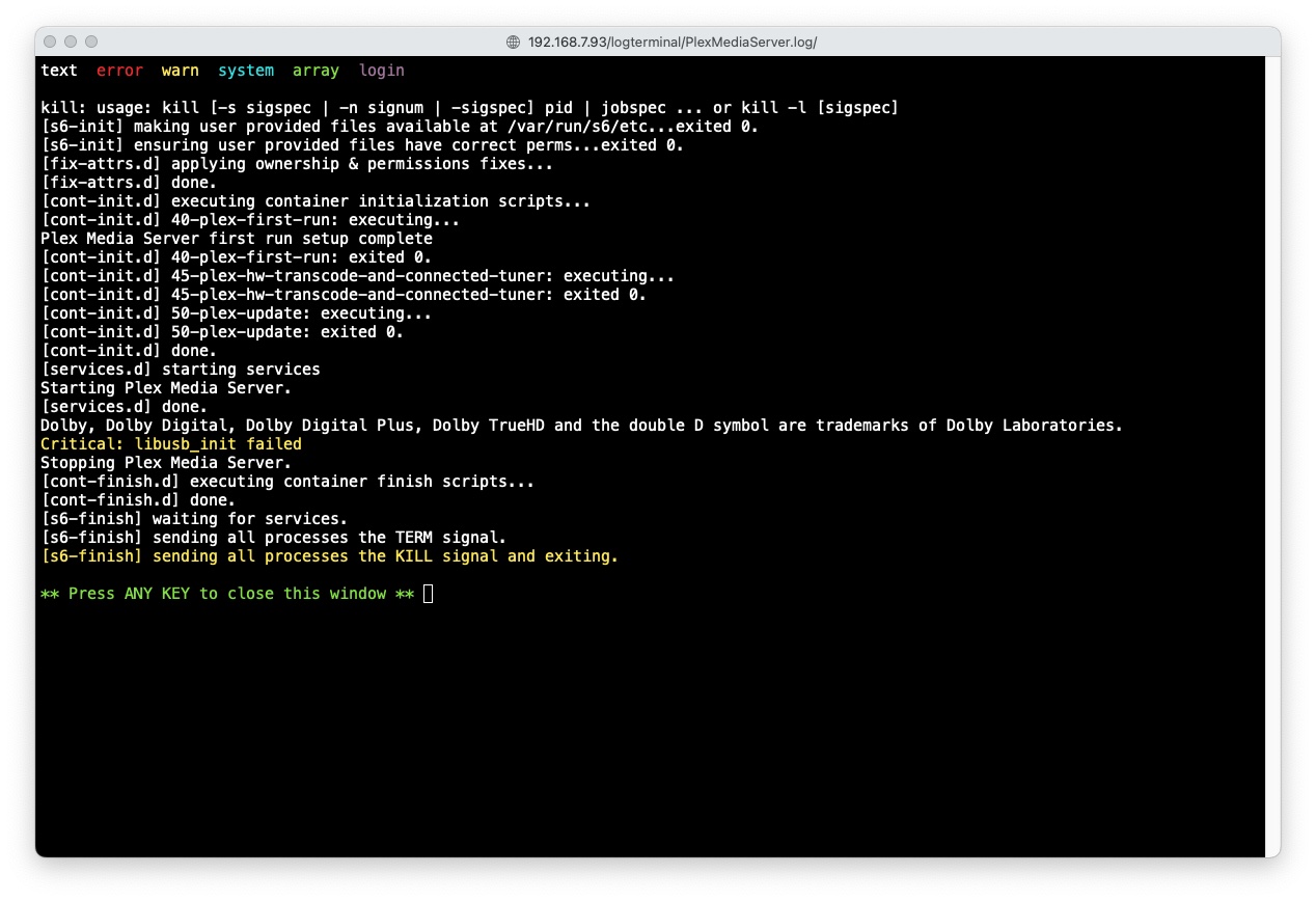

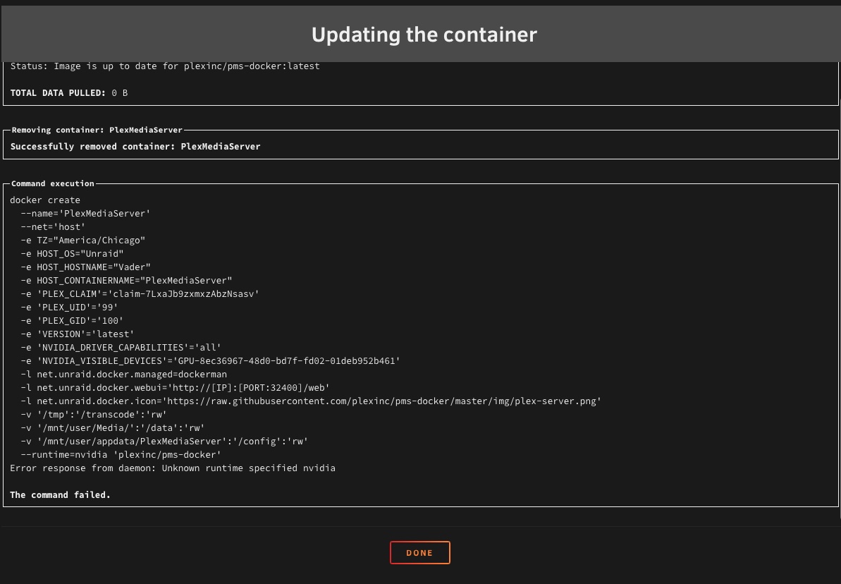

  8. Is there anyone running the offical Plex Docker? So this morning I made the jump from 6.8.3 to 6.11.1. and the only container not working was Plex. I thought I had the official container with Nvidia plugin for transcoding and after the second reboot of my server the container was just gone. but when I tried to download a new container the parameters where not the same. I feel like I have to rebiuld my plex server? I did not lose any of my movies.
