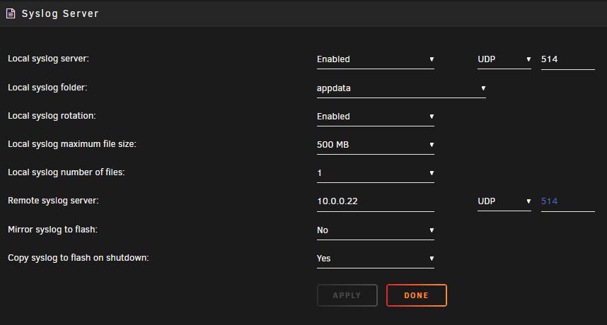

  1. Like this? 10.0.0.22 is the local IP of my unraid server. I see the file exists now so next time it crashes I'll just reboot and upload it here, right?

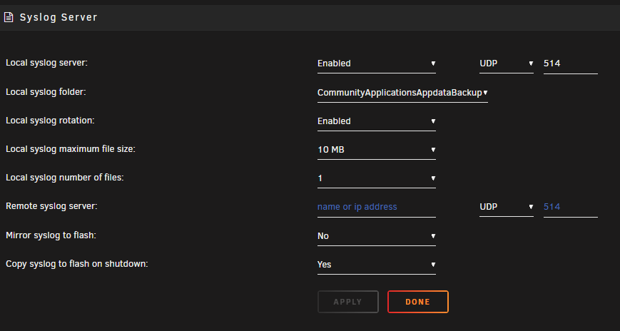

  2. Thank you JorgeB. I've never touched that setting before, is this sufficient?

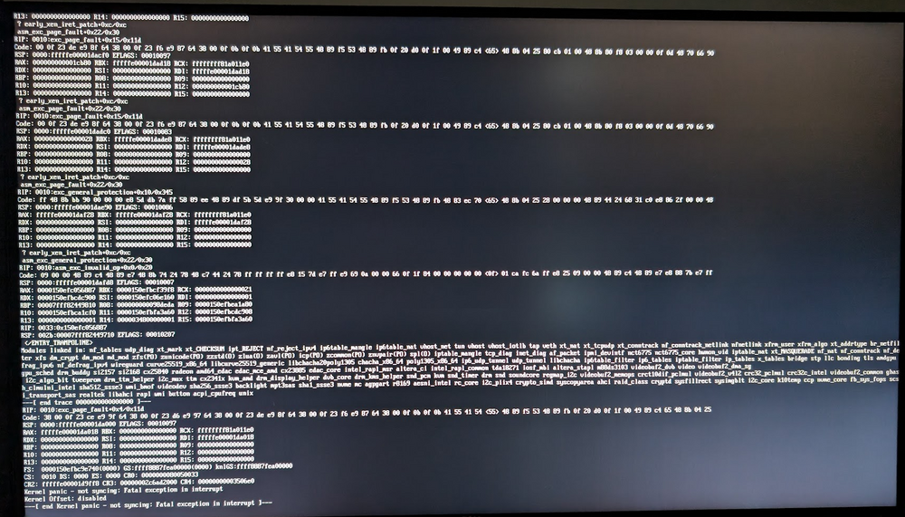

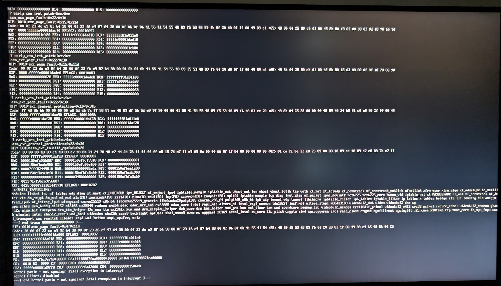

  3. This is the second of two kernal panics I've had in a month. I did not post about the first one as I thought it might just be random. I always keep unraid up to date to the latest stable release. I captured this photo before I rebooted the server: hal9000-diagnostics-20240821-1317.zip
