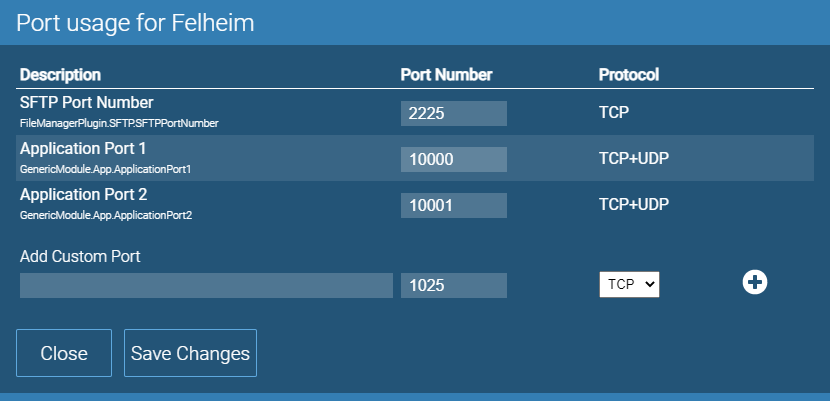

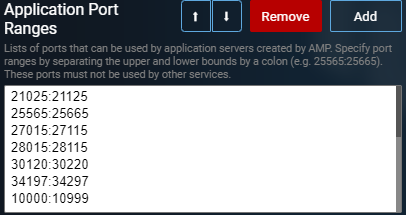

I'm using an UDM.
Here's myport forwarding:
-  I know it's a bunch of ports, I'm just too lazy to edit it all the time, that's also why logging is enabled.
It's added in the docker settings:
- I couldn't exactly remember how it should be, but it didn't complain, so I assume it's right.
I've added the ports in AMP:
And in the instance:
I can't connect to it.
This example is a fresh Valheim server. I can't connect to it directly and it's not showing up on the public list either.
When I check with https://www.yougetsignal.com/tools/open-ports/ and check port 10000 for example, it's saying it's down.
What am I missing?

On 6/17/2021 at 10:09 AM, Nanobug said:
I need help....
I messed up my AMP container, so I started over.
I know I'm missing something here, because I've done it before.
For some reason, I can't an instasnce to work.
I'm using an UDM.
What am I missing?
Can anyone help with this?

Hi. So I think I have everything set up correctly.
I'm running a minecraft server on Port 25566, I added it into the allowed application ports in the networking config.
I have port-forwarded it on the AMP container itself.
I cant connect to it on minecraft however (Just on the local network, same as the server)
The endpoint says 0.0.0.0:25566. Is this correct? Shouldn't it be saying 172.17.X.X or something, the container IP's?
Very confused, any help is much appreciated

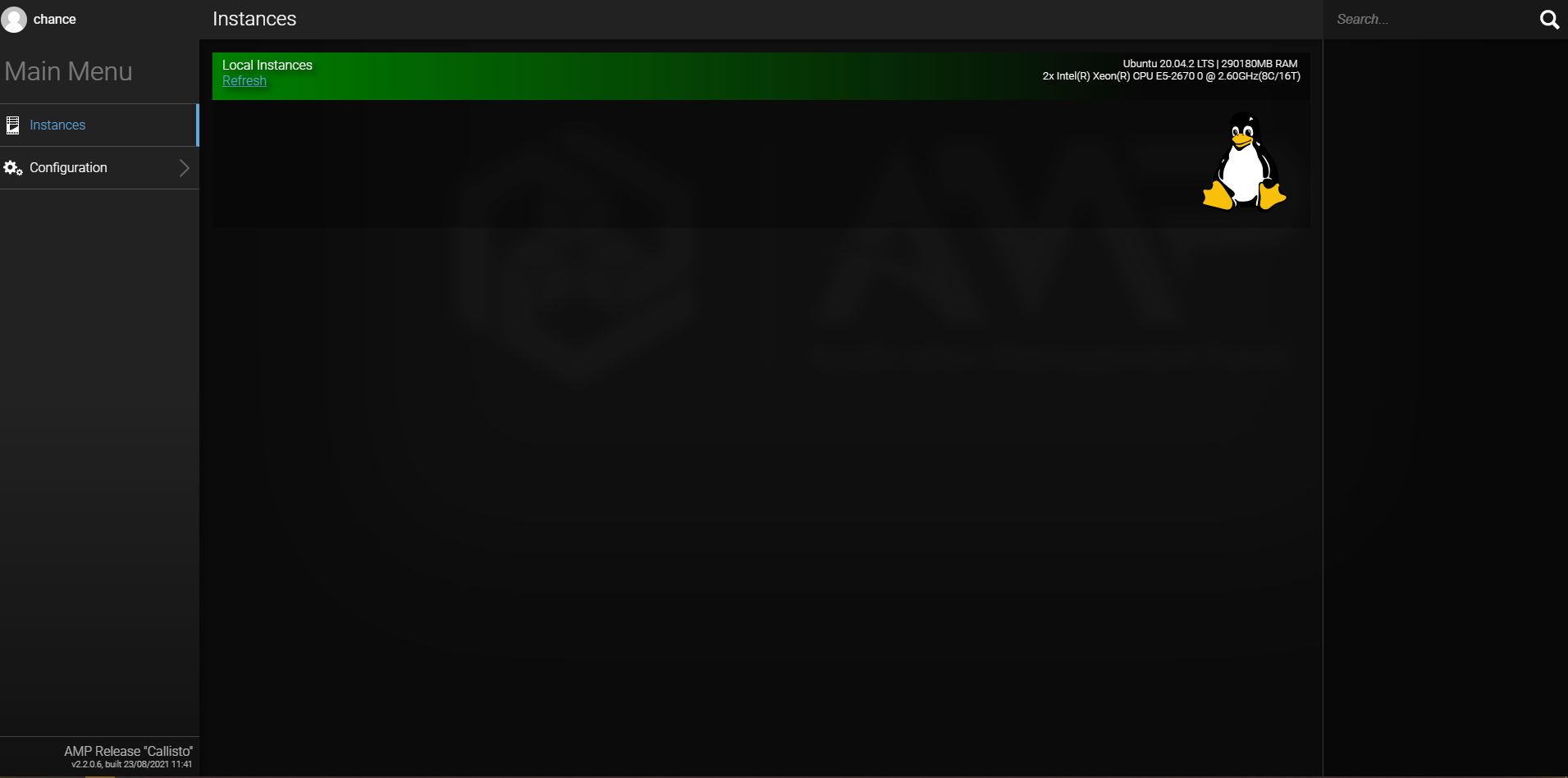

I keep getting stuck with this page and I don't know what's causing it.  I've tried 3 different browsers on 3 different devices and keep getting this page.  What am I missing?  I tried turning off all of my filters, including pihole, to no avail.
Personally, I've mostly ditched the container version. CubeCoders (developers of AMP) doesn't support the container version since they didn't make it. So if you need help, you need to do get it here. And sometimes it takes a while between the answers to the problems.
I can't tell you why it's not working though :/
