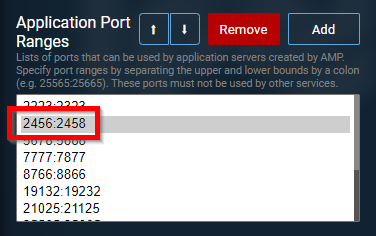

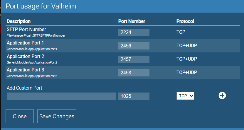

On 2/21/2021 at 1:15 PM, CorneliousJD said:
Here's my setup screenshots, hope it helps!
AMP/Configuration/Networking
Valheim Instance Ports
Then in Valheim instance, configuration, server, you can set your wold name, seed, and password (must have password from everything I'm reading i think?)
Then forward ports 2456-2458 *UDP* through your firewall, or to test locally just connect to your unraid IP running AMP on port 2457 (the actual port it uses to connect).
e.g. 192.168.1.100:2457

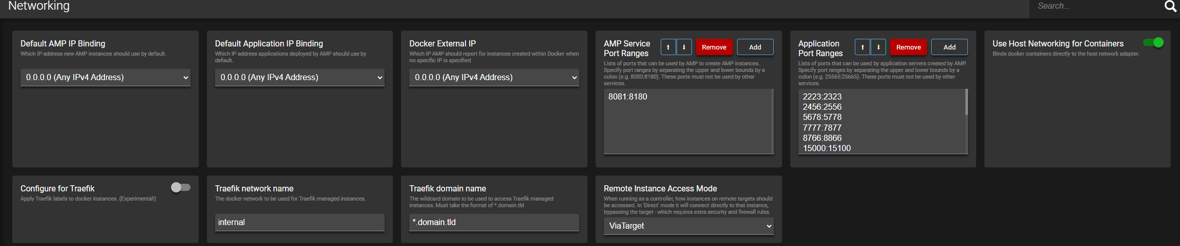

So I've followed these settings and nothing I try allows it to connect over the local LAN.
What are your settings for AMP's networking itself?  Like the Default AMP IP binding, Default Application IP Binding, Docker External IP?  Did you set up the container in Bridge mode?

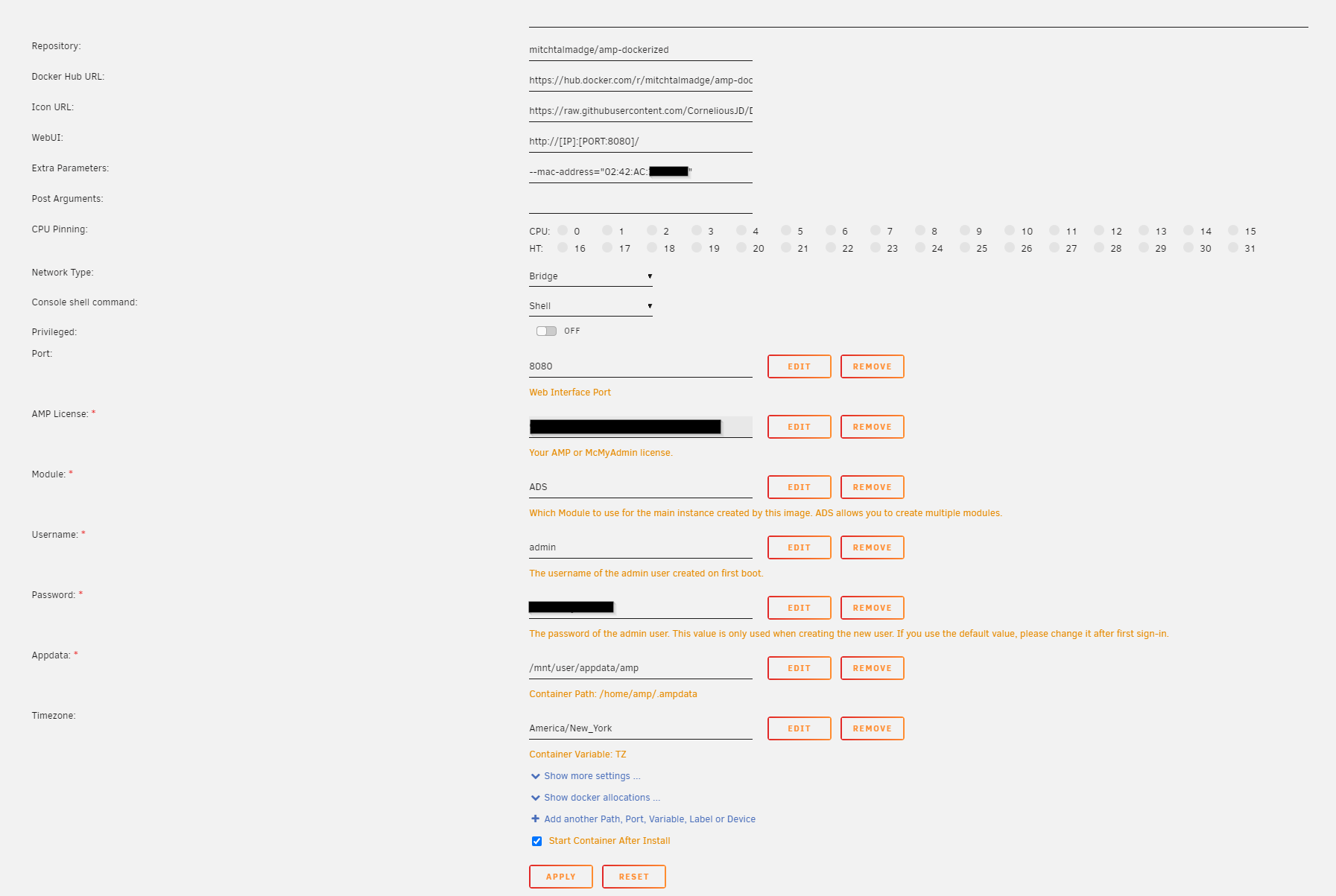

Have downloaded this docker image in to my Unradi server. adden my key. but not changed any other config to start with. I get the web interface but can`t log in. even i don`t change admin  password combo it fails.  the startup log tels me nothing new.
i usually run my AMP cluster on native ubuntu but wanna try this. it the login bug on my end or i know one. fix?
You either set your default user/password in the container itself, otherwise it will default to admin//password -- have you tried both what you entered and admin//password, and it still wont let you in?
Yes i chaged it the first time. "wrong password"
so started a new container and used the standar setting username: admin and password : password.     Still no accsess. But the amp itself are running and i can use the terminal, elevate amp and see status. and i get the website loginscreen like usual
Interesting, when you started up a new container did you delete all previouse appdata for the old AMP container?
If not, try just pointing it to a new appdata folder (e.g. /mnt/user/appdata/amp2) and try again, this will ensure a fresh data folder w/ no leftover inherited settings.

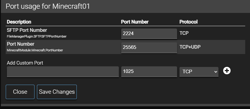

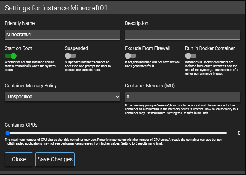

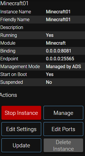

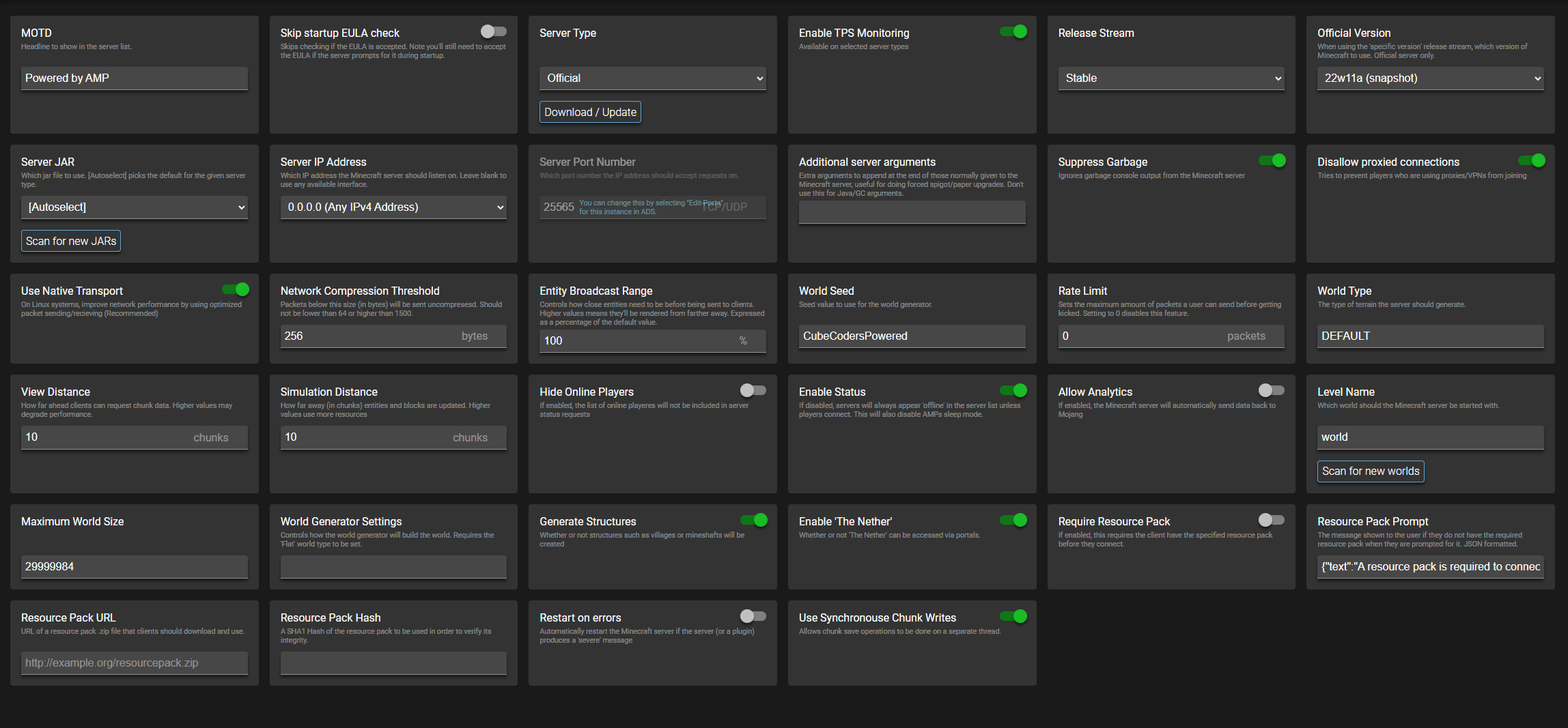

Can't seem to reach my Minecraft Java server.  I watched the youtube tutorial which was by the same gentleman who made a Valheim server video.  I've tried so many settings options and it all seems as though it would work, but my Minecraft client just doesn't see the server.
The IP of my unRAID server is 192.168.1.10.  Supposing the AMP Minecraft server default settings, shouldn't I be able to reach my server at 192.168.1.10:25565?
Any thoughts?

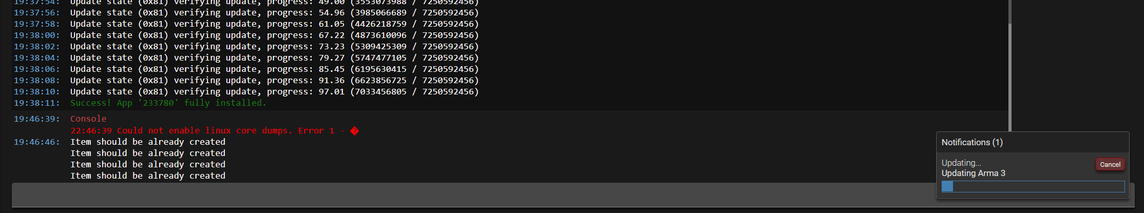

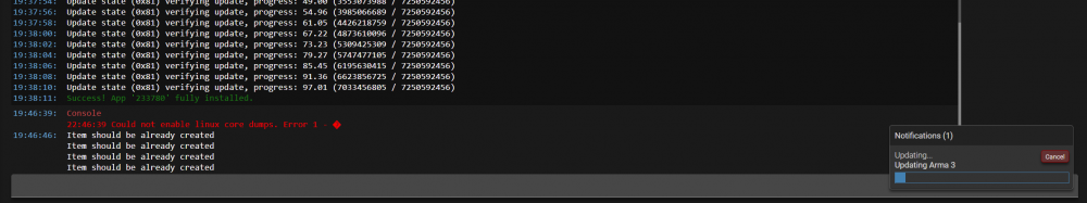

I am trying to start an Arma 3 server with the AMP docker, however everytime I try to click update/start it gives me an error and just keeps updating infinitely. Anyone know a fix to this?
Doesn't seem to be a lot of support here.  Did you by chance find your answer somewhere, and if so, where?
