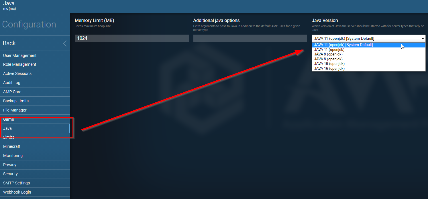

Thank you for the report! Multiple people are running into this: https://github.com/MitchTalmadge/AMP-dockerized/issues/76 It looks like it's limited to Minecraft 1.17 so I am trying to figure out why it suddenly stopped working. All other Minecraft versions seem to work fine. I'm trying to find a solution but please let me know if anyone finds anything. I appreciate any help.
[SUPPORT] AMP (Application Management Panel) - CorneliousJD Repo
Go to the Java settings in that AMP instance and try switching to Java 16
