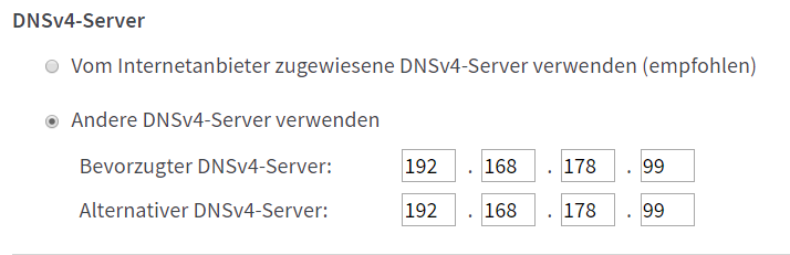

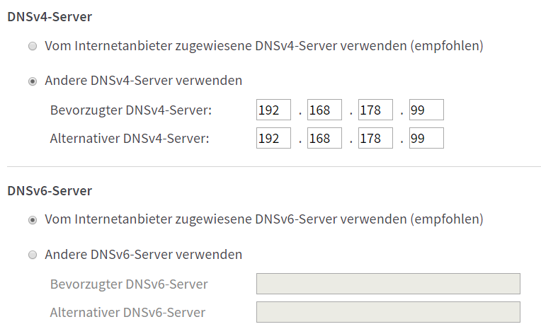

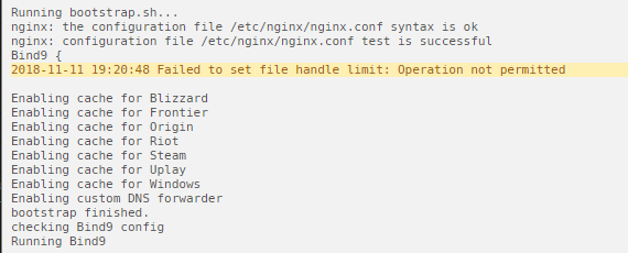

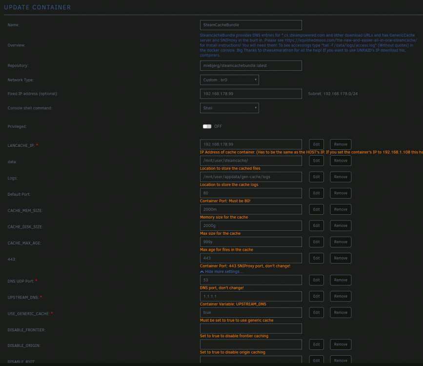

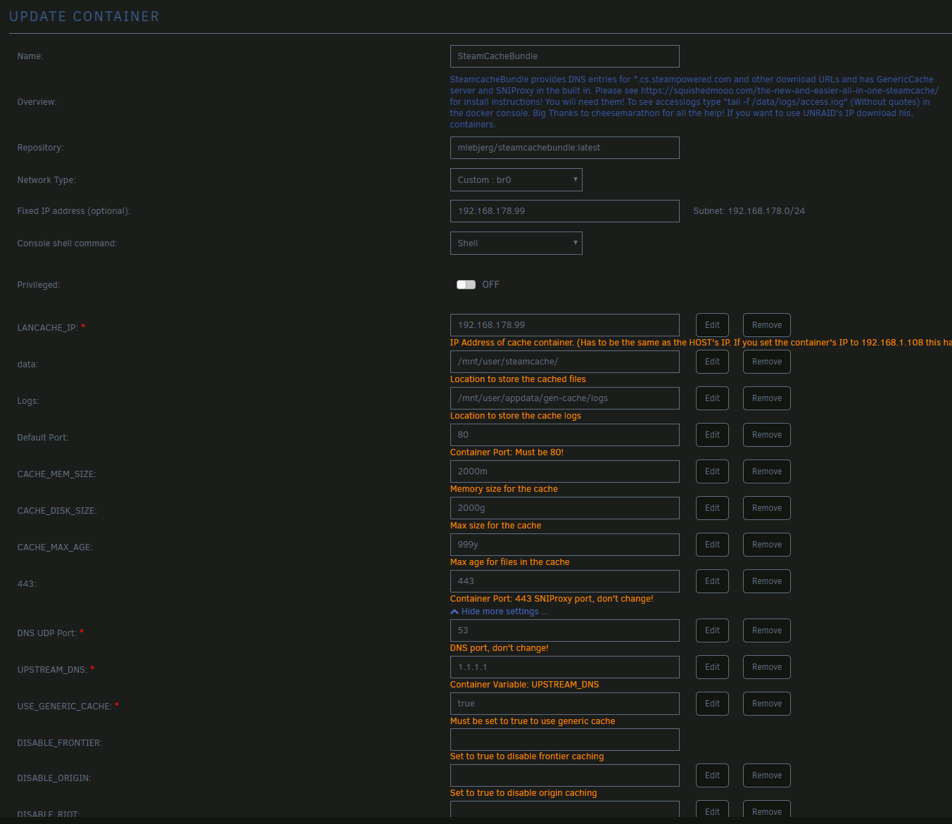

Thank you for youre answer. I´ve tested last night, what happens when i only set the DNS in my Fritzbox Router. Not in the WIndows client. When i use this, steamcache creates folders when i use battlenet. But not with Steam. But i changed yesterday a lot in my server. So i try to test it today after work and set no secondary ip adress in my router and see if this fix my problem. EDIT: hmmmmmmit´s so strange. Now it doens´t work... Settings: I reinstalled the docker container, no errors, in the powershell everything is ok. But when i downloade a game nothing happend. ALSO one strange thing is, when i turn the steamcache docker off. I can browse normaly.......but why? The DNS Server is OFFLINE......why i can browse normaly in the www? I don´t understand where is my fault? Ok.....is ther a problem if i haven´t a ipv4 adress? In Germany you only get a ds-lite tunnel. An other guy has the same problem: https://github.com/steamcache/steamcache-dns/issues/24 I think my problem is ipv6 Ohhhh i hate my internetprovider. My Internetconnection has no IPV4. And all my IPV4 requests are tunneld through IPv6.......so i have NO IPV4 requests and steamcache can´t cache anything. Is that right? And how can i change that?
