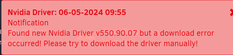

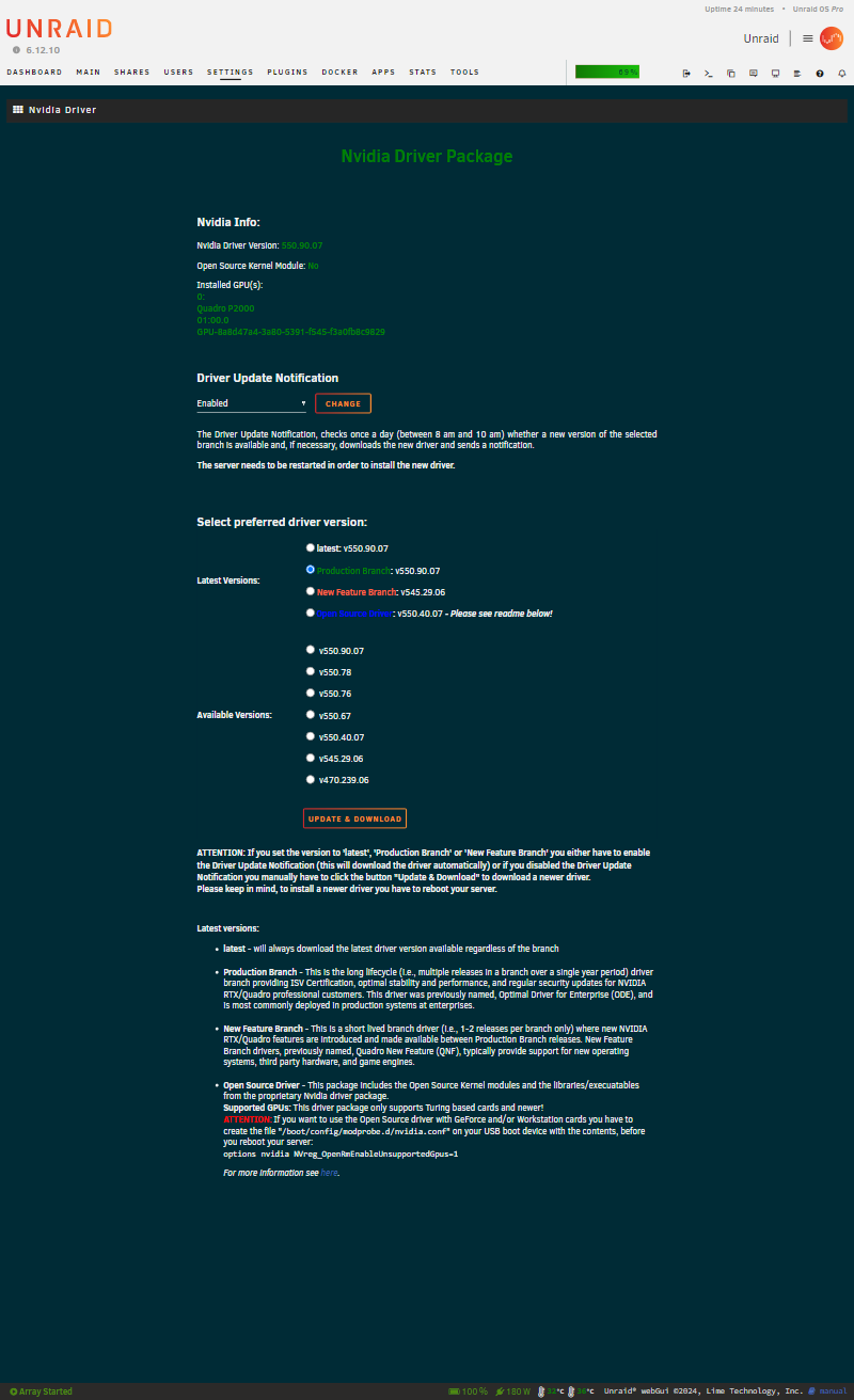

Unable to download stable release.
Im getting this error when trying to dl the latest or any release. All was working fine until last week nothing has changed. Should I manually delete the plg and try again? TIA
tower-diagnostics-20240626-0850.zip
In your screenshot I see this:
This is a indication of a corrupt installation from the Nvidia Driver plugin, to fix this do the following:
  1. Uninstall the Nvidia Driver plugin
  2. Reboot
  3. Pull a fresh copy from the Nvidia Driver plugin from the CA App
  4. Reboot (or restart the Docker service)
