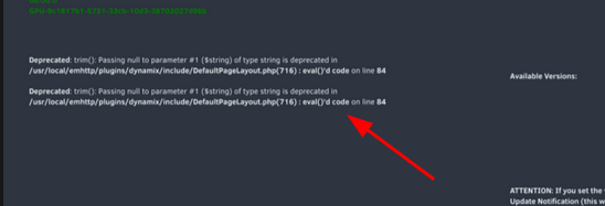

On 8/29/2024 at 10:34 AM, _JC_ said:
This is interesting! I am fairly sure I had the dashboard open (or I just tried to login) every time the server crashed. I now removed GPU statistics, re-installed the nvidia driver, and activated it in the Plex server. It has now been running fine since last evening, and today I had it hw-transcode 4 movies at the same time, with no issue (yet).
I will let it run like this (and not even logging into the Unraid UI...) to see if it is stable!
UPDATE 30/8: Server still stable with no crash, after I removed GPU statistics plugin. This is great, but would be interesting to know why?! 🤔
It is now quite safe to say that the problem was due to the GPU statistics plugin. Server still running fine, with many hw-transcodes.
What happens when you visit the plugin page (just to let you know it will also call nvidia-smi so a crash might also happen).
