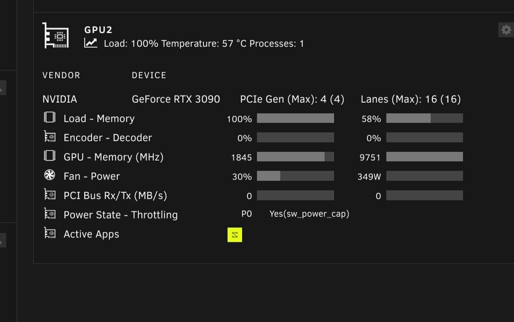

2 days on, i noticed it is now sitting idle in throttled SW POWER CAP ACTIVE, and at a higher wattage 24w. memory is sitting at 405 Mhz constant,  Occasionally, it switches to  GPU IDLE, but then back again to SW POWER CAP.
I tried disabling dockers, restarting the server, but this hasnt helped.  Any Ideas?

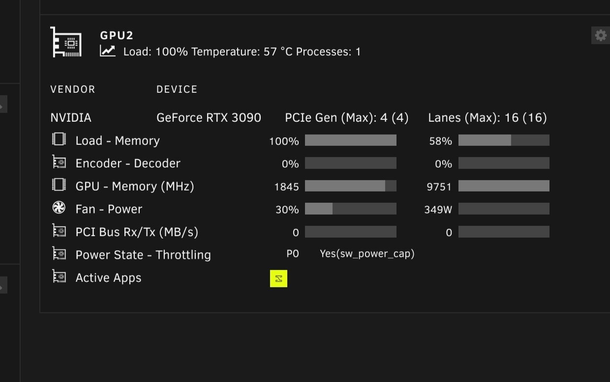

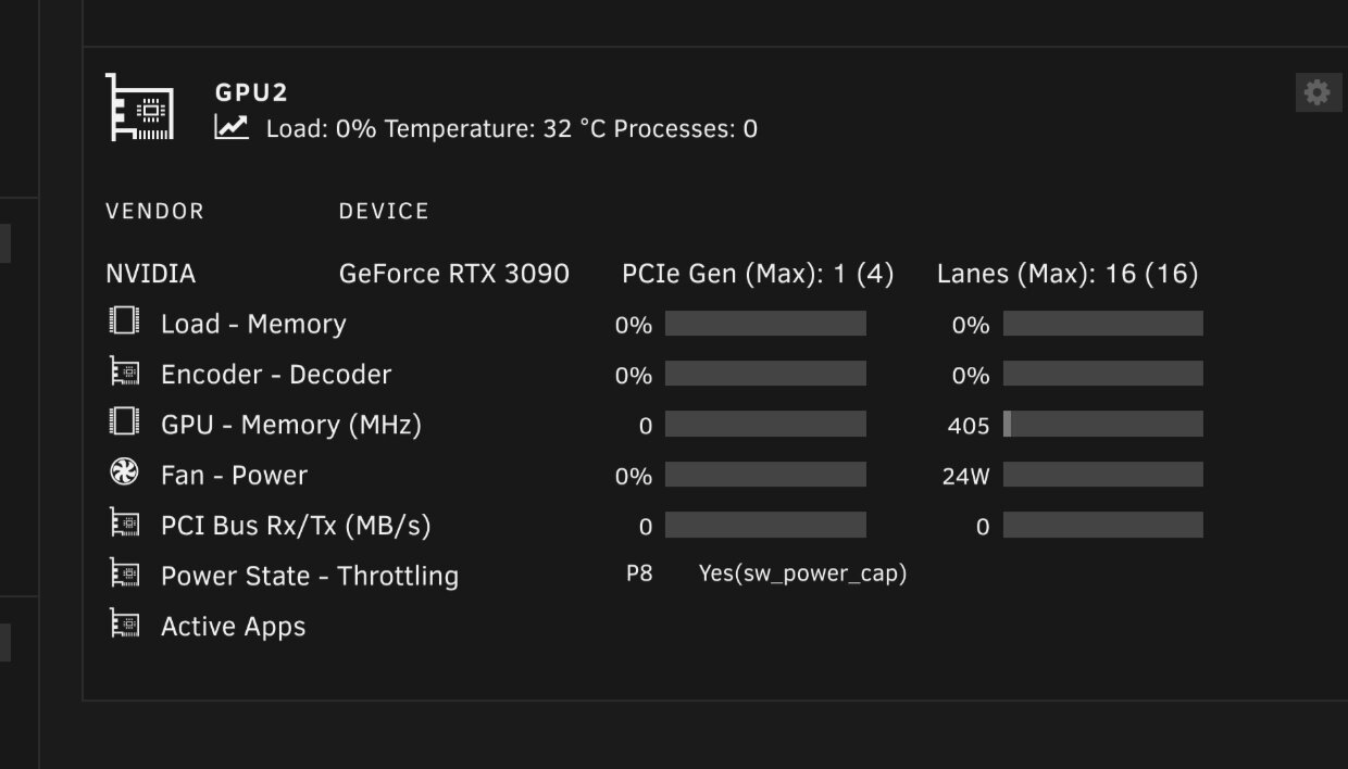

The throttled sw power cap status at idle resolves after a server reboot (gpu idle). I've spoken to another user (Pri) on the official discord who has had the same issue unresolved for a while.
At 100% load, the 3090 is in P0 (throttled: sw power cap) - see attached screenshot of GPU statistics. I have also attached a screenshot of the GPU statistics at idle with sw power cap and gigher power draw (should be 14w idle)
The gpu is connected via a type 5 cable (12pin to 8+8) to psu. I did not change anything in bios after installing the dGPU.

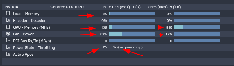

last night i noticed the fans on my GTX 1070 running (while usually it's not the case).
Today, looking at the GPU stats in the dashboard i noticed this:
Beside having fan spinning, and some load on memory, the power state says "P5" and the the card being throttling.
As you can see, nothing is using it.

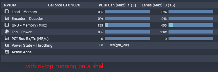

If i run nvtop everything goes back as it should be:
BUT, still says GPU is throttling.
This is what nvtop shows:
As i close nvtop, the card goes back to the previous state (as in 1st image).

23 minutes ago, dhstsw said:
I tried to uninstall drivers, reboot, reinstall drivers, reboot - but nothing changes.
I assume this card was working before without any issues correct?
Please issue:
nvidia-persistenced
from the command line, wait a few minutes and see if it drops down to P8
Have you yet tried installing a driver lower than version 560?
Yes, perfectly.
Please issue:
nvidia-persistenced
With the command everything goes as it should be.
How can i have it issued (with a script i guess) but, also, why this now? :-/ Any idea?
