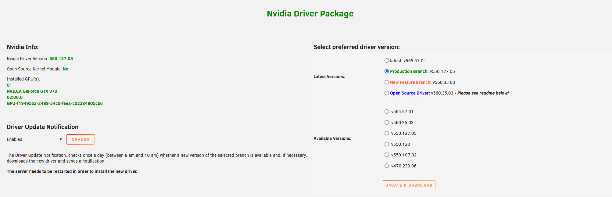

EDIT: Updated to 6.12.13, Nvidia_Driver plugin installed successfully. Now when I install the driver itself, it hags on the Downloading Package screen. image.thumb.png.3309b1cfc2dbf31d7f38e936178cb618.png
GPU Stats sees the GTX 1060 but the Nvidia Driver plugin won't install the driver.
Edited by nightwing
Are you really sure that it hangs since it will take quite some time to download the driver package (200MB from GitHub).
You have to be patient, GitHub can be quite slow at times.
What happens when you click Update & Download?
It will show the downloading driver package screen like the screenshot above shows. However, it has been an hour and it is still not completed. I'm trying to run through the list of things that might be wrong like USB boot failing, SSD failing, network issue etc.
EDIT: Just got a error that I can't download the driver:
Edited by nightwing
May I ask where are you located in the world? If you are located in China you should use a proxy otherwise downloads from GitHub will most likely fail.
Please note that sometimes GitHub can be really slow in terms of package downloads, can you download these files: Click & Click
The above files are actually what the Plugin tries to download, however you can click on the download button again and the Plugin tries to re-download the file.

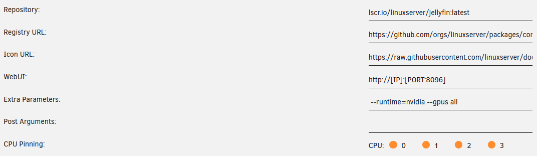

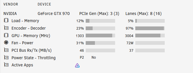

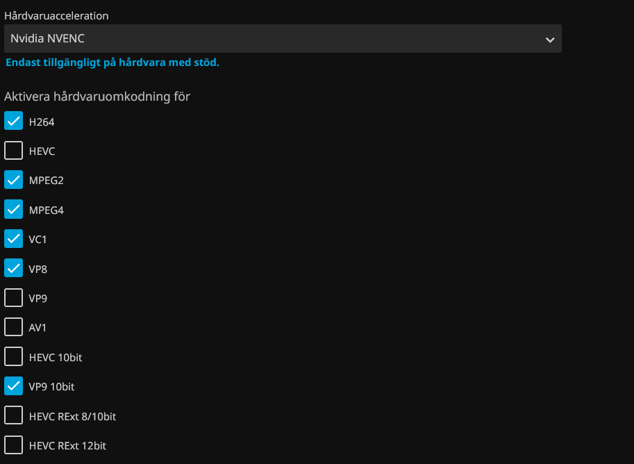

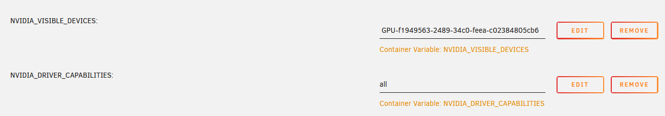

Is there a good reason as to why the hardware acceleration isn't working?
The id is correct.
tower-diagnostics-20241103-1106.zip
When playing a h.264 1080p clip on my chromecast:
Edited by papaHoff

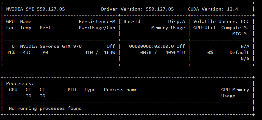

It is indeed working from what I can see from your screenshots.
GPU Statistsics is also picking up that Jellyfin is using your card…
Please issue issue this command from a Unraid terminal: ‚watch nvidia-smi‘
(press CTRL+C if you want to end watching nvidia-smi)
What is the exact issue that you are experiencing? Is the playback not working?

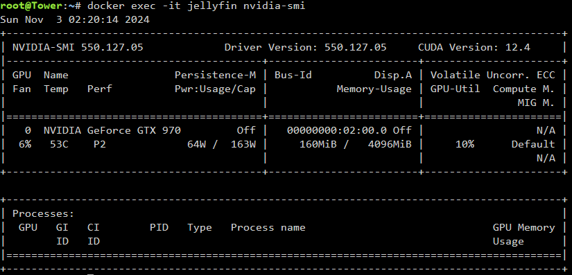

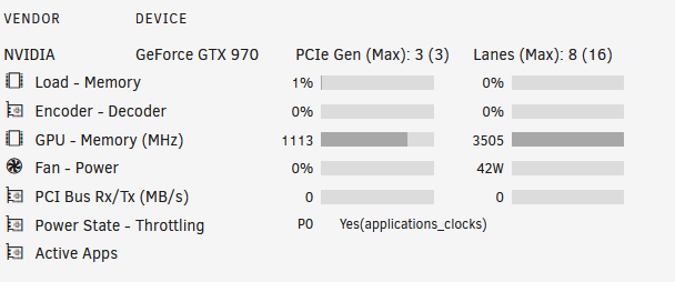

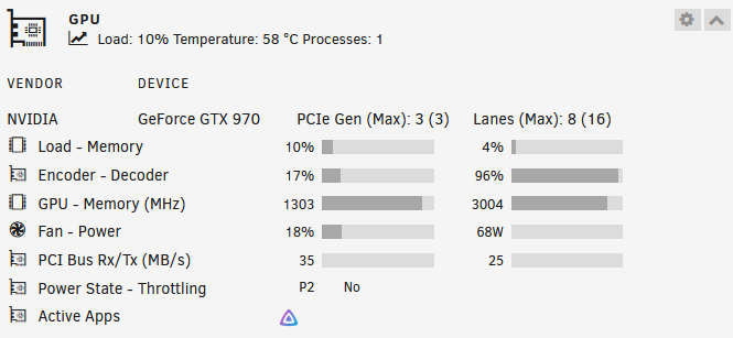

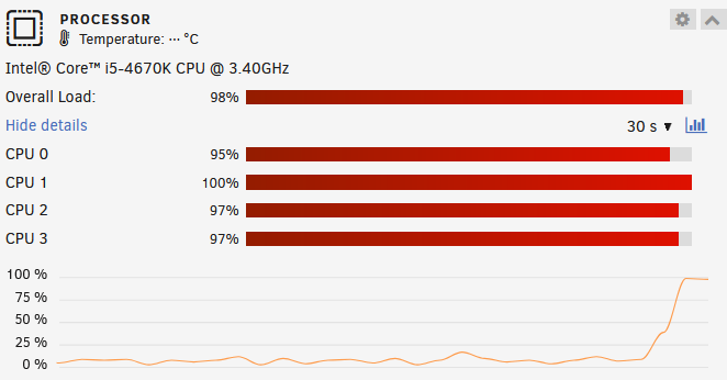

Well, the most common error i see is that the CPU gets overloaded and all cores go to 100% and stays there. Sometimes even unraid and all docker-images get unresponsive and the only solution is to kill the server by holding the powerbutton. Supposedly i believe that could damage the OS in the longrun.
I suppose this could might as well be an issue with the docker for jellyfin doing something, but

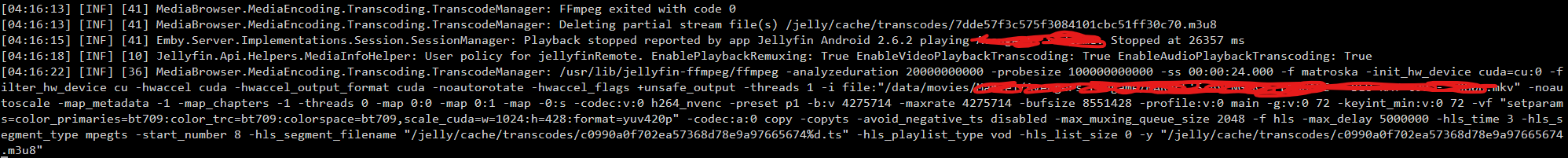

Playback on phone:
Playback on chromecast:
At this point, just as you pointed out, the gpu-statistics plugin notices that the GPU is being used, and something is clearly happening on the jellyfin-side, since the log prompts this:
The attempt was made with several variations of all encoded movies using H.264, NVEnc (using HandBrake). I also waited for 10 minutes, but the process information never gets populated. Even when they presumably use the GPU, since the stats of the GPU raises.
Right now, doing playback to the TV:
But still the same from nvidia-smi.
TMI; but makes me feel like this all the time, cause i gotta kill the server, which i suppose could be from it trying to do everything on the CPU instead:
