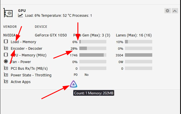

I think I got everything in. but it won't work. Can you see anything??
And I restarted jellyfin and the server.
Why is jellyfin active app inte the gpu and do nothing ?
Edited by lacariuz
or is it decoding now? :/ Not sure what to watch.
It is indeed decoding, these indicators show that Jellyfin is using the GPU and a the bars on top you can see that it has some work to do:
You just have to make sure that you force a transcode that it will actually start transcoding, please also don't forget that the load on the CPU is probably the audio that needs to be transcoded too.
