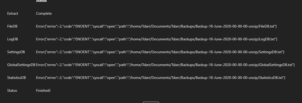

  7. Thank you, the problem ended up being that the folder was zipped up one folder higher than required. After reloading the backup my original problem returned, but after doing the database clear and reverting from backup again it worked!
  8. Hey guys, I asked about an issue I had a bit ago. The suggested fix was to clear the database and that does seem to have fixed my initial issue, however I am now having trouble restoring from my backup. This is the first time I have needed to restore from a backup, so it's possible I am missing a step. I tried both containers, tdarr and tdarr_aio. tdarr_aio saves its backups as unzipped folders, but tdarr saves its backups as zipped folders? Zipping the folder from my tdarr_aio backup was the only way I could get the file to show up in the backup list.
