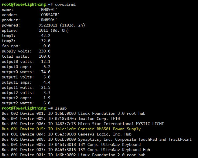

  11. One more question and one more quirk... It seems after a while that the RM850i disappear after a few minutes and only comes back after a reboot of the Server. I will try and dig more to find out why. Second question, not a quirk. Will you perhaps be working on an update to set certain parameters in the PSU, like the fan, when to switch on or even manually, etc...? I have found in the past, running the Windows version of my setup that you could turn the fan on or increase speed according the temperature of the CPU or the likes... Just asking, many thanks.
  12. Hi there, okay, after seeing or rather not seeing the PSU, I swpapped the internal connector from USB1 to USB2 and whala, it seems to work now. Here is the ourput just for fun. Thanks for the help...

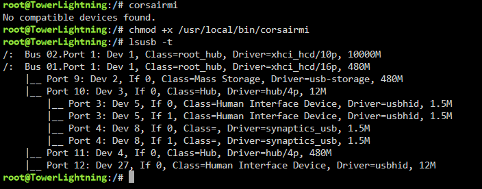

  13. Hi there, okay, tried default, still the same. Read some of the earlier posts and it seems my system doesn't see the PSU, I think... have a look at this screenshot please. I have the link cable (USB) plugged directly into one of the Motherboard USB ports (This used to work with the QUE software, so doesn't make sense, unless a driver issue on Unraid perhaps?)

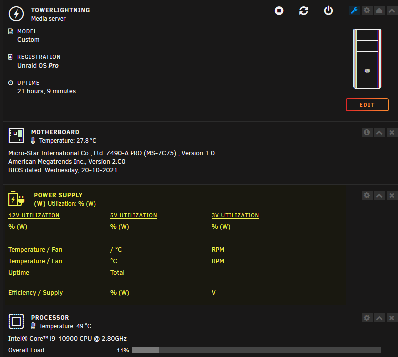

  14. Hi there, thank you, yes, this time it installed, but still no stats coming from it, here is a screenshot:

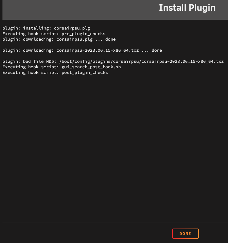

  15. Hi there, just tried again to install and this is what is shown and no, it is not installing from he APPS screenshot! BTW, and sorry for my ignorance, but what is "my version" compared to "is version"?
  16. Hi guys, I have a n RM-850i, which worked with the CUE software before I turned this into an unRaid NAS. I am running Unraid 6.12.3. I could not install the app from the community location as in the log it says: "plugin: bad file MD5: /boot/config/plugins/corsairpsu/corsairpsu-2023.06.15-x86_64.txz" I then used the manual install from "https://raw.githubusercontent.com/Cyanlabs/corsairpsu-unraid/master/corsairpsu.plg" which installed as a plugin. My problem now is that it messes up the dashboard a little and does not seem to display any information from the PSU. I checked the cables and the USB cable is plugged into the Motherboard as before. Do I need to specify the USB port number? It says it is not needed for the RM850i or am I missing something? Any help of advice will be welcome, thank you!
