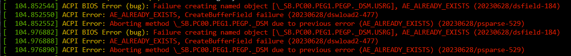

  5. Hi there. I am using latest Unraid 7.0.0-rc.1 and have an ASUS PRIME Z790M-PLUS motherboard with a nvidia RTX 4060Ti 16Gb installed. If i install the latest nvidia driver through this plugin i get the following dmesg error output: Since ASUS does not offer any support for Linux Distros, i was wondering if this is a driver problem and can be fixed through an upcoming update. I also have the problem, that in the moment i plug in any nvidia GPU into my motherboard (regardless of i installed the nvidia driver plugin or not), my system is not able to reach higher c-states than C3 anymore. If i remove the nvidia card i reach C10 again. Does someone else experience this and is there any workaround? Thanks in advance and kind regards
