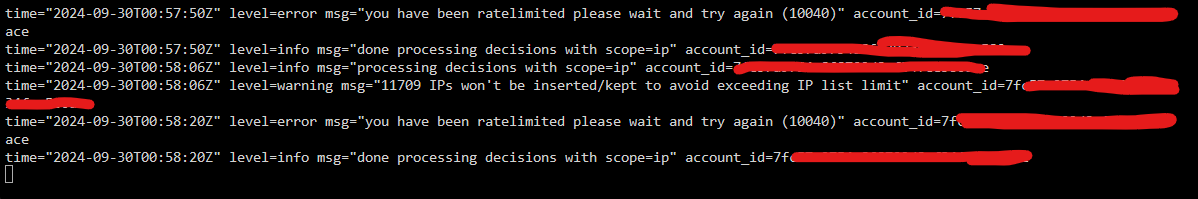

I think i need to reopen the topic.

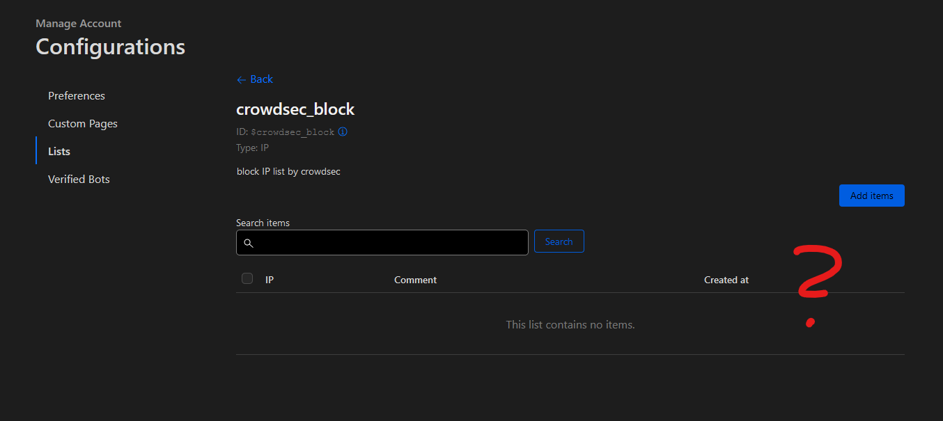

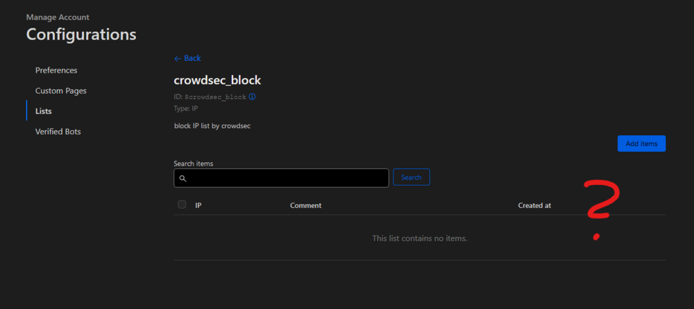

Seems like the Crowdsec-Cloudflare-Bouncer logs look well and the rule-set in Cloudflare is also created by the bouncer, but the crowdsec block-list is not filled with ips.

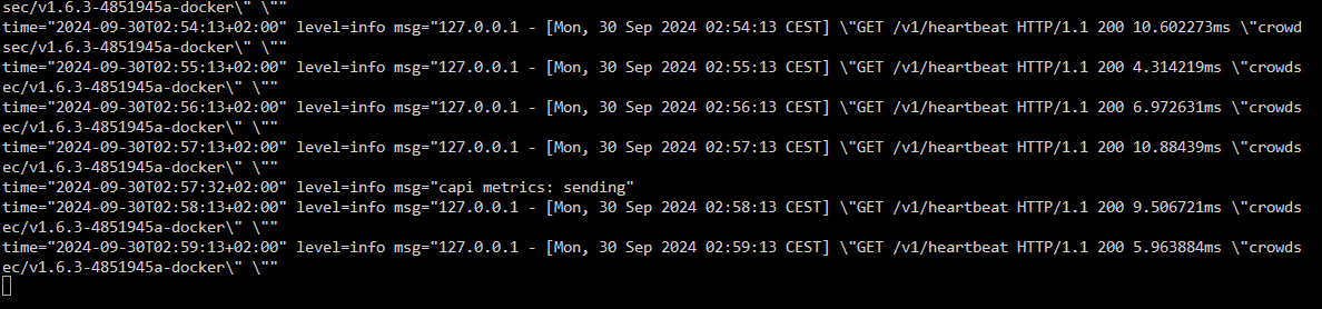

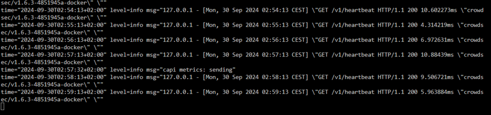

Even if i manually add ips to crowdsec with <cscli decisions add --ip 109.40.xxx.xx --duration 4h --reason "Test block"> and the ip is shown in the Crowdsec Dashboard, it will not be uploaded to the cloudflare list. Can anoyne maybe support here?
Bouncer Log:
Crowdsec Log:
