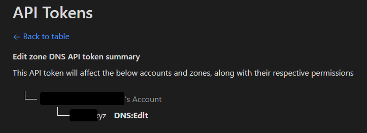

Hi @Kilrah, thank you for posting an example of your config file.
I'm seeing the following error message repeatedly in the container's log, when I try to build my config file based on yours. Obviously, I used my own api-token and zone address.
For the sake of privacy I change the actual zone address in the log error quote to "********.com".
😡 Error sending 'GET' request to 'https://api.cloudflare.com/client/v4/zones/********.com':
{"result":null,"success":false,"errors":[{"code":7003,"message":"Could not route to /client/v4/zones/********.com, perhaps your object identifier is invalid?"}],"messages":[]}
Do you have any idea why this error is happening?
I do get some occaisional Service Unavailable and other 404 and errors in the logs, seems the CF service isn't extremely reliable...
See if it gets better with time. Of courrse check your zone id/token and that the token has the correct permissions on the zone.
I've double checked my zone_id and the api_token password and they are correct.
Are these the correct token permissions I should set?
Zone Settings:Read, Zone:Read, DNS:Edit
I've made 3 tokens that only have the DNS Edit, one for each zone:
