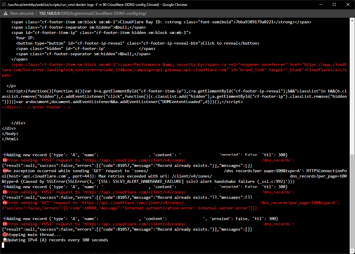

I've always had some of those as well, doesn't seem to cause a problem.
Seems the cloudflare API sometimes times out while the container tries to get the existing records so it then tries to add some that are already there.

I always see either timeouts, HTML from an error page, handshake failures, internal server errors, retries exceeded etc on the lines before when it happens.
It's not that frequent (hasn't been one since last container start a day ago) but happens somewhat regularly.
