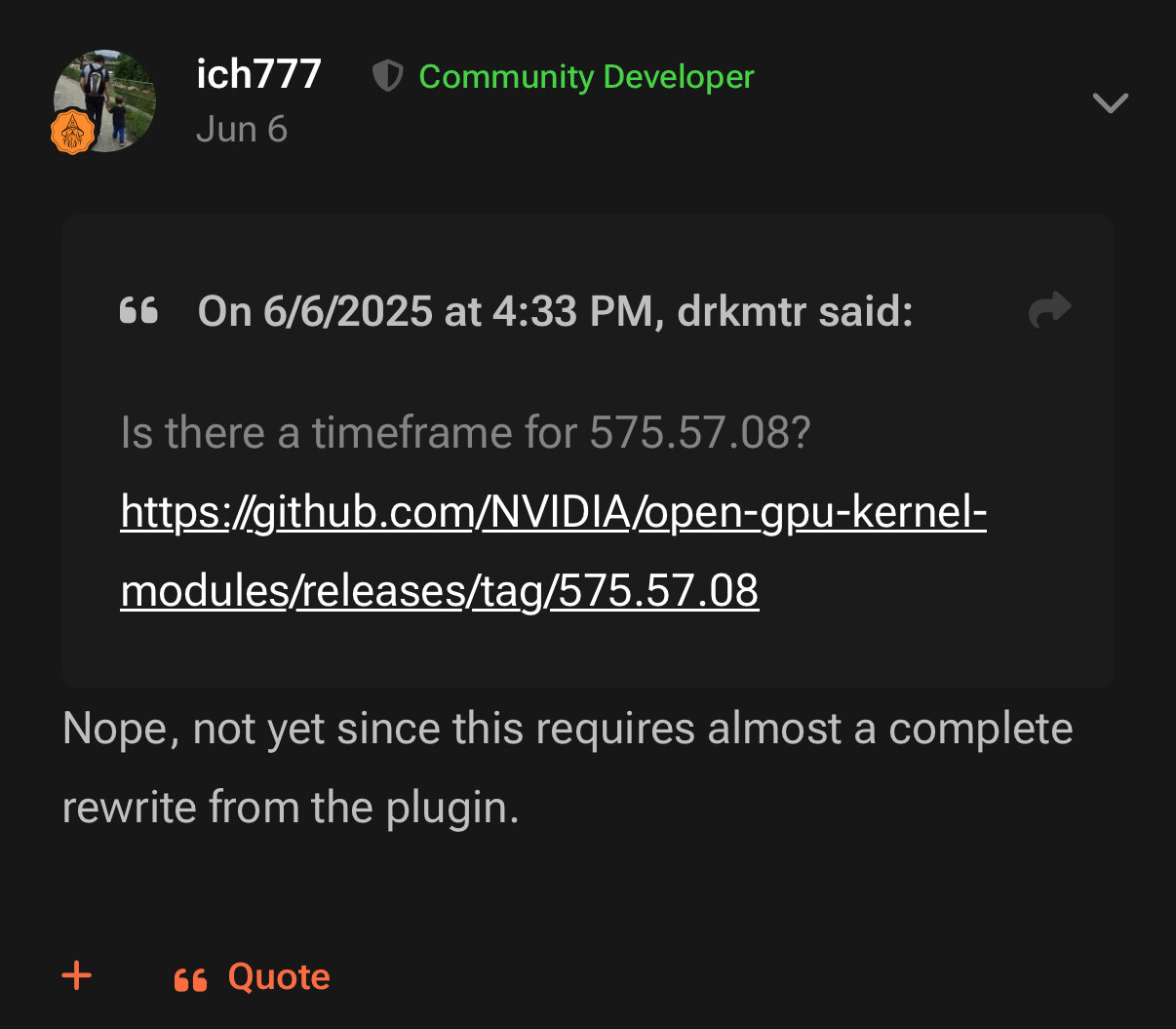

On 6/6/2025 at 5:14 PM, ich777 said:
Nope, not yet since this requires almost a complete rewrite from the plugin.

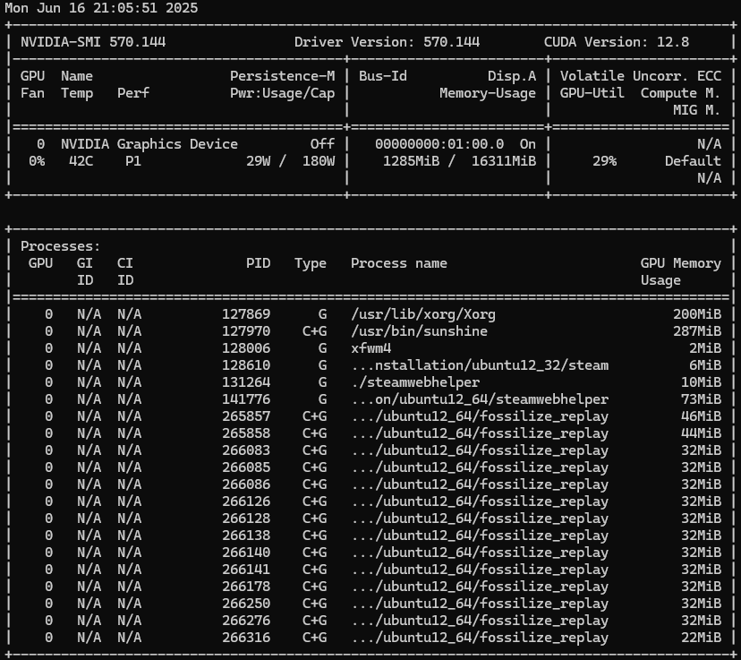

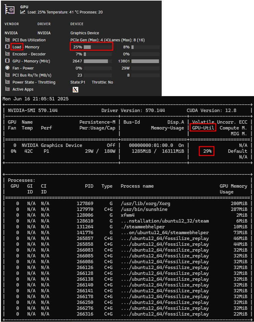

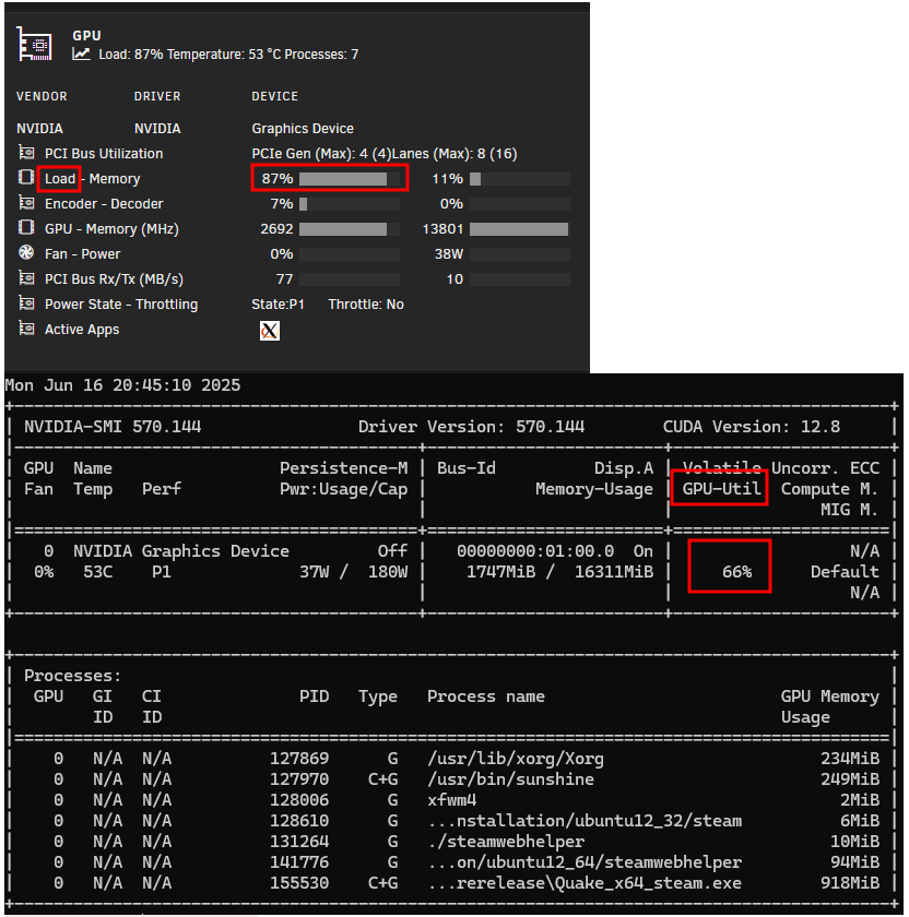

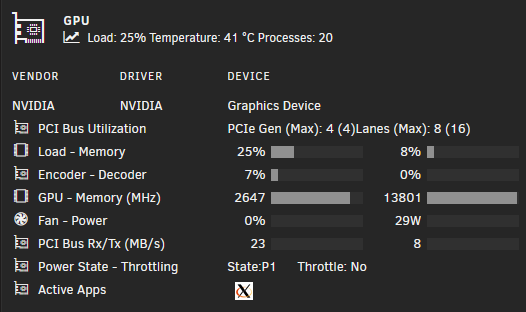

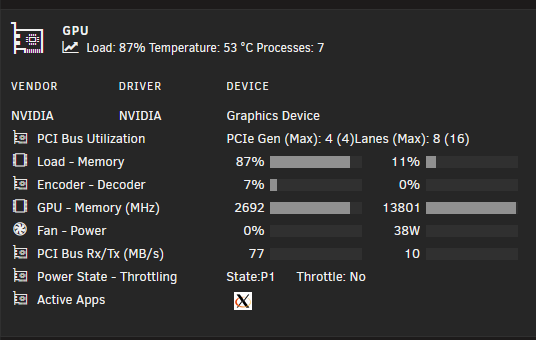

On 6/14/2025 at 7:14 PM, anticholium said:
I just concluded because of this comment (see below), but was asking in my last post if I got right. Obviously no...
I'm on Unraid 7.1.3, using the latest Opensource Nvidia Driver (MSI Geforce RTX 5060Ti), latest Steam Headless Container and I'm trying to fire up some more up to date gameing titles and was hoping to streamline them with Sunshine/Moonlight to the more weak laptops of my son. Sadly, despite the quite powerful GPU, I simply can achieve just around 8-10fps even for older games like Counter Strike 2; hardware acceleration is enabled, the container is using the GPU (nvtop, nvidia-smi)... In other use cases like Handbrake video transcoding (NVENC AV1, 10bit, 30fps, CQ30) it works very well, for LLM-based text-toaudiobook-"conversion" it works pretty well too. So my thoghts were, that the current open source driver might only be partyl supporting the quite actual GPU gen? Do you know, when there might be a change in this? I will perform a diagnostics when using the scenario as described and will attach the zip, if that might be helpful. Thank you so much!
Strange observations: when starting/playing a game via Steam Headless container, GPU Statistics shows the GPU and VRAM load etc, which is quite substantial even for very old titles, but nvidia-smi shows 0%! Which one is true? Official Nvidia driver download section states 5060 Ti support only for 570.153.02, not for 570.144, maybe the reason for generic „NVIDIA graphics device“ (and not the specific model) in Unraid?
Sorry but this is the Nvidia Driver support thread and not for GPU Statistics, please report that in the GPU Statistics plugin support thread since this might be an issue with GPU Statistics which pulls the data actually from nvidia-smi
You still haven't posted your Diagnostics or did you?
It would be very interesting to see your syslog alongside with other information about your system and of course which Unraid version that you are running, I really can't help without you providing the requested information.

Yeah, I'm aware, what this support forum is for, sorry for the inconvenience, I just wanted to demonstrate, that appeared very strange to me, that GPU-statistics is showing some GPU load etc produced by X Window System/Sunshine, and at the same time, I thought nvidia-smi is showing 0% load/activty despite some specific processes which are linked to the steam headless container... but I was mistaken, sorry. - The screenshots are 1-2s apart. - Please see my diagnostics attached, first while running oldy FPS Quake I, second while (trying) to run Counter Strike 2 (which should theoretically be around 200-300fps, but is 7-10fps). I'm thankful for any hint/advise. Thx!
diagnostics-20250616-2040.zip
diagnostics-20250616-2059.zip
Edited by anticholium

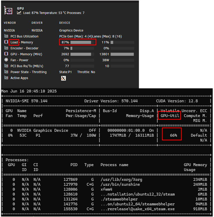

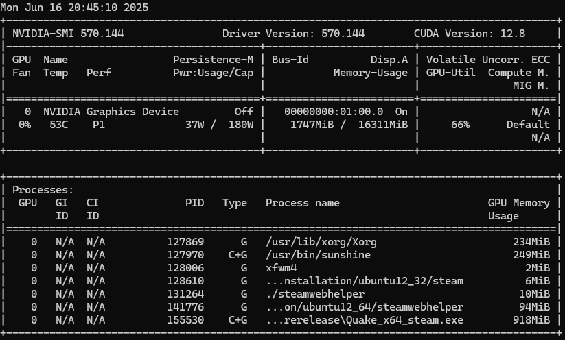

In both of your screenshots I see utilisation which doesn't match, probably because of the difference where the data was queried but you'll at least see it:

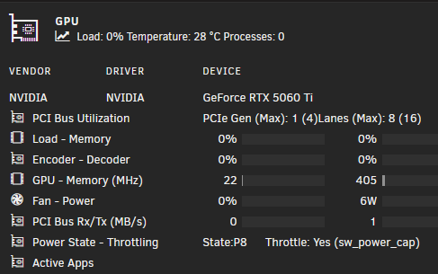

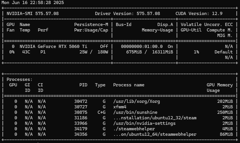

I just triggered a build for the latest New Feature Branch for Unraid 7.1.3 which is Nvidia Driver version 575.57.08, the build should be done in about 5 minutes, however to get the build you must visit the driver page and it should show a new driver version at the Open Source Branch and then you have to click Download & Install again to get the new driver, after the download finished you have to reboot.
Awesome!! Thank you so much! Right now, no more "generic" Nvidia Graphics Device but: NVIDIA GeForce RTX 5060 Ti. And: Counter Strike 2 before (as already mentioned, sorry) 7-10fps, right now: 60fps (capped by configs), low GPU load, everything is fine now. Let's see which other changes also come together with this

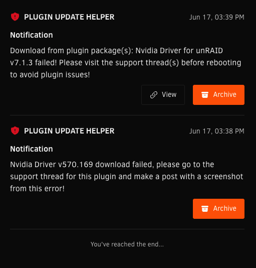

attempting to update to 7.1.3 and the driver helper had a issue getting this driver
Nvidia Driver v570.169 download failed
What network equipment are you using? Are you using Unifi gear?
Do you have enough free space on your usb boot device?
It should be safe to reboot since the Driver plugin tries to download the new version on boot if no compatible version is found, the boot time will be a bit longer since the drivers are abour 300MB in size.
