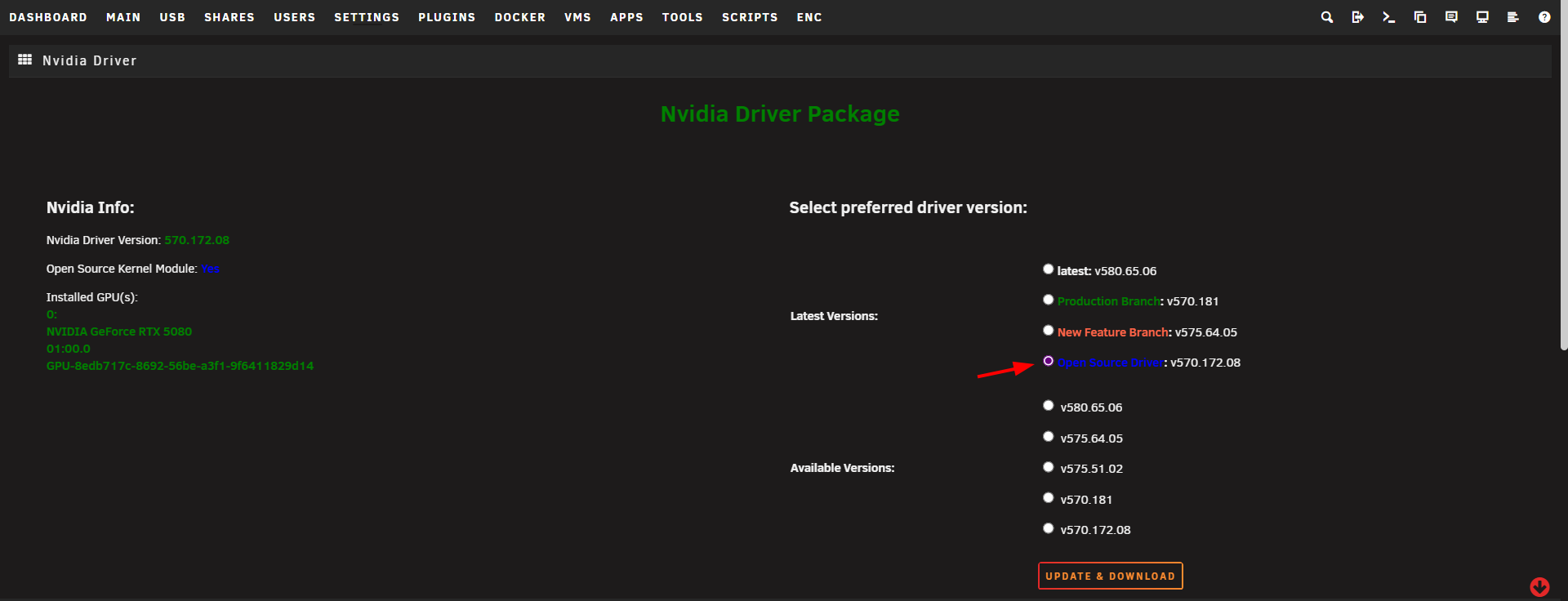

41 minutes ago, micka said:
Could it be related to this driver version ?
I don‘t think so because otherwise more users would report that issue.
About 10 users reported issues from about 8k downloads so I assume this is a hardware incompatibility or another hardware related issue for these users.
The thing is i keep finding issues related to this with no fix whatsoever , if someone was able to make it work they would probably tell us at some point no ?
I found this reddit as well : https://www.reddit.com/r/unRAID/comments/1k69ufy/rtx_50_series_cards_and_unraid_issues/?tl=fr
Because i can install the open blob driver successfully, nvidia-smi will work, but as soon as i'm trying to use GSP related features ( such as encoding, decoding etc ... ) the GPU won't work.
8k downloads on the open blob driver ?
Were you able to try the open blob driver ?

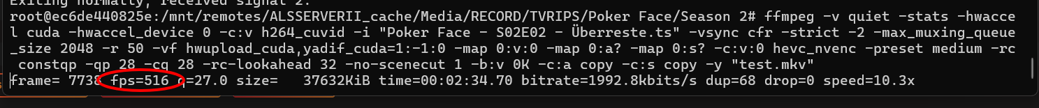

im using this driver
and can confirm, ffmpeg decode, encode works fine here ...
also paathrough to VM works fine which doesnt belong to this driver plugin now, just to confirm, all fine here at least ...

2 minutes ago, micka said:
The driver version differ from what i got, i'm using the 575.57.08 :
I assume you are not on Unraid 7.2 beta series correct?
im using it always here ... so basically never had any issues here, same before, same now with my 5080 since beginning june
sample from encode, pretty fast also ...
No but i can try it, i was wondering if the new linux kernel would help ( or if the nvidia plugin was any different in that Unraid version )
I think the plugin suggests the version based on your GPU and since the RTX 5080 was released before the 5060 i think it's normal behaviour (don't know why i got the same version for the 1660 TI though).
The thing is i got an RTX 5080 i could put in but i got to get it out of my rig and it would be complicated ( not a regular PC case ) so i'd rather solve it without testing it ^^"
The same driver as @alturismo appear as closed blob to me but it's working properly
No.
The closed source driver branch will not work with 50 series cards, if you are using a 50series card then you have to use the open source branch.
Your 1660Ti won‘t work with the open source branch, only the proprietary driver will work with the 1660Ti since it’s Pascal based.
