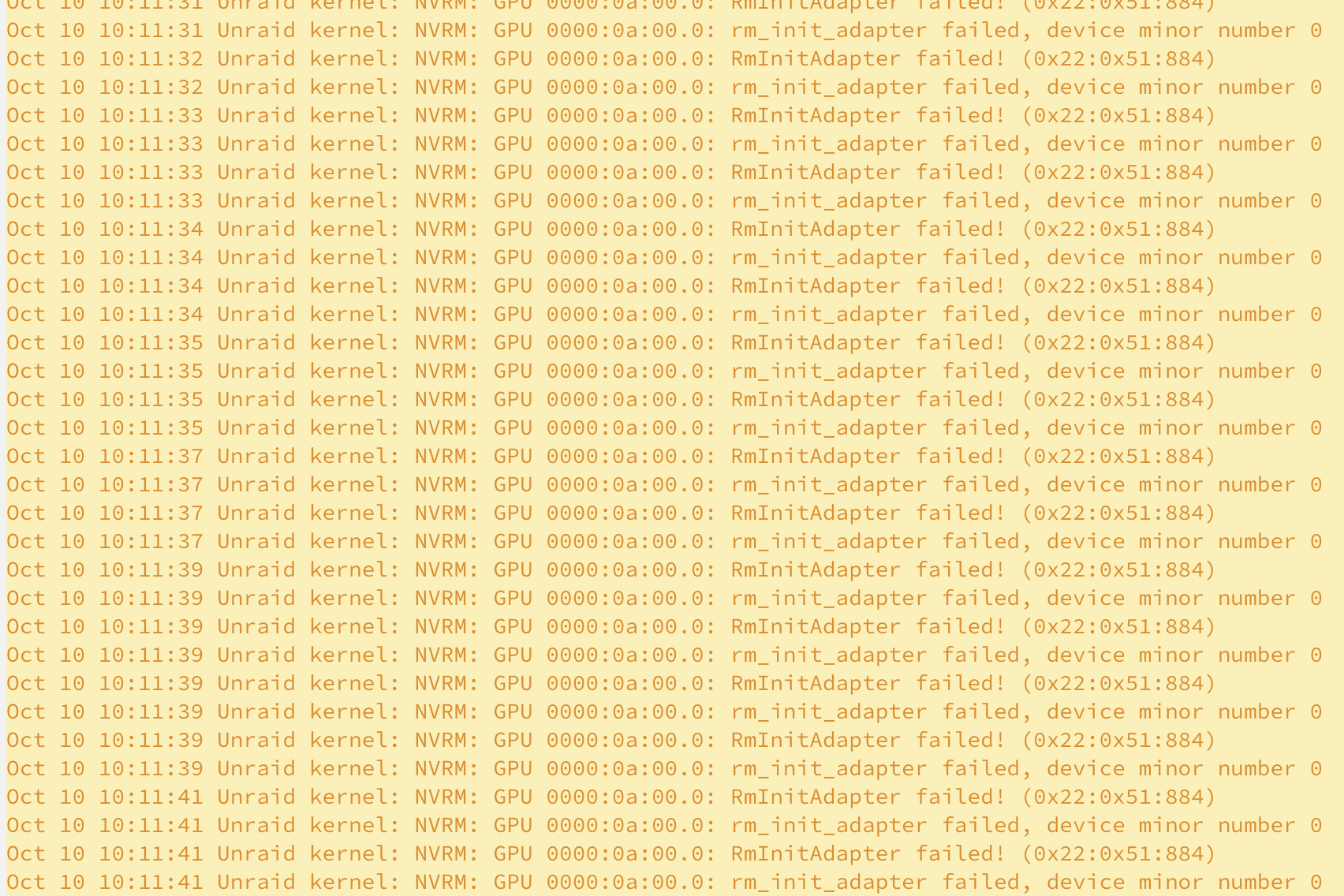

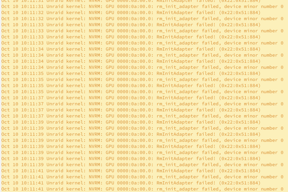

Hello @ich777
I followed your instructions — my BIOS is now up to date, but the problem is still there :(
Just to recap, I’ve already done the following:
I replaced the GPU
  • I tested different Nvidia driver versions
  • I changed the PCIe slot
  • I uninstalled the GPU Statistics plugin
  • I uninstalled the Nvidia plugin, rebooted the server, and reinstalled it
  • I disabled pcie_aspm
unraid-diagnostics-20251010-1012.zip
And I found the secondary issue with the flood of SSH messages.
It was caused by my Home Assistant and the Unraid module ^^
Thx in advance !!
Edited by thymon
Do you need this:
vfio_iommu_type1.allow_unsafe_interrupts=1
I really can't help anymore since this seems like some kind of Hardware incompatibility issue.
You can try to create a post on the Nvidia Developer forums and see if someone can help there, or if you are willing to upgrade, you can try the newest public Beta from Unraid, this should be also stable and you usually don't have to worry about your date and even if you are not satisfied, it should be easy for you to downgrade to the latest Stable version from Unraid.

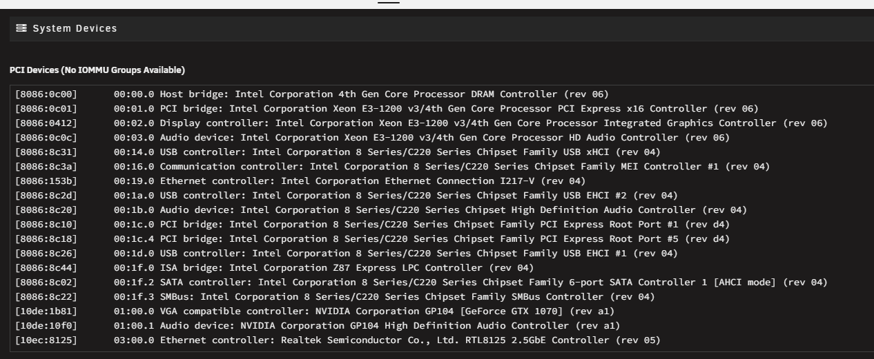

Hi Im having a little trouble changing my GPU
I first installed with a 1070 but decided to change and put a 2070 super instead
unraid still shows a 1070 not a 2070 and it shows not detected
I have tried to uninstall the plugin and reinstall
any ideas ?
vortex-server-diagnostics-20251019-1134.zip
Edited by vortex690
I think the question would be better be suited in the General or Hardware sub forums since this seems like a Hardware issue, your Card isn't simply detected by the system and this has nothing to do with the Nvidia Driver Plugin and I also don't think with Unraid in general.
Since it seems this is a prebuilt system are you sure that it can handle two GPUs at the same time?

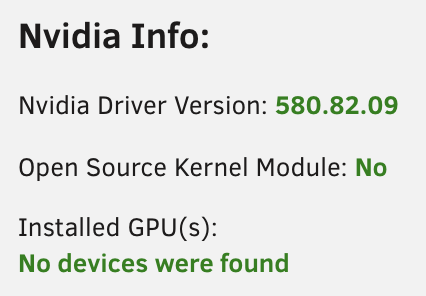

thanks for the reply
The thing is im using the card right now to navigate the GUI and its working fine
It was running this card on windows before moving to unraid
So i thought maybe i had to change something
I just placed the 1050 ti back in and its still showing 0 gpu installed
Im only running 1 GPU

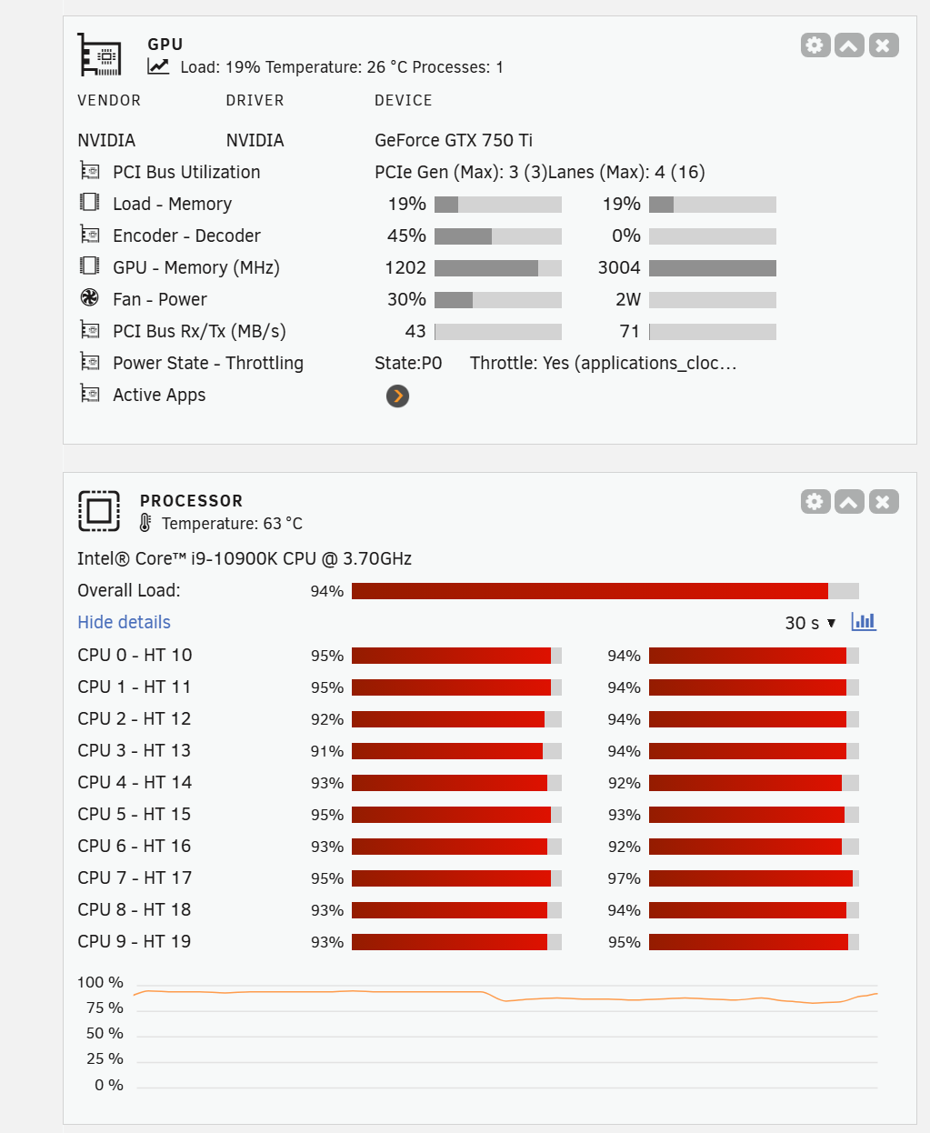

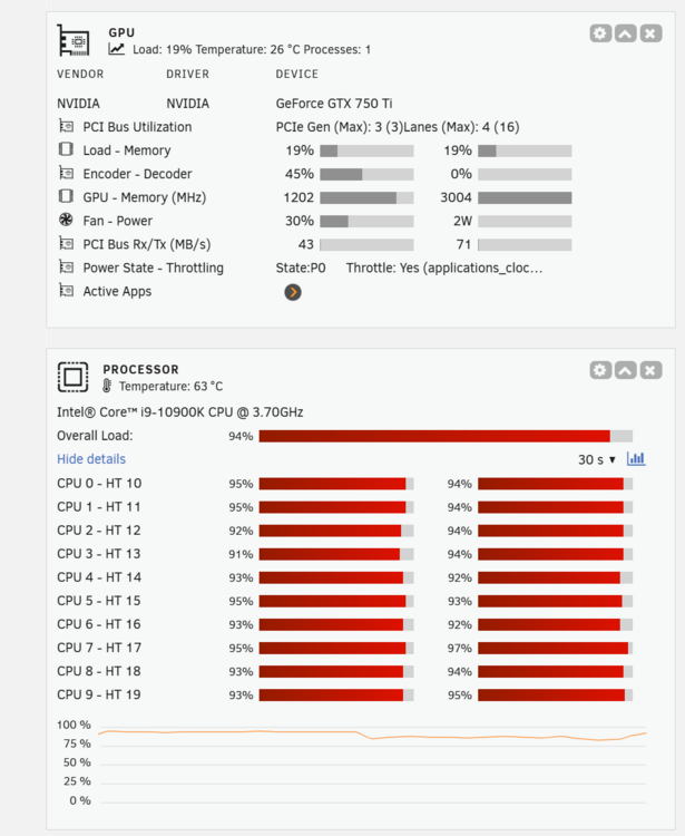

Hi
Can I have some advice. My CPU seems to be working very hard.
I had assumed the hardware transcoding would put the strain onto the GPU.
I appreciate its not a good GPU, this was a functional proof test prior to buying a Arc A380 GPU today (also dependent on whether I can get Intel IGPU working in unraid).
Anyhow the transcode quality is set to automatic, x264 background transcoding to very fast. GTX 750ti selected and its my only transcode.
When I look at NVidia Encode Decode support matrix, the 750ti supports H264 encoding (45% on stats) but it does not support 265 decoding (0% on stats). Is this the reason the CPU is working so hard playing back the movie?
Please forgive my limited knowledge - it just looks like the GPU is slacking.
I just want to confirm I have indeed set it up correctly.
Cheers Chris
Edited by SmokeyColes
It looks like your GPU is transocding like it should, however I would recommend that you replace the GPU ASAP since the legacy driver, which this GPU requires, is not supported by Nvidia anymore, at least it seems like because it doesn't compile against newer Kernel which the next Unraid version will probably use.
The reason why your CPU is working so hard is probably because it has to transcode the Audio stream (please see your screenshot) and Audio is transcoded in one go.
Another reason could be that you have burnt in subtitles into the Video stream, this stresses the CPU alot.

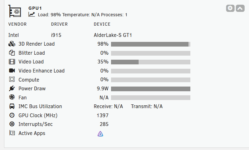

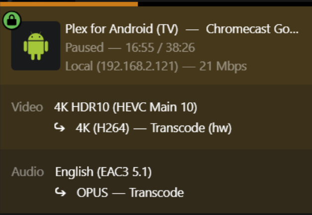

Hi guys,
I need a quick sanity check regarding the transcoding utilization of the iGPU 770 in my i7-12700. Jellyfin Docker with passed through dev/dri. The file is 4K HEVC Dolby Vision Profile 5. I am streaming to my mobile phone via WLAN. Jellyfin says transcoding with 89fps, to 42Mbps MP4 H264 AAC . GPU stats in the Dashboard show the picture below. 3D Render Load 98% what the heck? Shouldnt I be able to transcode a couple of those 4K streams without an issue ? I would have expected maybe 10-20-30% range.....
Any hint what could be the reason; are you own experiences similar ? What am I missing. When I switch off Tone Mapping the Load decreases substantially. Could that be it ?
15 minutes ago, unrateable said:
Hi guys,
We do know that theyre sleeping together these days but im certain an intel igpu does not use the nvidia plugin :D
To answer your question, what's wrong about that?
I don't know to explain that properly, usually you transcode to a phone in something like 1080p since the quality loss should be acceptable even on a folding device.
If someone speaks about transcoding, at least most of the times, they transcode from 4K "main" h265 profile to 1080p h264.
In no offense but it's not very efficient, in terms of the bandwidth, to transcode 4K h265 to 4K h264 since the h264 was made for 1080p, sure it can transcode to 4K but it's not as efficient if you transcode to h265 but do keep in mind even if you transcode to h265 it won't be more powerfull since 4K is a lot to transcode to.
However I find that more than acceptable what you are getting on the iGPU to transcode in such crazy high bitrates and even if you leave it like that, you should be able to transcode two or even three 4K Dolby Vison streams at a time since most media is 25fps.
Again, if you transcode 4K to 4K it is a big hit on your GPU, I would recommend that you transcode to something lower or at least if you want to transcode to 4K in a reasonable bitrate for 4K.
IIRC Netflix streams 4K in 16Mpbs but I'm not sure if they are now allowing 25Mpbs too.
I hope I explained that somewhat understandable.

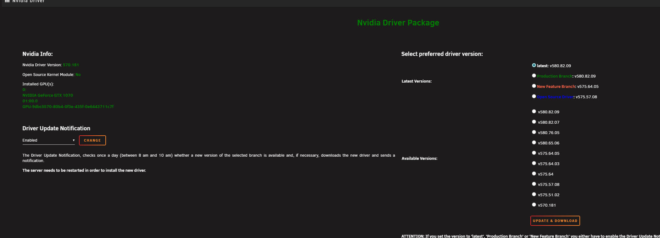

Just an FYI, I upgraded my 960 TI to a RTX 5050 recently and ran into various issues
Motherboard is a Z97M-Plus
  • Needed to enable Above 4G to resolve unraid NVIDIA-SMI has failed because it couldn't communicate with the NVIDIA driver. Make sure that the latest NVIDIA driver is installed and running
  • Once above was enabled, ran into no device found
  • Changed from latest to the Open Source Driver and now it's all working
Surprised that the open source driver was what let it all work, but hey, I'll take it lol
5000 Series and up only supports the Open Source driver version.

2 hours ago, unrateable said:
Thank you for your take, I will look into that again and try different setups to find out what is causing the high load, and how it would handle additional streams.
Dolby Vision is causing the high load and because you are transcoding from 4K to 4K unnecessary high bit rate, as explained above you usually transcode from 4K to 1080p.
Most posts here, and in other threads, talk about transcoding from 4K to 1080p or at least 4K to 4K "main" profile with a reasonable bit rate.
43 minutes ago, thymon said:
The only thing that finally stopped the issue 100% was enabling NVIDIA persistence mode, so the driver never tries to re-initialize the GPU during idle:
That's not how you use persistence mode by today's standards, please use:
nvidia-persistenced
in your go file instead.
