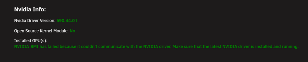

@ich777 apologies
So I'm pretty sure I messed up.
I have been running a p2000 for a while with no issues. I got a 5060ti the other day and was getting this issue. NVIDIA-SMI has failed because it couldn't communicate with the NVIDIA driver.
I got the v580.95.05 open source driver but was still getting the issue. I restarted a few times, change pcie to gen 4, updated bios, uninstalled and reinstalled the plugin, and updated unraid from 7.0 to 7.2.2.
The error then changed to something like No devices were found. I tried restarting, then I tried running "nvidia-smi -pm 1" from the xploit61 post on November 2nd. I can't remember if I ran this one as well or not "nvidia-persistenced" from ich777 post on November 2nd. However, now when I try to reboot it goes to the boot gui and then the display is gets no signal and unraid does not launch.
I am able to get unraid to launch with my p2000 or with my p2000 and 5060ti. when I have both in they now show up for whatever reason. but I can't get it to boot with just the 5060ti.
attached is a screen shot of the plugin page and 'nvidia-smi' output. I am unsure how to pull server diagnostics without ip and info at this moment.
thanks for any and all help in advance!
Do you have Diagnostics?
Please don't, as mentioned a few posts or even one post below this is not the preferred method, simply use:
nvidia-persistenced
What do you mean by that? How did you get that screenshot then?
You can always create Diagnostics when opening a Terminal or even locally and type in: diagnostics
This will then be saved to the logs directory on your USB Boot device.
Are you sure that it doesn't boot or do you see just a blinking cursor in the top left corner?
Just to be clear, the OpenSource driver only supports GPUs RTX20 and up (including the GTX16 series) and the other drivers only supports up to RTX40 series.
So to speak you can't utilize both cards in your system, it's either you P2000 or your RTX5060ti.
I'm not sure what's going on with the boot issue since this seems very strange to me and usually has nothing to do with the Nvidia Driver.
From what I see from you Diagnostics, the RTX5060ti is properly recognized and should work, I see no other obvious issue.
If the card is dropping from the Bus then you can try to put nvidia-persistenced in your go file. Please also check that your Power Supply is up to the task since they degrade over time.

Hello-
I am also getting the "NVIDIA-SMI has failed because it couldn't communicate with the NVIDIA driver. Make sure that the latest NVIDIA driver is installed and running" error after upgrading my driver to 590.44.01 this morning. Any docker that uses the extra parameters "--runtime=nvidia" will no longer start. I've attached my diagnostics to hopefully troubleshoot the issue.
Thank you!
tower-diagnostics-20251205-0740.zip
