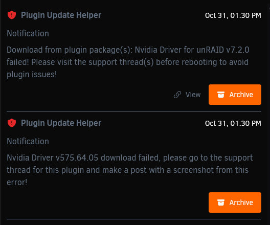

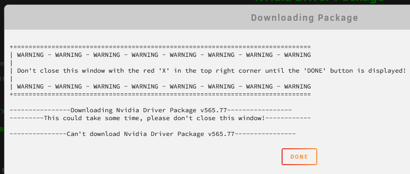

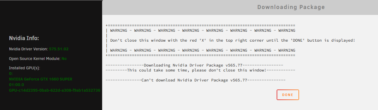

Hi, I just updated my unraid to 7.2.0, but now my nvidia driver stopped working. it automatically replaced the existing driver with v580.105.08, instead of the 470.xxx that i need for my gtx 760. I don't see any option to select such legacy driver and i can't find a download.
Edited by HansieAndersje
Please see this recommended post on top:
