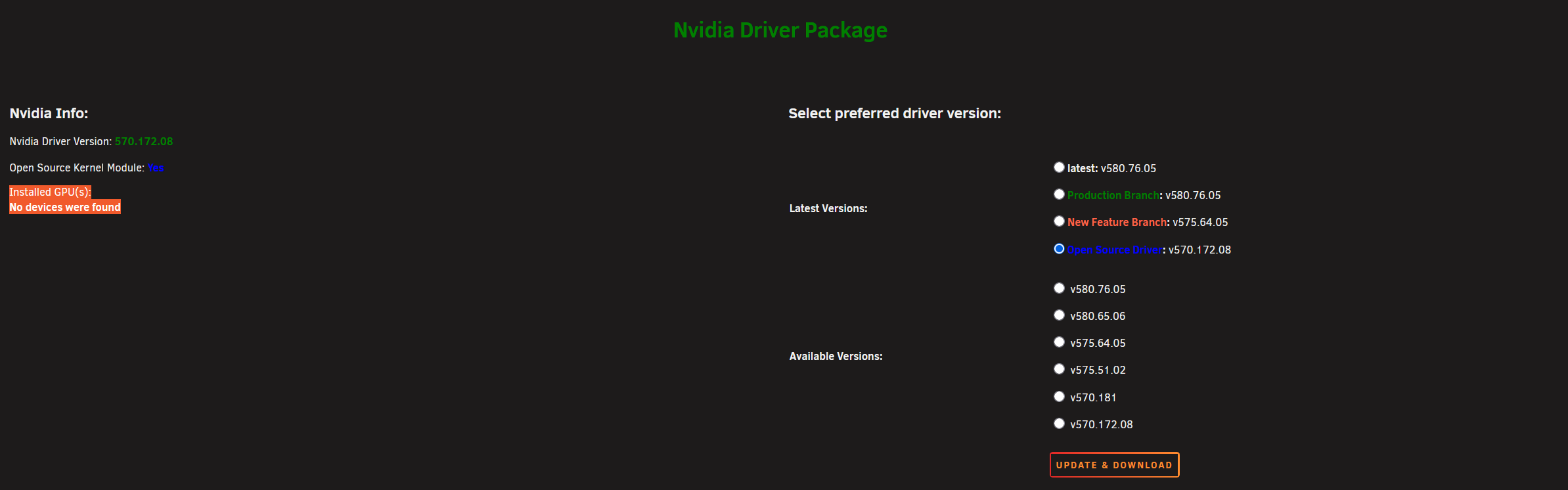

Good morning, I have an issue with the driver I believe. Is not recognizing my rtx 5060 ti. I updated the unraid to 7.2 beta, I have nvidia drivers set up on open source but is still saying "Installed GPU(s): No devices were found".
Any suggestions what should I try next?
Thank you.
Post your Diagnostics, as pointed out in the first post since they are required to troubleshoot hardware issues
hope this helps :)
I'm not 100% sure how you did that but nouveau is enabled.
01:00.0 VGA compatible controller [0300]: NVIDIA Corporation GB206 [GeForce RTX 5060 Ti] [10de:2d04] (rev a1)
Subsystem: Micro-Star International Co., Ltd. [MSI] Device [1462:5351]
Kernel driver in use: nvidia
Kernel modules: nouveau, nvidia_drm, nvidia
01:00.1 Audio device [0403]: NVIDIA Corporation Device [10de:22eb] (rev a1)
Subsystem: NVIDIA Corporation Device [10de:0000]
And your GPU fell from the BUS:
Aug 15 09:24:51 nas kernel: NVRM: Xid (PCI:0000:01:00): 79, GPU has fallen off the bus.
You also have a lot of entries in your syslog from Nvidia, was the card working before or did you just put it in your system.
When the card falls from the bus this can have multiple reasons, please don't use a PCIe riser if you have one installed, try another slot, try to lower the PCIe Gen to 4 or even down to 3 speed, make sure your BIOS is up to date.

Is a brand new card, I received it yesterday. I remove my rtx a2000 and I add this one. Now after I added I didn`t know why is not recognise, so I search on google and I found the forum post where it said to change to open source. So I did that but my card is still not working / recognise by the plugin. Also I just tried now on chatgpt and it say that I should try to remove it and try to reseat the gpu maybe that would work. I am not sure what is the issue.
What PSU are you using ?
The rtx 5060 ti is using double the amount of energy than the a2000
Did you try the card on another computer ?
I had an issue whe using an rtx 5080 with a motherboard with gen 5 pci but with a gen 4 pci riser
Not yet, I am still at work. Is a 750w or 650w (I don`t remember exactly) power supply from silverstone, about 1 year old. I do not have any riser cable is directly in the pcie slot. I didn't try it yet in an other computer.
So I reseat the gpu, I tried it on an other PC and is working. I even set up every pcie from bios on gen4/5. I am getting output on the gpu but the unraid just don't want to use it, is getting me this error when is starting:
Aug 15 17:21:51 nas kernel: NVRM: nvCheckOkFailedNoLog: Check failed: GPU lost from the bus [NV_ERR_GPU_IS_LOST] (0x0000000F) returned from rpcRecvPoll(pGpu, pRpc, NV_VGPU_MSG_EVENT_GSP_INIT_DONE) @ kernel_gsp.c:4744 Aug 15 17:21:51 nas kernel: NVRM: nvAssertOkFailedNoLog: Assertion failed: GPU lost from the bus [NV_ERR_GPU_IS_LOST] (0x0000000F) returned from kgspWaitForRmInitDone(pGpu, pKernelGsp) @ kernel_gsp_gh100.c:928 Aug 15 17:21:51 nas kernel: NVRM: RmInitAdapter: Cannot initialize GSP firmware RM Aug 15 17:21:51 nas emhttpd: shcmd (78): /etc/rc.d/rc.docker start Aug 15 17:21:51 nas rc.docker: Starting Docker daemon... Aug 15 17:21:51 nas kernel: pcieport 0000:00:01.0: AER: Multiple Correctable error message received from 0000:01:00.0 Aug 15 17:21:51 nas kernel: pcieport 0000:00:01.0: AER: Multiple Correctable error message received from 0000:01:00.0 Aug 15 17:21:51 nas kernel: pcieport 0000:00:01.0: AER: Multiple Correctable error message received from 0000:01:00.0 Aug 15 17:21:51 nas kernel: pcieport 0000:00:01.0: AER: Uncorrectable (Non-Fatal) error message received from 0000:01:00.0 Aug 15 17:21:51 nas kernel: pcieport 0000:00:01.0: AER: Multiple Correctable error message received from 0000:00:01.0 Aug 15 17:21:51 nas kernel: pcieport 0000:00:01.0: AER: found no error details for 0000:00:01.0 Aug 15 17:21:51 nas kernel: pcieport 0000:00:01.0: AER: Multiple Uncorrectable (Non-Fatal) error message received from 0000:01:00.0 Aug 15 17:21:51 nas kernel: pcieport 0000:00:01.0: AER: Multiple Correctable error message received from 0000:00:01.0 Aug 15 17:21:51 nas kernel: pcieport 0000:00:01.0: AER: found no error details for 0000:00:01.0 Aug 15 17:21:51 nas kernel: pcieport 0000:00:01.0: AER: Multiple Correctable error message received from 0000:00:01.0 Aug 15 17:21:51 nas kernel: pcieport 0000:00:01.0: AER: found no error details for 0000:00:01.0 Aug 15 17:21:51 nas kernel: pcieport 0000:00:01.0: AER: Multiple Correctable error message received from 0000:00:01.0 Aug 15 17:21:51 nas kernel: pcieport 0000:00:01.0: AER: found no error details for 0000:00:01.0 Aug 15 17:21:51 nas kernel: NVRM: iovaspaceDestruct_IMPL: 1 left-over mappings in IOVAS 0x100 Aug 15 17:21:51 nas kernel: NVRM: GPU 0000:01:00.0: RmInitAdapter failed! (0x62:0xf:1859) Aug 15 17:21:51 nas kernel: NVRM: GPU 0000:01:00.0: rm_init_adapter failed, device minor number 0 Aug 15 17:21:51 nas kernel: NVRM: osInitNvMapping: *** Cannot attach gpu Aug 15 17:21:51 nas kernel: NVRM: RmInitAdapter: osInitNvMapping failed, bailing out of RmInitAdapter Aug 15 17:21:51 nas kernel: NVRM: GPU 0000:01:00.0: RmInitAdapter failed! (0x22:0x56:742) Aug 15 17:21:51 nas kernel: NVRM: GPU 0000:01:00.0: rm_init_adapter failed, device minor number 0
Any other suggestions?
hey i just wanted to report back that updating BIOS to the latest edition (which was posted the day after i updated to the beta BIOS... 🥲) and turning off XMP profile, along with double checking 4g encoding/resizable bar was enabled... i have not had any of the issues previously reported. been stable for a few days now and been running GPU related tasks with no problems at all.
would try turning off any xmp profiles if enabled, and make sure bios are updated. cheers.
Hello lads, I managed to “fix” the issue that I had. Apparently my motherboard is advertised as pcie 5.0 and it have options to set up auto or 5.0 the pcie but when you leave it to auto or 5.0 or even 4.0 is breaking the unraid (when I say that it mean that my pools are not working anymore and I need to redo the unraid usb stick and copy my config again, I dont know why unraid is doing that) and the gpu is not working. But I set up everything on gen 3.0 x8 and everything is working fine, not ideal but for now until I find a new motherboard is fine. Thank you to everyone for all the support. Much appreciated.

Hi, I’m currently using an RTX 5060 Ti.
When I try to use Latest / Production Branch / New Feature Branch, I get a message recommending that I use the Open Source Driver instead.
However, I noticed that the Open Source Driver version is lower than the other branches:
  • Latest: v580.76.05
  • Production Branch: v580.76.05
  • New Feature Branch: v575.64.05
  • Open Source Driver: v575.57.08
On GitHub, I can see that the Open Source Driver goes up to v580.76.05, but in Unraid it only shows v575.57.08.
Does this mean the Open Source Driver is no longer being updated for Unraid?
Thanks in advance for your clarification.
