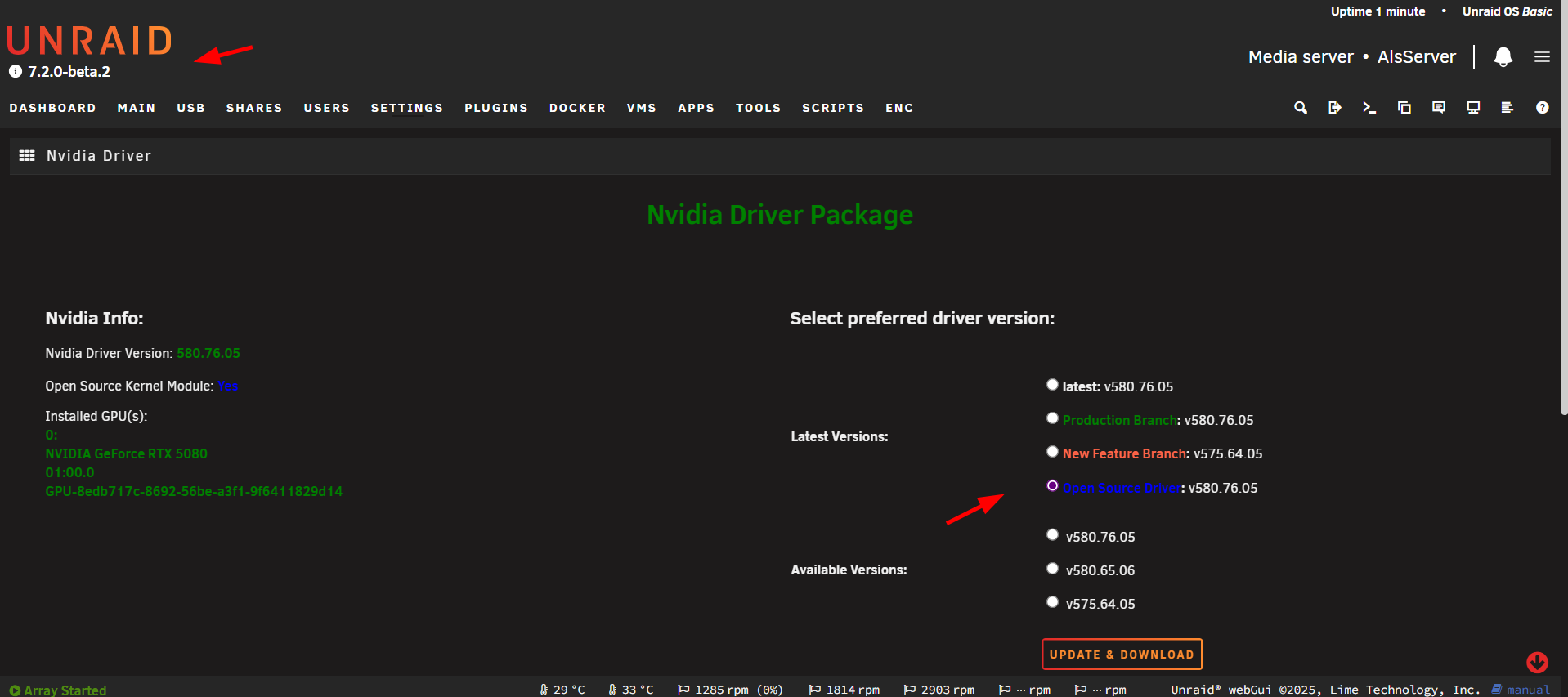

Hi, I’m currently using an RTX 5060 Ti.
When I try to use Latest / Production Branch / New Feature Branch, I get a message recommending that I use the Open Source Driver instead.
However, I noticed that the Open Source Driver version is lower than the other branches:
  • Latest: v580.76.05
  • Production Branch: v580.76.05
  • New Feature Branch: v575.64.05
  • Open Source Driver: v575.57.08
On GitHub, I can see that the Open Source Driver goes up to v580.76.05, but in Unraid it only shows v575.57.08.
Does this mean the Open Source Driver is no longer being updated for Unraid?
Thanks in advance for your clarification.

3 minutes ago, xSniper said:
You need to use open source. Otherwise your gpu will not work. At least my 5060 ti didnt want without open source drivers.
Thanks for your comment. Yes, I’m already using the Open Source driver — I understand that’s required for the 5060 Ti to work.
My question was specifically about the version difference: in the NVIDIA plugin, the officially supported Open Source Driver is still at v575.57.08, while the other branches (Latest / Production) are already at v580.76.05.
That’s why I was asking whether the Open Source Driver is going to be updated further, or if it will remain behind the other branches in Unraid.
It will get updated, dont worry ;)
Really important information missing, your Diagnostics.
I only compile the Open Source driver when a new Unraid version is released, most people use their cards only for transcoding and the performance impact is negligible with an older driver.
However that all changes with the new drivers because the next driver from 580 series should be all be based on the Open Source Driver and the option Option Source will be removed a bit after that takes effect.

Thank you for the clarification.
I tried installing the Production Branch (v580.76.05), but I’m getting the following messages in the logs:
[   28.008621] nvidia: module license 'NVIDIA' taints kernel.
[   28.088155] nvidia-nvlink: Nvlink Core is being initialized, major device number 238
[   28.112649] NVRM: loading NVIDIA UNIX x86_64 Kernel Module  580.76.05  Thu Aug  7 20:32:41 UTC 2025
[   28.117677] nvidia-modeset: Loading NVIDIA Kernel Mode Setting Driver for UNIX platforms  580.76.05  Thu Aug  7 19:56:57 UTC 2025
[   28.128666] NVRM: The NVIDIA GPU 0000:01:00.0 (PCI ID: 10de:2d04)
               NVRM: installed in this system requires use of the NVIDIA open kernel modules.
[   28.129486] [drm:nv_drm_dev_load [nvidia_drm]] *ERROR* [nvidia-drm] [GPU ID 0x00000100] Failed to allocate NvKmsKapiDevice
[   28.129496] [drm:nv_drm_register_drm_device [nvidia_drm]] *ERROR* [nvidia-drm] [GPU ID 0x00000100] Failed to load device
(repeated messages: requires use of the NVIDIA open kernel modules)
It seems the card refuses to load unless the Open Source Driver is used.
I have attached my diagnostics for reference.
stonecoldsvr-diagnostics-20250821-1210.zip
as sample today
so, keep your Unraid updated and your NV driver also will be ...
Please read my response again:
Nvidia already said that they will deprecate support for older cards (10xx series and lower) in the 580 driver series but it seems like in the first release from this driver series the cards are still supported.
You have to stick to the Open Source driver version for now.
Thank you for the explanation.
I understand now that starting with the 580 series everything will move to the Open Source driver.
In this case, I’ll stick with the released 6.12.42-unraid kernel (or the beta) and wait for the next version.
Thanks again!

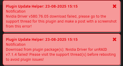

I have a quadro P4000 and I just ran the update from 7.0.1 to 7.1.4. I got two error:
I haven't rebooted yet since the upgrade because of the error. I'm unsure what to do.
Thank you
edit: I think I found the problem but now, I'm unsure what to do. Still waiting for the reboot post upgrade, it seems my usb drive is full!
I do have another usb drive that I bought about 6 months ago to replace it, never done it. Can I do it now while it's pending the reboot? What should I do?
Edited by Nodiaque
Please upgrade you USB Boot device since you need at least about 400MB of free space on the USB Boot device for an upgarde from the Nvidia Driver.
However the plugin tries to download the new driver on boot anyways but please keep in mind that the boot will take longer.
Ok, so do I just reboot to finish the upgrade to 7.1.4 without nvidia driver, backup the flash and swap the usb or do I swap before finishing the 7.1.4 upgrade?
I did manage to put 360mb space by deleting old package. I do have 800mb that I could get from the previous folder but unsure if it's wise to delete that folder before finishing the upgrade to 7.1.4
Edited by Nodiaque
You can do this how you like it and it doesn‘t matter much.
You can delete it if you want to.
How exactly do you install the Open Source Driver? I just swapped a 3060 for a 5070
Did you yet visited the plugin page?
Wow, I feel like an idiot. This would be me straight up not reading the other options in the driver. Thank you
