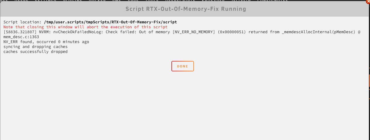

On 8/31/2025 at 7:59 AM, sausuke said:
Anyone how to solve this? I'm on 7.1.4 and using Open Source Driver: v575.57.08 with nvidia 5070ti. When I stopped using VM with GPU passthrough, sometimes nvidia driver cannot detect the 5070ti anymore? I need to restart the server again for it to appear?
Here's the log
Finally solved this problem, it's on this thread https://forums.developer.nvidia.com/t/575-64-nvrm-out-of-memory-error-causes-dgpu-to-not-be-usable-after-some-time/336877/11
I upgraded to the latest beta 7.2.0 beta and the same problem exist with latest driver v580.76.05. Used chat gpt to convert it to userscript. That Out of memory [NV_ERR_NO_MEMORY] (0x00000051) occurs on when using VM and playing a game or benchmark related like heaven benchmark.
How to create that error:
Open VM>Play a game or heaven benchmark>Shutdown VM> and when I go to Nvidia driver in settings keep refreshing and you'll see that Check failed: Out of memory [NV_ERR_NO_MEMORY] error and GPU will disappear later.
No error when just booting Windows VM and shutdown.
I haven't tried the latest driver in windows if that fixes this error. Will update later
here's the userscript and use it after VM releases my 5070ti to Unraid OS
#!/bin/bash
ERR_TEXT="NV_ERR"
LOOKBACK_MIN=5
ERR_LINE=$(dmesg | grep "$ERR_TEXT" | tail -n 1)
echo "$ERR_LINE"
if [ -n "$ERR_LINE" ]; then
ERR_TS=$(echo "$ERR_LINE" | awk -F'[][]' '{print $2}')
CURR_TS=$(cat /proc/uptime | awk '{print $1}')
ERR_TS_INT=$(printf "%.0f" "$ERR_TS")
CURR_TS_INT=$(printf "%.0f" "$CURR_TS")
TS_DIFF=$(((CURR_TS_INT - ERR_TS_INT)/60))
echo " $ERR_TEXT found, occurred $TS_DIFF minutes ago"
if [ "$TS_DIFF" -le "$LOOKBACK_MIN" ]; then
echo " syncing and dropping caches"
sync
sleep 5
if echo 3 > /proc/sys/vm/drop_caches; then
echo " caches successfully dropped"
else
echo " error dropping caches"
fi
else
echo " $ERR_TEXT is not recent; try re-running your VM"
fi
else
echo " $ERR_TEXT not found in recent dmesg buffer"
fi
logs after that error using that script

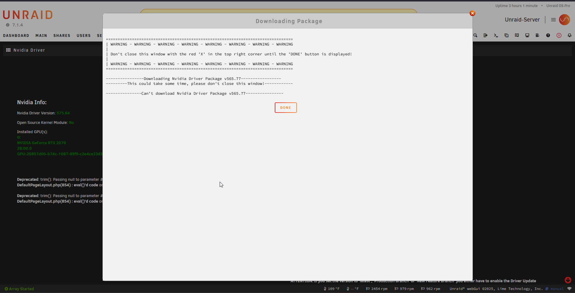

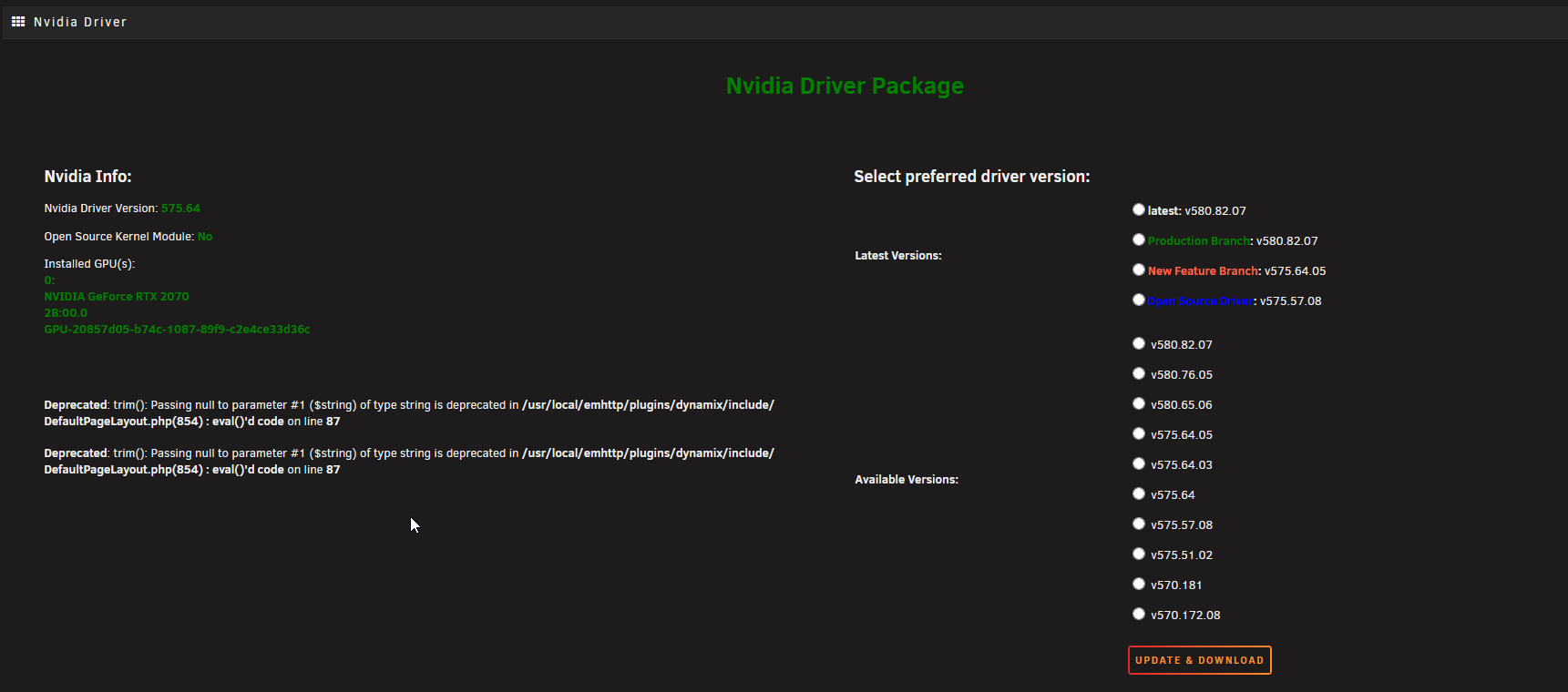

hey so I have an issue and havent seen a definitive fix so far. My Nvidia GPU wont update drivers. its a RTX 2070. the nivida tool gives this error.
I tried manually updating with terminal and no luck there either. i do have an error about something being depreciated but google gives nothing about the error or a fix. Im hoping someone here can help. I am currently here are the settings.
There is a Recommended Post on top of this thread, which is sadly not easily visible anymore since the new design, however here is the link to the post (this applies to your issue):

Update to this, got the same error NV_ERR_NO_MEMORY when using latest driver in Windows VM after shutdown, but I used the 5070ti in Invoke Ai with no problems with Unraid apps unlike lower version of Nvidia Driver in plugin. I guess I will just use the userscript and test the later version of Nvidia drivers for Unraid

thank you! that seemed to work! it was driving me nuts

6 hours ago, AnnabellaRenee87 said:
Please excuse me if I'm mistaken, but is this the Closed Source Driver
Can you please go a bit more in detail?
However all the drivers are closed source ones except for the option where it says Open Source.
30 minutes ago, AnnabellaRenee87 said:
Actually, does it matter if its closed or open source?
For 5000 Series cards, yes.
5000 Series only supports Open Srouce
2000 Series up to 4000 Series support both Closed and Open Source (including the 1600 series cards)
Everything below 2000 supports Closed Source only
