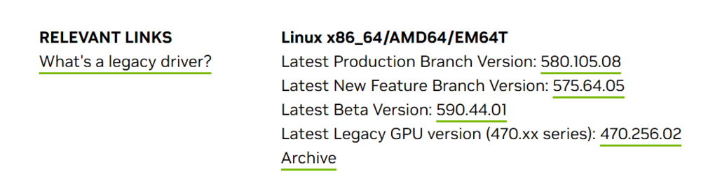

I just briefly read a post in some thread that the newest nvidia driver dropped support for all 1x series cards. Or maybe it was just 10xx cards, can't remember exactly. But maybe you need to roll back to a previous driver? Check what cards your driver supports.
Thanks, but I just checked and it seems like it’s still supported, but the plugin is using the beta version?
7 hours ago, tombstone said:
But as soon as I started Jellyfin and played a movie, the GPU disappeared.
Please post your diagnostics.
This.
All GTX 10 und 9 series are now legacy. All Turing based cards, including GTX16 series should work just fine bisides the point that the driver seems pretty unstable with the newer driver releases.
If you have selected "latest" on the plugins settings page, then yes, you will be on the beta driver because latest means always the latest available driver version, which not always must mean that you are on a Beta driver, but currently Beta is the latest available driver.
You know that the plugin has a settings page right?
1 hour ago, tombstone said:
I have download it, can I pm you 1st time doing this and now don't know what could be on this file?
Nope, I don't accept any PMs, there is usually nothing you have to hide in that file.
Please drag the Diagnostics file into the textbox here on the forums.
