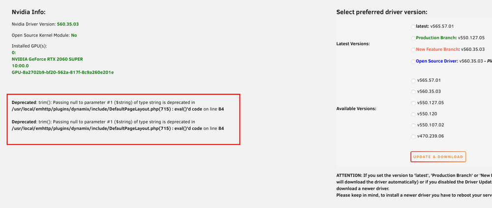

Just to clarify, you don't have these warnings on your plugin page?

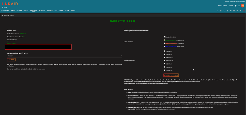

Can anyone help with this? I can see this error
However the GPU is available and is shown in the system devices. I am not sure how this can be fixed? Any help much appreciated.
I tried downloading the 580 drivers but I get an error unable to download.
I am stuck
