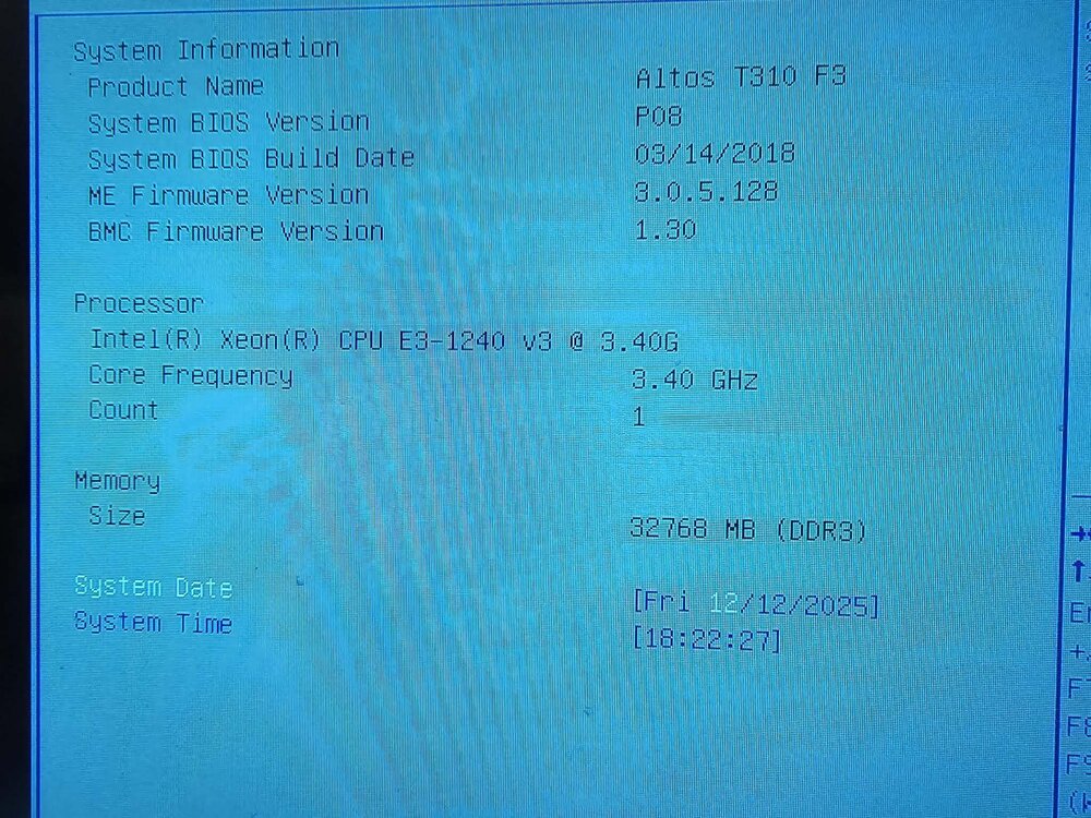

Sorry — I’m not sure how to update the server to the latest BIOS version, or how to check whether Above 4G Decoding and Resizable BAR support are enabled.
I also don’t know what nvidia-persistenced is, or where the go file is located but I think you may mean its in my BIOS setting so going to have a look now..
You have to go into the BIOS for that and check the settings.
For the BIOS update you have to check your Motherboards/Systems manufacturers website.

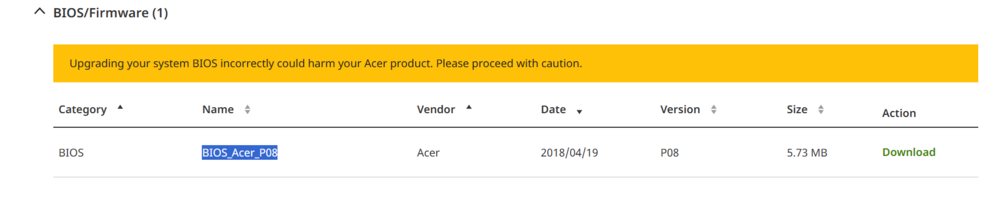

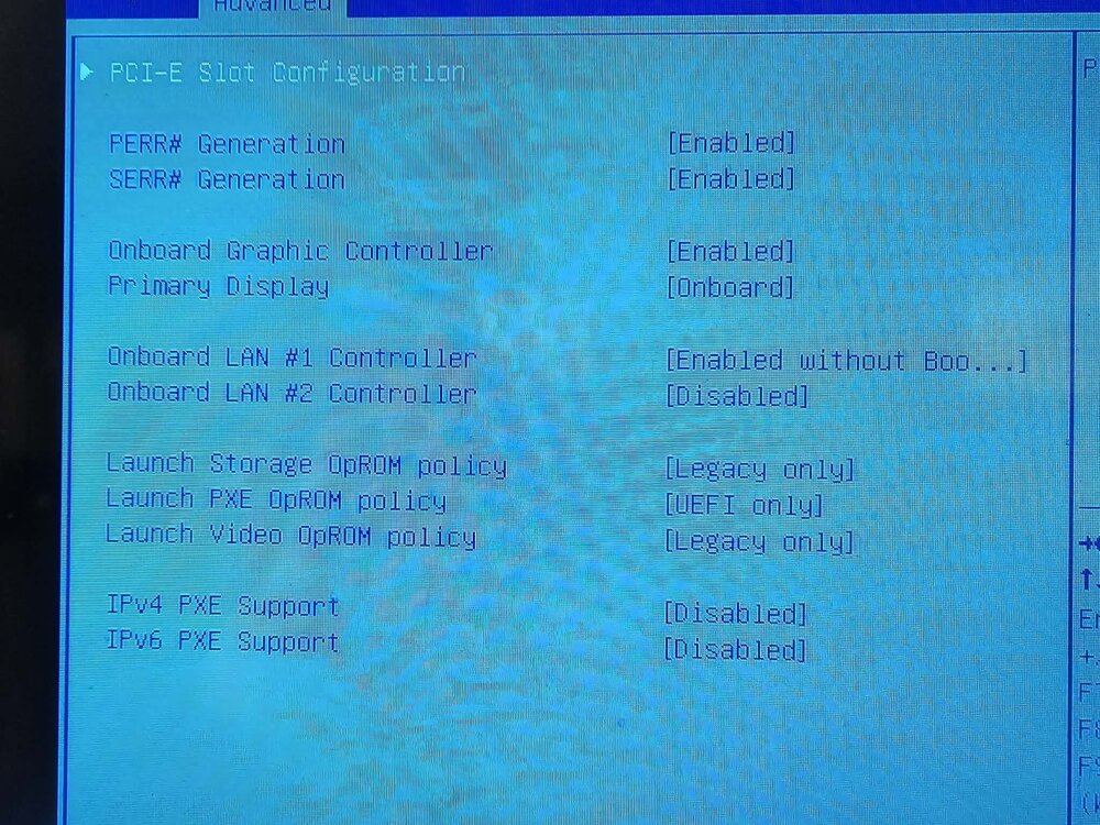

ok here is my setting for PCI-E in the bios.
what I can see my bios is BIOS_Acer_P08
69b0a15c-0c88-4833-b1ee-a7f515f6cb64.jpge
and from this page its the only one.
https://www.acer.com/au-en/support/product-support/Altos_T310_F3

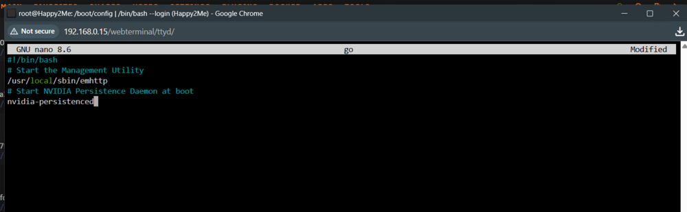

I am thinking this is what you mean?
Okay, seems pretty old but you might be out of luck with the BIOS updates, seems this machine is deprecated from the manufacturer.
Seems your machine doesn't support either of these options.

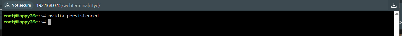

Not exactly but it is enough if you issue it once after a reboot.
May I ask if this is a new issue or a new installation or even a new GPU or a new installation from Unraid?
Most of the times it's a hardware incompatibility issue or a wrong set setting in the BIOS, but I don't think it's the latter in your case.
sorry now looking at it is this were you mean for me to do
I use ther nano go right
Unraid should have a file explorer where you can edit files directly in the WebUI.

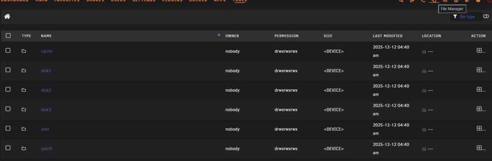

file mangager but no way to get into the USB (boot drive) that I can see.

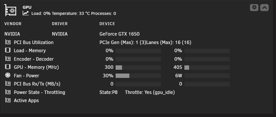

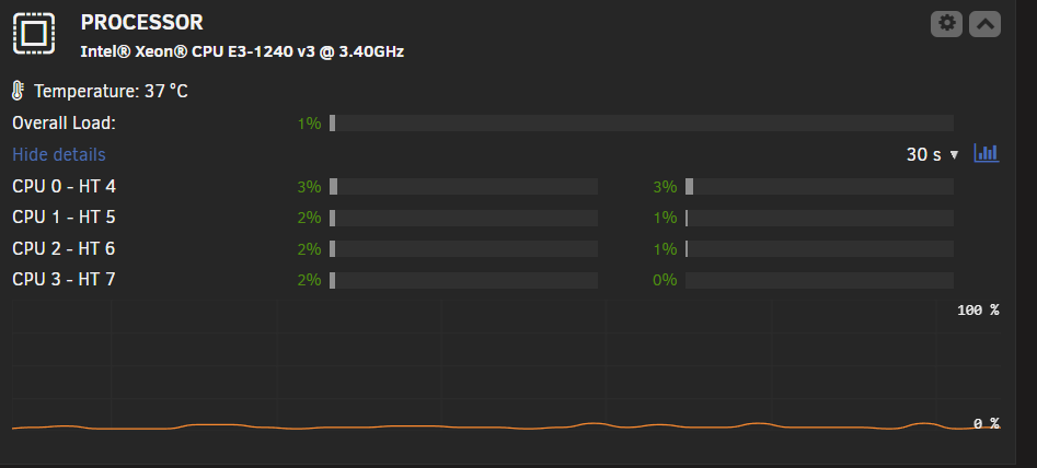

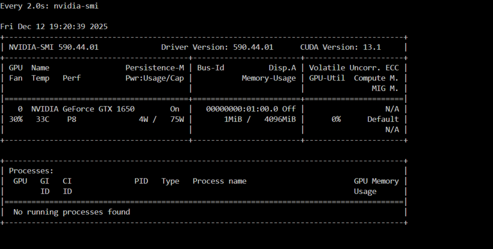

the nvidia-persistenced seems like th cpu is alot more carma now but seems lik the GPU is still not doing anything.
have done another diagnostic when playing an movie on jellyfin, what do you think? is it fix or its the best its going to get?
happy2me-diagnostics-20251212-1921.ziph

2 hours ago, tombstone said:
Also is this what I do to make it work after reboot.
I don't know if that will definitely help but a few users reported that this helped, however that looks okay.
Sorry, you have to ask that on the container side of things however it looks like you don't do transcoding if you are currently playing a file.
Please also note, if audio transcoding is needed, this is done on the CPU not on the GPU.

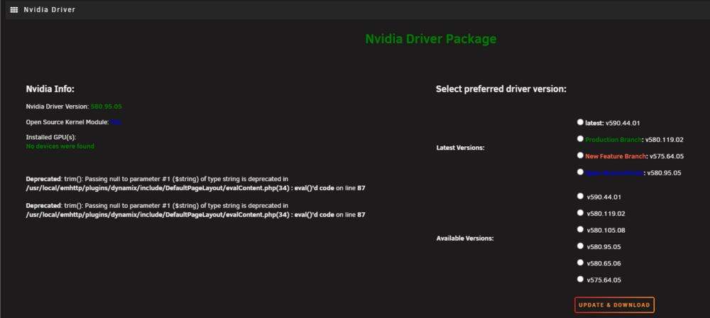

Hello, i've searched many forums but didn't quite manage to find the problem i have. I built my first HomeLab recently and have the following main specs:
- AsRock B650D4U-2L2T/BCM
- AMD EPYC 4345P
- Nvidia RTX 5060
- Unraid 7.2.2
Ever since setting up my Server around a week ago i couldn't detect my GPU fully.
The device doesn't show up in Plex when i try to choose a device for transcoding.
lspci shows my GPU:
01:00.0 VGA compatible controller: NVIDIA Corporation GB206 [GeForce RTX 5060]
01:00.1 Audio device: NVIDIA Corporation GB206 High Definition Audio Controller
But nvidia-smi doesn't find the device:
root@Tower:~# nvidia-smi
No devices were found
root@Tower:~#

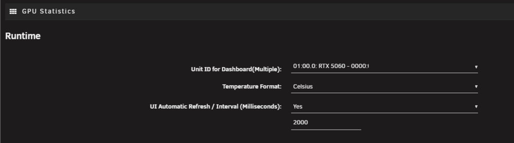

GPU Statistics shows the GPU:
But in the Dashboard, it only says "PCI Bus Utilization":
Nvidia Driver does have the Open Source version that is required for 50XX cards, but the device is not found:image.png
I've also not bound anything in system devices, no checkmarks for:
IOMMU group 13:
[10de:2d05] 01:00.0 VGA compatible controller: NVIDIA Corporation GB206 [GeForce RTX 5060] (rev a1)
[10de:22eb] 01:00.1 Audio device: NVIDIA Corporation GB206 High Definition Audio Controller (rev a1)
Another output from the terminal that clearly detects my gpu:
root@Tower:~# lspci -ks 0000:01:00.0
Subsystem: CardExpert Technology Device f331
Kernel driver in use: nvidia
Kernel modules: nouveau, nvidia_drm, nvidia
root@Tower:~#
The only logical reason for me is that the driver doesn't support my gpu, but in the post it clearly says i need the open source, meaning the v580.95.05 version which i have installed. I've run the latest version before, but it gave out the same results as now with the open source version..
Are there any other reasons my gpu gets detected in some ways but doesn't really work for Unraid?

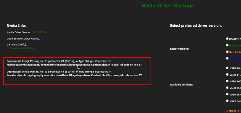

First of all, your plugin is broken, you can see that on these lines:
Please remove the plugin, reboot, install the plugin again, select the open source driver, click Download & Update and reboot again.
From what I see from your syslog:
Dec 14 02:27:30 Tower kernel: NVRM: nvCheckOkFailedNoLog: Check failed: Out of memory [NV_ERR_NO_MEMORY] (0x00000051) returned from memdescAllocInternal(pMemDesc) @ memdesc.c:1359
Dec 14 02:27:30 Tower kernel: NVRM: _kgspBootGspRm: unexpected WPR2 already up, cannot proceed with booting GSP
Dec 14 02:27:30 Tower kernel: NVRM: _kgspBootGspRm: (the GPU is likely in a bad state and may need to be reset)
Dec 14 02:27:30 Tower kernel: NVRM: RmInitAdapter: Cannot initialize GSP firmware RM
Dec 14 02:27:30 Tower kernel: NVRM: GPU 0000:01:00.0: RmInitAdapter failed! (0x62:0x40:2015)
Dec 14 02:27:30 Tower kernel: NVRM: GPU 0000:01:00.0: rm_init_adapter failed, device minor number 0
Dec 14 02:27:32 Tower kernel: NVRM: nvCheckOkFailedNoLog: Check failed: Out of memory [NV_ERR_NO_MEMORY] (0x00000051) returned from memdescAllocInternal(pMemDesc) @ memdesc.c:1359
You are suffering from the same issues as others do, this is most of the times caused by hardware incompatbility or a wrong set setting in the BIOS.

I'm at the latest version: v590.44.01
Not really sure how to fix this.
tower-diagnostics-20251216-0802.zip
