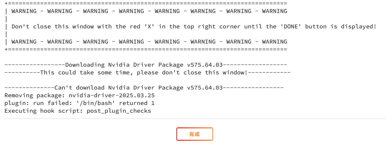

图片.pngIt always appeated when I reinstall the Nvidia-Driver. How to improve?
3 hours ago, bobbintb said:
I just want to make sure, is it ok to install this in my situation?
yep, may consider to vfio bind the "VM" Card so there will be no conflicts ... (then its unuseable for unraid and dockers, vm only then)
On what Unraid version are you?
Please post your Diagnostics after the failed attempt.
I got it and Thanks

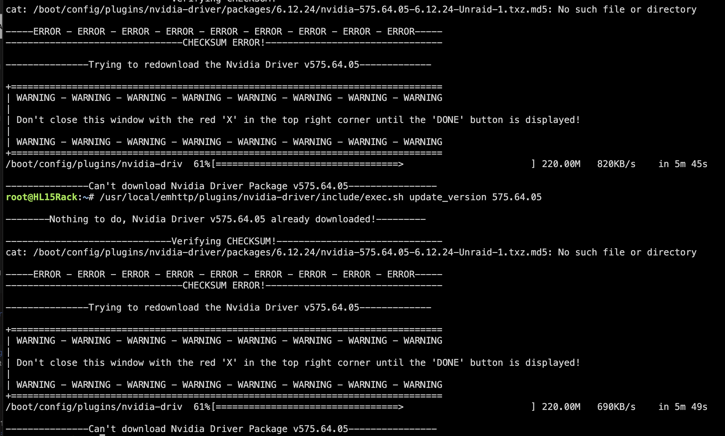

6 hours ago, Inch said:
unsure if its a issue with the download server?
The packages are hosted on GitHub.
Please don't call the update script like that, please do that from the WebUI by clicking and Update & Download this will either force a download or verification from the already existing driver.
The drivers for your Unraid version which you are trying to download are still there and as long as nothing is blocking access to GitHub on your network everything should work:
https://github.com/unraid/unraid-nvidia-driver/releases/tag/6.12.24-Unraid
EDIT: I just tried downloading the driver package and everything is working as expected.
Please again, don't call the scripts from the command line, this won't do anything different than the button on the Plugin page.
Hi thanks for the reply, the driver was failing to download via the web ui/plugin too. I'm trying again now, will update if it fails to go through again.
Looks like its failing to download again. I'm starting to wonder if this is an ISP issue or a problem with a Github node for me.
I've even tried downloading the latest driver via chrome and its failing also. Do you know of a way to manually install the plugin and driver package locally on unraid itself?
Edited by Inch
I don't know how to help since it seems there is some kind of issue with your Internet connection, I can not reproduce the issue over here and the download finishes just fine.
Do you possibly have some Unifi network gear, if yes, please check if you IDS/IPS is maybe set to strictly since this caused also issues for a few users.
Since even the driver download fails it would be a pretty manual process downloading the plugin and everything to get it going and when you can't get the driver the plugin installation wouldn't help much.
Please try to diagnose in your logs from your Firewall/Router, maybe that's the culprit and also disable AdBlocking if you have enabled some kind of.
Thank you for your help, I was able to get it to go through after multiple failures. Checked to make sure nothing was using free api tokens or anything, which is wasn't. Checked my firewall/gateway no obvious blocks going on, also allowlisted the github api -- will continue to monitor and share if i find anything for other Unifi users.
Me again :D
So to update, I've been doing some tests. I decided to run some download tests of previous drivers from https://github.com/unraid/unraid-nvidia-driver/releases/tag/6.12.24-Unraid.
I've found that other drivers download fine, e.g. 570.153.02. However, the latest driver 575.64.05 always fails around 61% similar to my previous CLI screenshots. I'm honestly starting to wonder if the driver upload for 575.64.05 is corrupt or incorrectly synced on some of GitHubs CDN nodes or PoPs in the UK or some intermittent ISP specific peering issue. This would explain why this just keeps failing for that driver and not others.
> Failed - Unknown server error. Please try again, or contact the server administrator. Is the error that Chrome keps throwing. I don't believe this is a local network issue - if it were being blocked by my firewall the download wouldn't start at all.
edit further tests: VPNed over to France, ZERO issues whatsoever. Plugin feedback suggestion: if the plugin fails to download the latest driver version let it fall back once or twice to other drivers. Users can always update at a later date when there aren't download issues. 575.64.05 downloaded incredibly fast via the VPN. 25MB/s vs. 850KB/s.
Edited by Inch
This is a ISP issue and I see that from time to time.
Sorry but this is really hard to accomplish and I won‘t change that since this would be really hard to implement and got almost no time on hand currently.
Again I tried to download the file and it was just working without any issue, of course I tried that in my browser but it worked just fine.

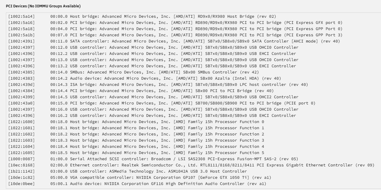

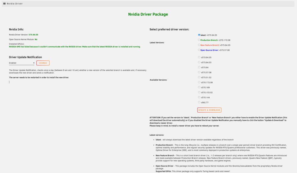

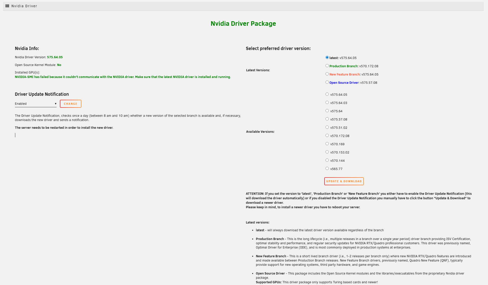

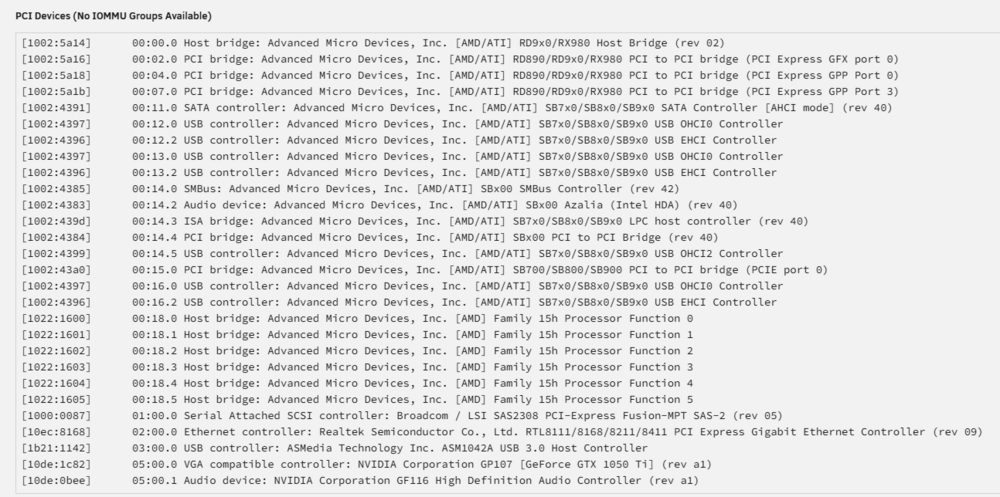

Hello All, having trouble with the:
Installed GPU(s):
NVIDIA-SMI has failed because it couldn't communicate with the NVIDIA driver. Make sure that the latest NVIDIA driver is installed and running.
Issue for Unraid. I have tried everything i can find online from reseating the GPU, disabling Secure Boot and more but cannot seem to get it working:
root@HomeServer:~# nvidia-smi
root@HomeServer:~#
GPU is detected as GTX 1050 TI in Tools -> System Devices.
Any help is appreciated!
