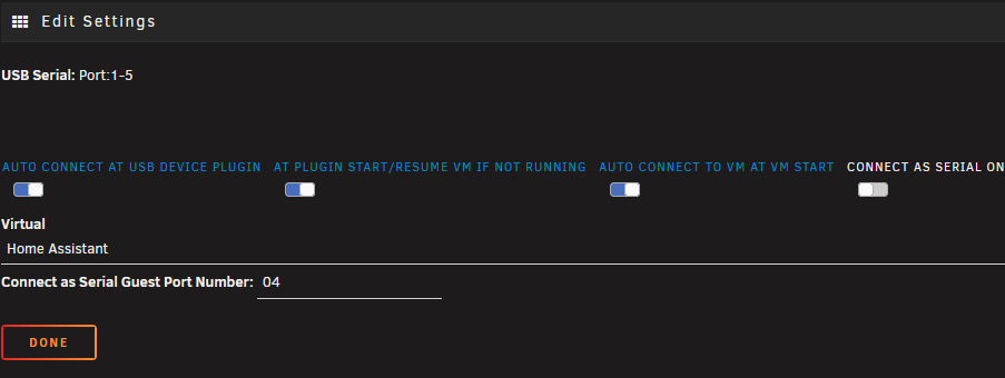

Thanks for pointing me in that direction. I found the issue may have been my Home Assistant had a device connected to it via USB that was set to automatically reconnect (see pic). I disabled those in USB Manager and the array was able to be stopped without issue. So far so good. I'll try again tomorrow to make sure and if it seems well, I'll make this as solved.
