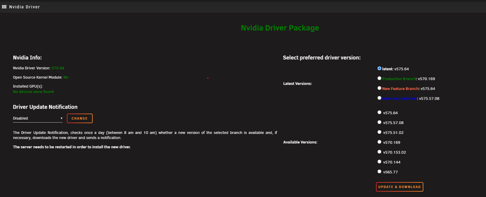

So I think I just stumbled upon my issue. The VM I am running appears to be grabbing the Nvidia GPU when my docker images are backed up and upgraded over night. By rebooting the VM, the gpu comes back and is viewable via the Dashboard and nvidia-smi. However, the docker images that want to use it cannot and must be rebooted as well.
So the final question is, how do I force the VM / VM manager to not steal the GPU? The GPU for the VM is set to virtual already.
The VM should only use the GPU if it's on the XML.
Cross posted on the thread for the Nvidia driver. https://forums.unraid.net/topic/98978-plugin-nvidia-driver/page/198/#findComment-1564122
If you take a look at the screen recording, you can see the graphics driver for the VM is virtual but as soon as the VM is shut down, the GPU comes back and is available for the system again. This seems to happen overnight when Backup/Restore Appdata is backing up my containers.
oldtown-diagnostics-20250628-1220.zip
Try binding the GPU to vfio-pci, that should prevent it from ever being used by the driver/OS
I ended dropping back to the production driver and the GPU is no longer being grabbed by the VM
