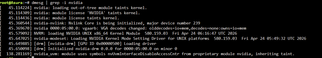

6 hours ago, Bluephoria said:
Despite updating to the latest plugin and swapping the driver, I'm still having issues.
Troubleshooting tried so far:
  • Update plugin and reboot
  • Upgrade driver (to 595) and reboot
  • Uninstall driver, reboot, install driver, reboot
  • Downgrade driver (to 580) and reboot
    I'm using an RTX 2000 Ada. The GPU ID is properly configured in my Plex and Tdarr dockers, but the GPU isn't able to be used.
    root@Storage:~# dmesg | grep -i nvidia
    [ 31.018588] nvidia: loading out-of-tree module taints kernel.
    [ 31.019314] nvidia: module license 'NVIDIA' taints kernel.
    [ 31.020648] nvidia: module license taints kernel.
    [ 31.231377] nvidia-nvlink: Nvlink Core is being initialized, major device number 239
    [ 31.240228] nvidia 0000:02:00.0: vgaarb: VGA decodes changed: olddecodes=io+mem,decodes=none:owns=io+mem
    [ 31.289817] NVRM: loading NVIDIA UNIX x86_64 Kernel Module 580.159.03 Fri Apr 24 06:16:47 UTC 2026
    [ 31.420257] nvidia-modeset: Loading NVIDIA Kernel Mode Setting Driver for UNIX platforms 580.159.03 Fri Apr 24 05:49:32 UTC 2026
    [ 31.423016] [drm] [nvidia-drm] [GPU ID 0x00000200] Loading driver
    [ 31.424264] [drm] Initialized nvidia-drm 0.0.0 for 0000:02:00.0 on minor 1
    [ 83.268922] nvidia_uvm: module uses symbols nvUvmInterfaceDisableAccessCntr from proprietary module nvidia, inheriting taint.

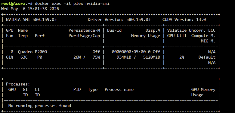

The GPU is visible to the container:
root@Storage:~# docker exec -it Plex-Media-Server nvidia-smi
Sat May 2 06:27:18 2026
| NVIDIA-SMI 580.159.03 Driver Version: 580.159.03 CUDA Version: 13.0 |
| GPU Name Persistence-M | Bus-Id Disp.A | Volatile Uncorr. ECC |
| Fan Temp Perf Pwr:Usage/Cap | Memory-Usage | GPU-Util Compute M. |
| | | MIG M. |
| 0 NVIDIA RTX 2000 Ada Gene... Off | 00000000:02:00.0 Off | Off |
| 30% 48C P0 17W / 70W | 0MiB / 16380MiB | 4% Default |
| | | N/A |
| Processes: |
| GPU GI CI PID Type Process name GPU Memory |
| ID ID Usage |
| No running processes found |

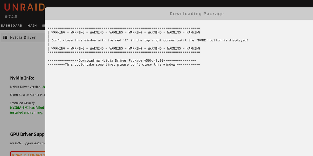

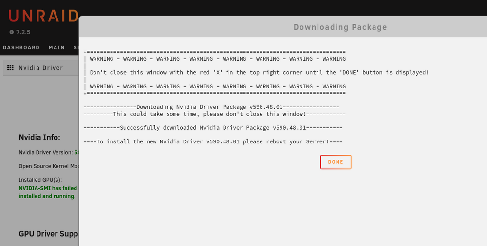

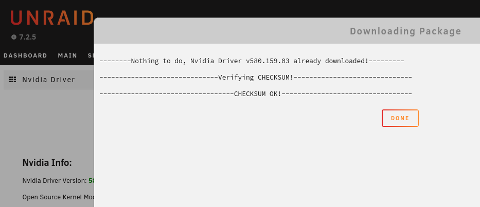

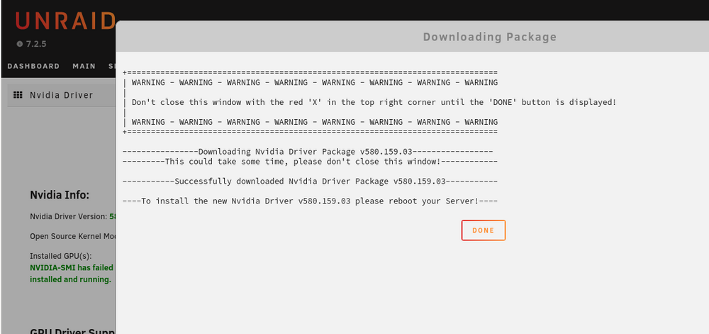

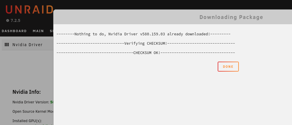

Adding this also here. https://forums.unraid.net/topic/198521-unraid-os-version-725-available/page/2/#findComment-1621088
To sum up, the driver i need to have is v580.159.03, and it gets overwritten somehow with the latest every time i do an update, even though v580.159.03 is selected. Plugin is v 2026.05.01.
Also, the screen when you click update & download is blank, so i always have to download it manually via terminal with /usr/local/emhttp/plugins/nvidia-driver/include/download.sh
The fix should work with the next Unraid upgrade, if not please report back (I've just pushed another fix in the Plugin Update Helper).
There might changed something but did you actually wait until it showed some text:
I just tried it and it works over here, granted that it took some time, however it looks like it's working as expected, do you possibly have an adblocker or something like that in use in your Browser :

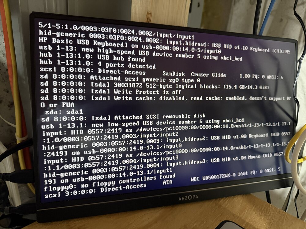

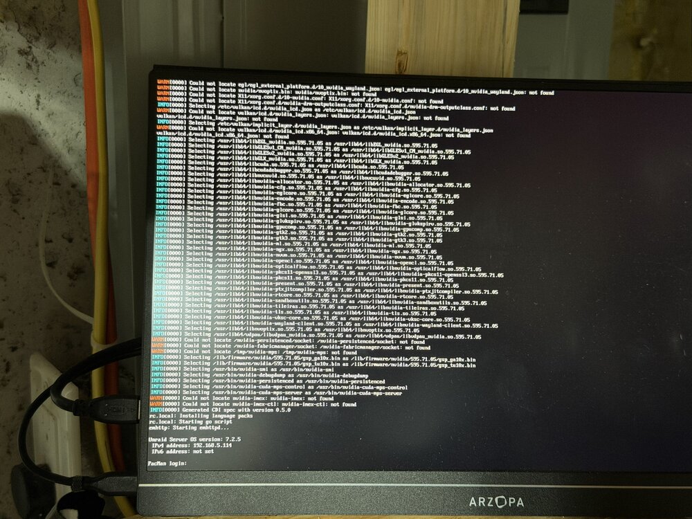

I'm having trouble recently and believe it's due to the Nvidia driver. When I reboot my server it hangs on the boot up process (photo). When I hard restart it again, it boots us fine, but screen shows a lot of warnings related to Nvidia (photos). It runs fine, but appears my dockers can't access it like they were previously (i.e. Plex can't do HW transcoding, using CPU). Server has 3060ti installed. Running Unraid 7.2.5 with Nvidia Driver 2026.05.01/595.71.05. Any advice would be helpful.
5 hours ago, tusculumgolfer said:
I'm having trouble recently an believe it's due to the Nvidia driver. When I reboot my server it hangs on the boot up process (photo). When I hard restart it again, it boots us fine, but screen shows a lot of warnings related to Nvidia (photos). It runs fine, but appears my dockers can't access it like they were previously (i.e. Plex can't do HW transcoding, using CPU). Server has 3060ti installed. Running Unraid 7.2.5 with Nvidia Driver 2026.05.01/595.71.05. Any advice would be helpful.

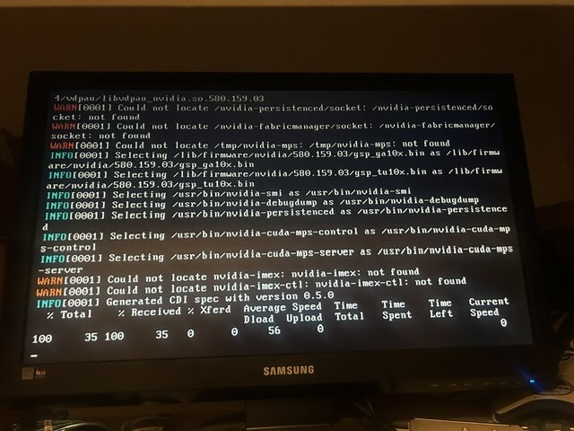

I am getting those same errors. Mine are with the 580.159.03 driver. SMI not reporting any transcoding processes when i force transcode from Plex.
Rolled back to 7.2.4 and get same errors on boot.
asura-diagnostics-20260506-1509.zip
Edited by Viperkc
added additional picture
9 hours ago, Viperkc said:
Sorry about that, you won't see those message anymore with the plugin update 2026.05.07, this was displayed by accident.
Where did you test that? In the browser or on a native app?
Does the card show up in your Plex transcoding settings?
Please post your docker run command.
It is a common issue that transcoding won't work if you force a transcode in the WebUI from Plex when using Nvidia Cards.
