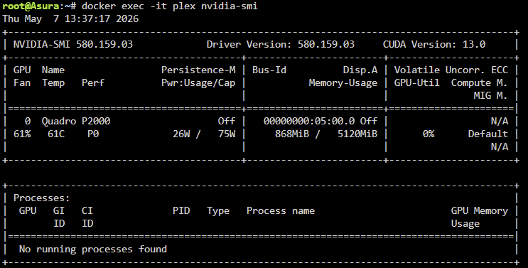

7 minutes ago, Viperkc said:
I still don't see any processes found when i run smi on the plex docker.
Your docker run command?
Do you see the card in your Plex transcoding settings?

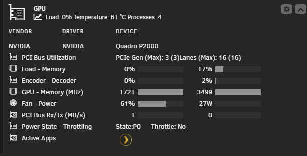

I have --runtime=nvidia under extra parameters
NVIDIA_DRIVER_CAPABILITIES = All
NVIDIA_VISIBLE_DEVICES - my device ID
Have been running this for 4+ yrs no issues
Yes I do see the card in Plex settings
I just noticed that in the GPU plugin it does show processes and some transcoding - so maybe the only thing that is broken is the SMI just not showing the processes
I just had noticed high CPU usage once upgrading to 7.2.5 and just panicked thinking transcoding was not being done by my GPU and the CPU was doing it.
I know there are processes ATM.
Thanks for all your help on this. Now to figure out why my CPU usage is so high with 7.2.5 - pretty sure its not related to the Nvidia driver.
Probably backed in subtitles, these are a nightmare for your CPU.
Transcoding is actually Throttled by Plex, meaning it transcodes a batch, then ends the process, transcodes a batch and so on... in between you won't see any processes.

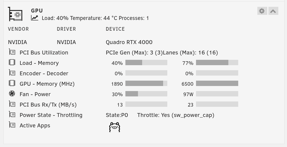

I'm trying to figure out if this is the right solution for me. I'm hitting a sw_power_cap even under ~50% load on my RTX 4000 running Ollama.
What would be right solution to fix this?
Running on unRAID 6.12.15 with the latest Nvidia driver 575.51.02
(I'm super new to managing my hardware down to this level so bare with me please)
This is not an issue per se, this is just a power limitation from your card to not get damaged. However since it seems you are using Ollama this question would be best suited in the support thread from the container.
However as said, that's just normal and nothing to worry about.
The script that you've linked is for VMs and not needed when running applications in containers.
That makes sense, I appreciate the feedback.
The original reason why I ask is because the sw_power_cap triggers around 98-100 watt, the RTX4000 has a 160 watt TDP rating, I guess I expected throttling to kick on closer to 150 watt.

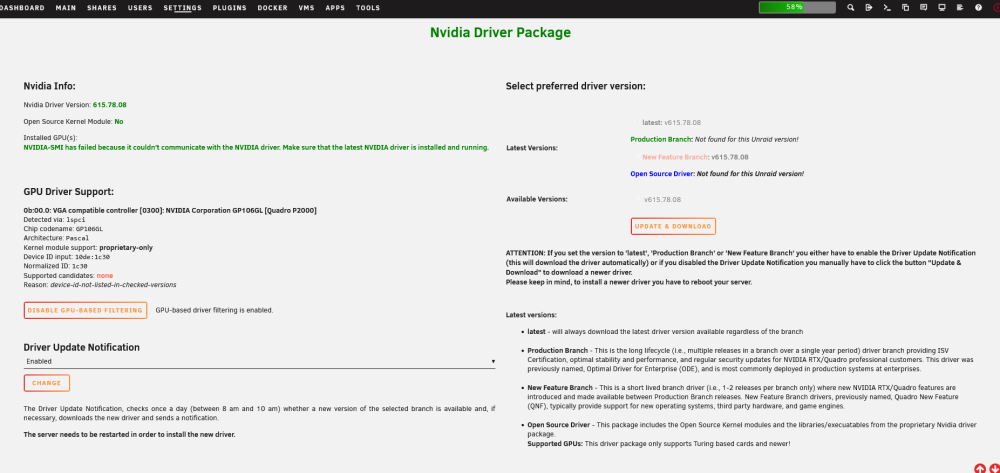

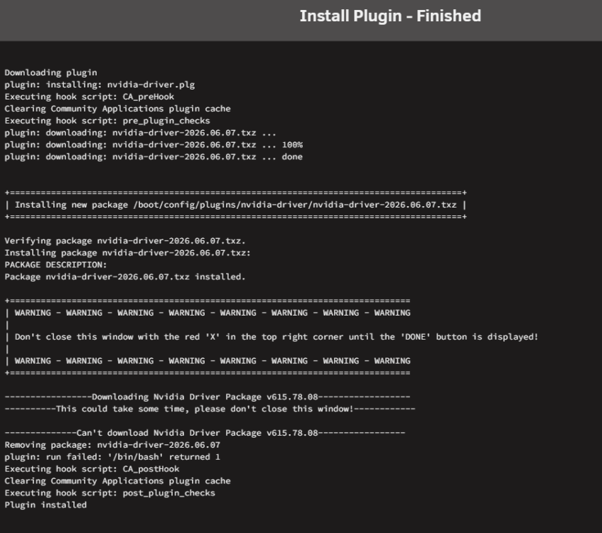

I'm on a GTX 1050ti and no matter what I do, I can't get the plugin to download and install the v580.159.03 driver. I keep getting "Can't download Nvidia Driver Package v580.159.03". I don't know how to manually force it to install. I have tried to wget the file directly into the directory it looks in and it will verify the checksum and pass but still says it can't download (it even deletes the file for some reason). Running unRAID 7.2.6 with plugin version 2026.05.07
How does the plugin page look like, do you have some php errors on there.
If you have php errros on the page please follow this procedure:
  1. Remove the plugin
  2. Reboot
  3. Install the plugin again
  4. Go to the plugin settings and select the 580.x driver and click Update & Download
  5. Reboot
Diagnostics would also always help.
