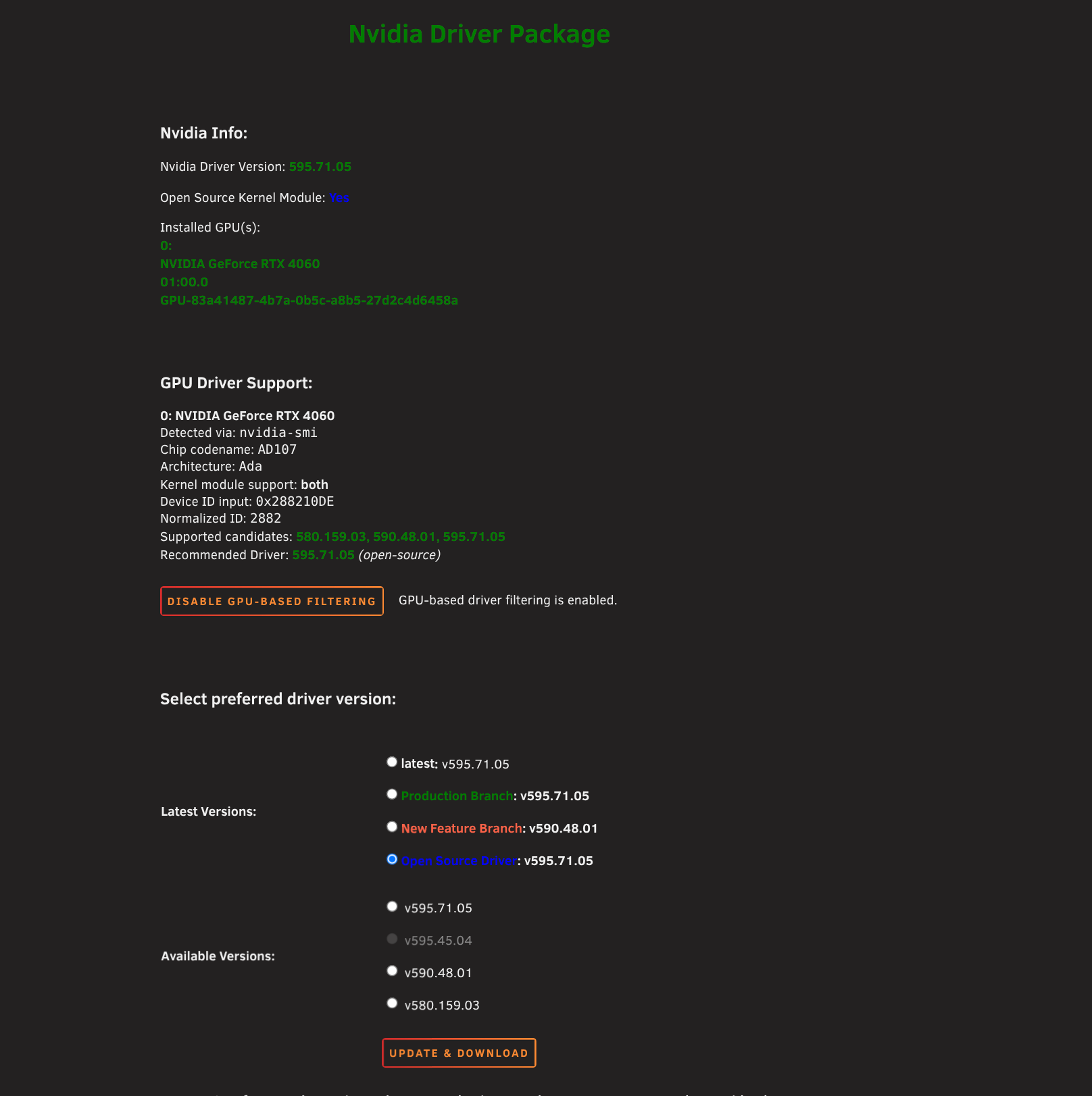

  3. just to update here my problem zfs mirror data corruption fixed i don't really sure what causing it, i try different sata port still same corruption report, no more corruption complain when i change docker system from cache0 to cache1 -tried rebuild docker system on cache0 still have corruption report -move docker system to cache1 fixed Note i have appdata and docker system on cache0 zfs mirror overlay2 data corruption complain on both drive.
  4. this is what i found maybe related ? Random screen freezes on Linux with driver 595.71.05 where even the keyboard stops responding — that's effectively a kernel freeze, which could block ZFS I/O mid-write. https://forums.developer.nvidia.com/t/595-71-05-screen-freezes-on-linux-wayland/369122 Graphical corruption after suspend/resume with Xid 13 errors on 595.71.05 https://forums.developer.nvidia.com/t/graphical-corruption-after-suspend-resume-with-nvidia-xid-13-595-71-05/368627
  5. i notice my zfs mirror get data corruption on both drive same file do mem test pass decide to downgrade from 7.2.6 to 7.2.5 the same thing happened lucky i have snapshot and backup problem solve when i downgrade from nvidia driver v595.71.05 to v580.159.03 bug product unraid 7.2.5-6 zfs mirror with dataset nvidia driver v595.71.05 RTX 4060 copy new file or do zfs scub will report new data corruption it's a silence data corruption no log no drive error only when i check zpool status -v cache is this PCIe/ZFS I/O corruption bug?

  7. maybe gtx 1060 end of life? so you would stuck on GPU 580.159.03
  8. that's happen to me as well 1.remove and reboot 2.install nvidia driver plugin, disable docker and enable docker worked for me!

  12. sorry my bad here the Diagnostics gnas-diagnostics-20260501-1427.zip
  13. thank for reply i have NVIDIA GeForce RTX 4060 now switch to open source driver still the same error docker run -d --name='llama.cpp' --net='br0' --ip='192.168.0.82' --pids-limit 2048 -e HOST_OS="Unraid" -e HOST_HOSTNAME="GNAS" -e HOST_CONTAINERNAME="llama.cpp" -e 'TCP_PORT_8000'='8080' -e 'CA_TS_FALLBACK_DIR'='/models' -l net.unraid.docker.managed=dockerman -l net.unraid.docker.webui='http://[IP]:[PORT:8080]/' -v '/mnt/ncache/appdata/llama.cpp/models':'/models':'rw' --gpus all 'ghcr.io/ggml-org/llama.cpp:server-cuda' f9238272f96172115220e760c98ae6daab201d5664e67e80b912c1592ff8c1e8 docker: Error response from daemon: failed to create task for container: failed to create shim task: OCI runtime create failed: runc create failed: unable to start container process: error during container init: error running prestart hook #0: exit status 1, stdout: , stderr: Auto-detected mode as 'legacy' nvidia-container-cli: ldcache error: process /sbin/ldconfig failed with error code: 1 Run 'docker run --help' for more information The command failed.
  14. just upgrade unraid to 7.2.5 docker that use --gpus all failed to start docker: Error response from daemon: failed to create task for container: failed to create shim task: OCI runtime create failed: runc create failed: unable to start container process: error during container init: error running prestart hook #0: exit status 1, stdout: , stderr: Auto-detected mode as 'legacy'nvidia-container-cli: ldcache error: process /sbin/ldconfig failed with error code: 1 /sbin/ldconfig /sbin/ldconfig: /usr/lib64/libOpenGL.so.0 is not a symbolic link /sbin/ldconfig: /usr/lib64/libGLdispatch.so.0 is not a symbolic link /sbin/ldconfig: /usr/lib64/libGLX.so.0 is not a symbolic link switch driver version and reinstall plugin won't help (each step reboot)
