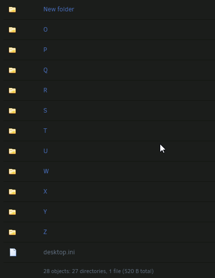

  6. I had one subfolder not reporting in Unraid, so I made a new one in Windows and renamed it. The problem is its not updating in Unraid. Its in my Music folder, V. It still shows as New Folder and doesn't want to update.
