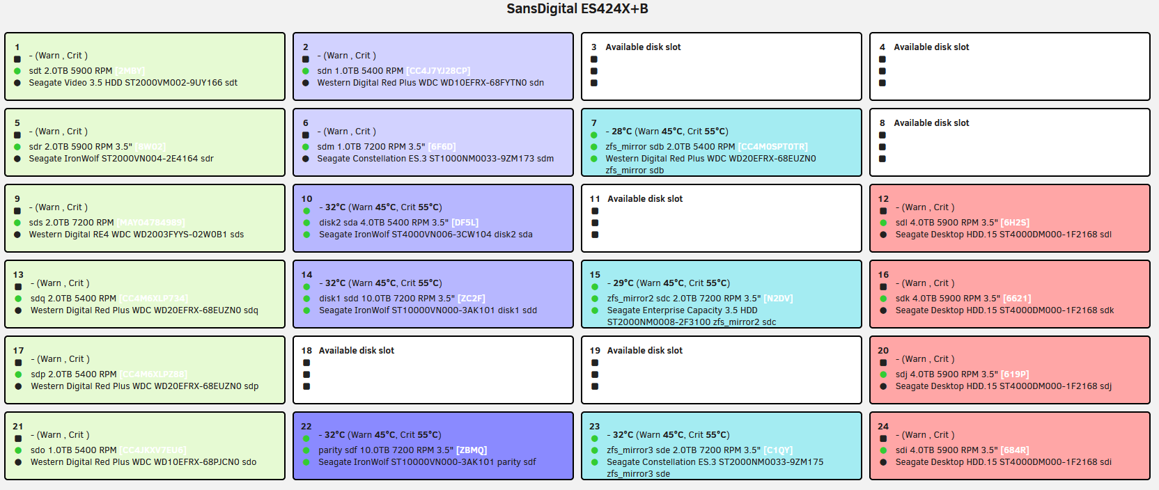

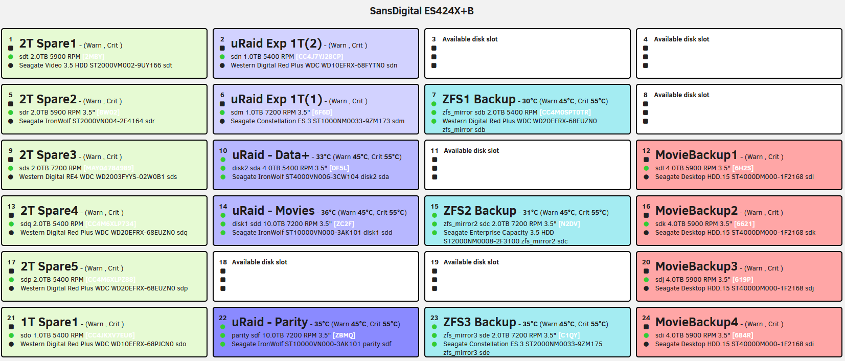

  1. Thanks for that, apologies, I missed that option too. I appreciate that you've put a lot of thought and customization into this. Initially I thought it would still be a easier to see at a glance if that particular LED was a different color vs black (in spun down static LED mode). But after looking at a mock up, I just needed to adjust my brain to look for what's on instead of what's spun down, which is really what one needs to know, and now easy to see. The full size dashboard might improve a little with gray IMO, but the already-implemented static LED helped the most. Thanks again.
  2. @FlamongOle : Last request for consideration, I love your dashboard with the details and the smaller summary panel for the Unraid dashboard with its hover for details feature, too. The tool is a pleasure to have for a larger chassis. One thing I would like to be able to see "at a glance" is whether or not my drives are spun down. Currently for a spun down drive, I get a blinking LED that alternates black/green. This is with "LED Display" set to unraid or circular (I use the Unraid LED option now). With this LED's blinking behavior, it's harder to tell at-a-glance which drives are spun down, you have to let your eye "hover" on that LED to see if it's gonna blink, then look at next drive of interest and so on. For a spun down drive, I'd like to see a different color there, in lieu of the blinking. This would be similar to what the Unraid Main tab does with a solid gray LED for a spun down drive. I don't care if it blinks or not, if the blinking were a different color pair for that state, so at any moment it's clear that the state of a drive is spun down. Maybe there are explicit reasons for the current LED color/behavior, but in any case, I think a different color for that state would be clearer. Thanks for considering.

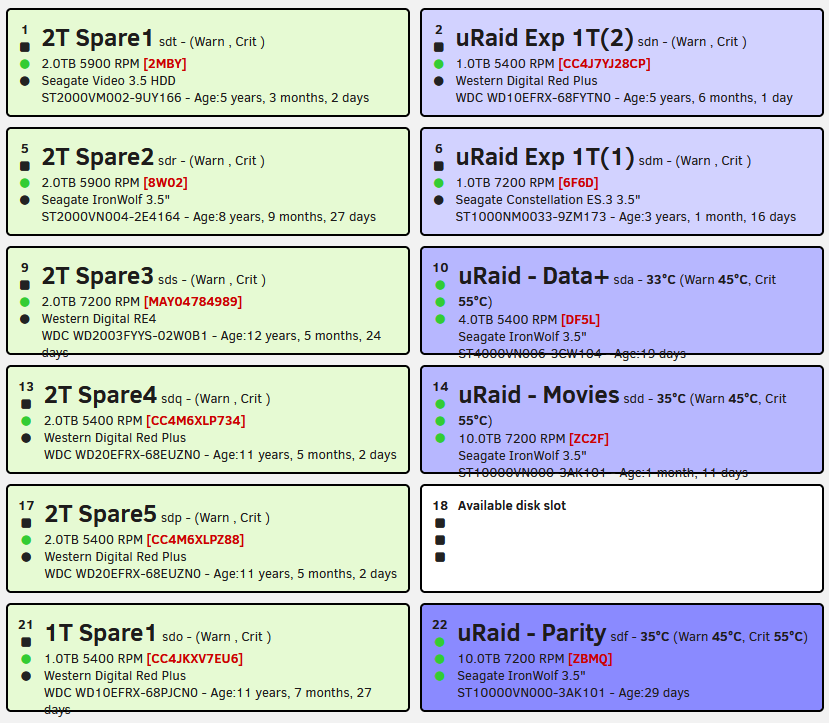

  4. Posted as a feature request at : https://github.com/olehj/disklocation/issues/527 In my configuration I have Trim serial numbers = 4. Thinking it meant something else. Coincidentally it worked as expected on my Seagates due to a 8 char SN. My WD drives only got their leading "WD-W" leading chars removed, but still give the rest of the serial number, not trimmed to last 4. Digging in to see why, in array_devices.php I see: $devices[$hash]["formatted"]["serial"] = ( isset($devices[$hash]["raw"]["serial"]) ? "" . substr($devices[$hash]["raw"]["serial"], $serial_trim) . "" : null ); So, from that I understand Trim 4 means "remove the first 4 characters.", not show the last 4, which is what I was originally expecting. FWIW, I normally chop the serials to their last digits so it's easier to look for the last 4 chars instead of the whole thing. Having a set length would also allow for a consistent length in your Dashboard Formatting's "serial" variable. I've never had a duplicate last 4 on my drives, but if I did I could move to displaying 5 etc. So I'm just throwing it out there for your consideration as an option or a change: In lieu of or an alternate option for "Trim Serial numbers ____" "Show last X chars of serial number ___" Code: $devices[$hash]["formatted"]["serial"] = ( isset($devices[$hash]["raw"]["serial"]) ? "" . substr($devices[$hash]["raw"]["serial"], -$serial_trim) . "" : null ); Thanks, Scott

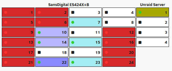

  5. One detail I missed earlier. The update cleared the drive "comment" fields. For both hot and cold drives as shown in my prev replies image. I reset the comment fields, and just double clicking on each line, the last comments (that actually matched the drives or possibly the location of the field) were there to pick so it wasn't hard to do. Once the comments were reset, another force Smart+DB, and even though the cold drives were disconnected, all the comments remained stuck.

  8. Unraid 7.3.2 with an attached 24 bay SAS enclosure. I had it all configured, my different arrays color coded, my blocks formatted to suit, all good, was very happy, but I was fiddling wit ha detail and somehow the setup got scrambled. Possibly from a lot of previous reconfiguration when I was building the server, dunno. I tried hard to get it all synced up but finally gave up, removed, cleared the old dirs, reinstalled the plugin, and started from scratch. After that and a few weeks of using it w/o issue, I ran into something different... I have 2 sets of drives I keep "parked" in my enclosure, some are spares, arranged in a specific order, some for specific arrays, and some for backups. All of them are cold-storage and air-gapped (drive tray pulled out in disconnected position). All of these cold drives have their physical location setup and recorded in the tool. Previous to today, it was working great and all of those "cold" drives had their "LED" status light changed to a black square showing they were off. A red square would have been good, but black was fine. Today, after a reboot all those air-gapped drives now blink red (the whole drive "box" in the dashboard). Maybe by design, but in the few weeks and a hundred reboots before I didn't get that. So my question and maybe a plea is, is there a way to catalog my "cold" drives in their intended location, and let it "stick" without them being removed to history, or if I set to in Tray Allocations, not having them blink red? Again, before I was getting a square black box for "Off-line" which was fine, A red blinking LED would be preferable to the whole box. Or a checkbox to mark as a cold drive maybe? How can I get back to the square black LED instead of the blazing billboard red blinking?

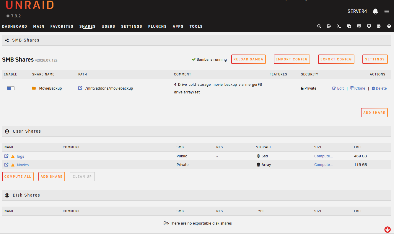

  9. Maybe this has been covered before, in case not, I have a mergerFS set I need to make a share for. I coudl do it via the SMB extra settings but that gives zero UI visibility to the share. Found your plugin and it fits the bill except one thing, it's location. I had it at the apparent default where it made a new tab. Which is an improvemt vs plugin settings etc. But I wanted it more co-located with the stock 7.3.2 "Shares" Figured out that with this adjustment I could put it literally inside Shares, along side the other 2 share groups that are stock. Your button locations re different locations thatn the stock sets but that's not a problem for me. It fits pretty nicely overall. The command I use is this in a script that makes a few checks to see if it's done already etc. sed -i 's/^Menu="Shares:0"$/Menu="Tasks:85"/' \ /usr/local/emhttp/plugins/custom.smb.shares/SMBShares.page Change that Shares:0 to Shares:3 if you want it after the stock 2 groups in Shares, I chose 0 to move it to the top. I'm doing it via /boot/config/go before the UI gets initiated, so a temporary fashion, but it works. And should survive an app update (depending on what's updated). I like i there, right where I'd look for share settings.
