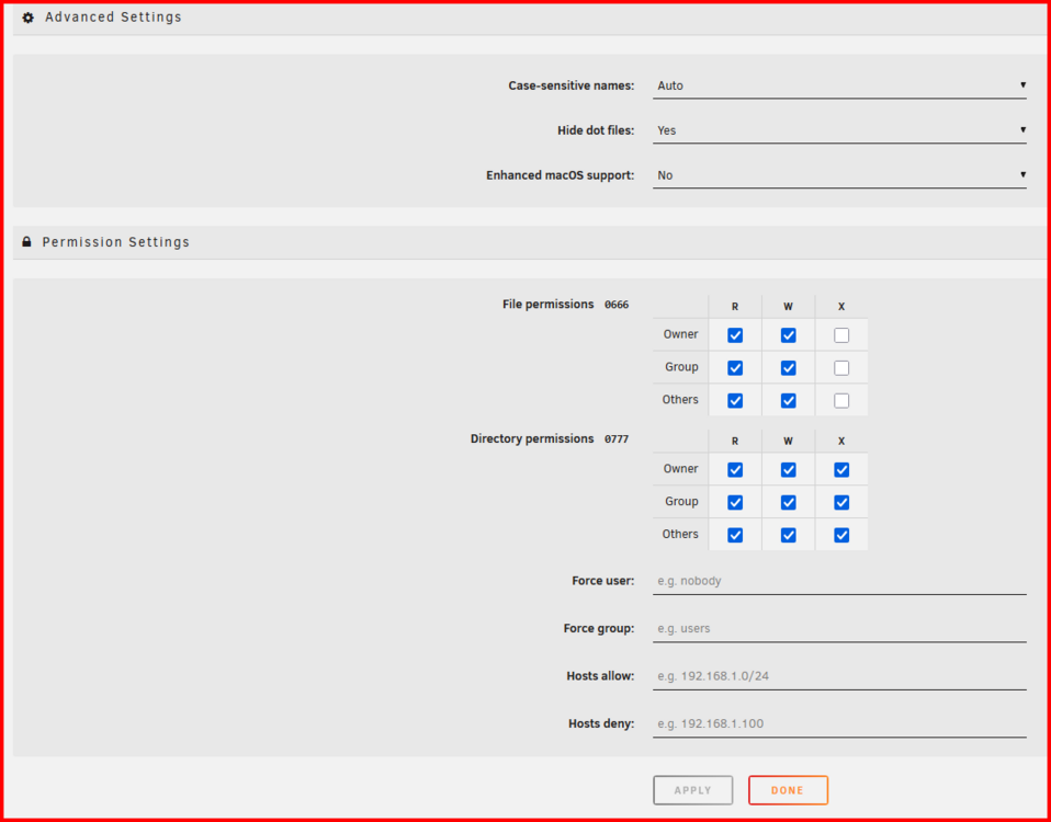

    Interest find! If, on the Edit page/tab, you switch from Basic View to Advance View, you get these additional settings. I did test and, with these settings I can get directories with 777 permissions

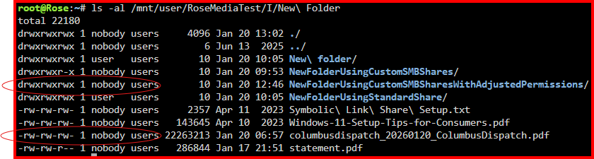

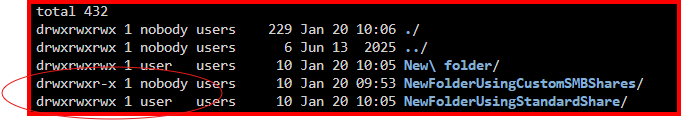

OK--- I just made a couple of quick tests and I observed this:
The standard Unraid permissions for directories are 777 and for files are 666. I did not do a lot of testing but it is possible that there may be some issues when people are accessing using 'Public' permissions. Unraid security setup and permissions are a bit funky and I would strongly suggest that you conform to their standard. (I can not remember for sure if 'nobody' is a member of the 'users' group.
Next item— Look at these two directories:
The directory names should indicate how they were created. Notice the one created by your plugin has 'nobody' as the owner whereas the one created using a standard Unraid Share has my SMB login name– user –as the owner. Notice that it also has the stand Unraid permissions. The owner of 'nobody' is not a real issue in this case but it can mask some access issues with the 'other' permissions. (I rue the day when I decided on using 'user' as my SMB login. It is not a problem in day-to-day usage but complicates things when I composing a reply on the forum! 🫤)

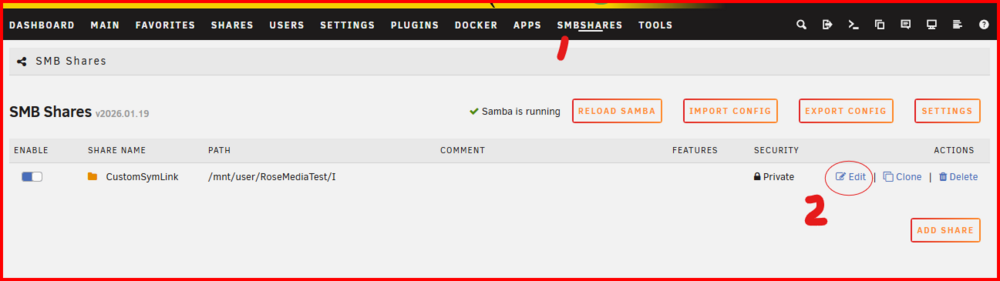

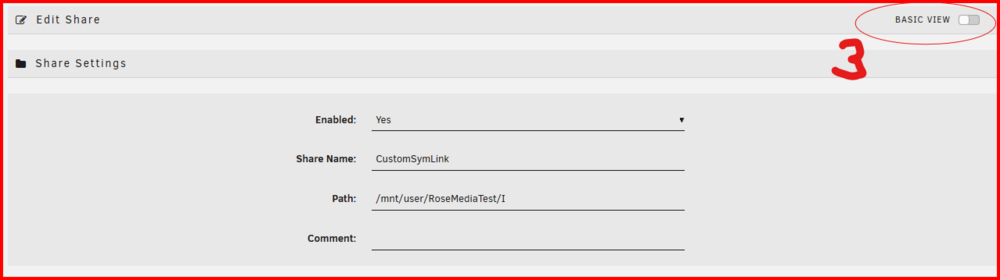

Interest find! If, on the Edit page/tab, you switch from Basic View to Advance View, you get these additional settings. I did test and, with these settings I can get directories with 777 permissions and files with 666 permissions. (I checked to add the write permission of 'Others' for both File and Directory.)
Looks like a simple solution. But I still think that the out-of-box permissions should be 777 and 666. Then if the user requires something different, they can make the changes required using these Advanced View Settings.
Demo of results:
@zapbranagann, Looking really good from my perspective!!!

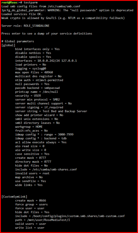

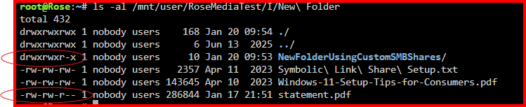

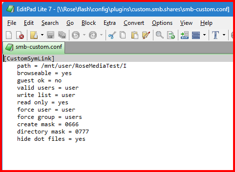

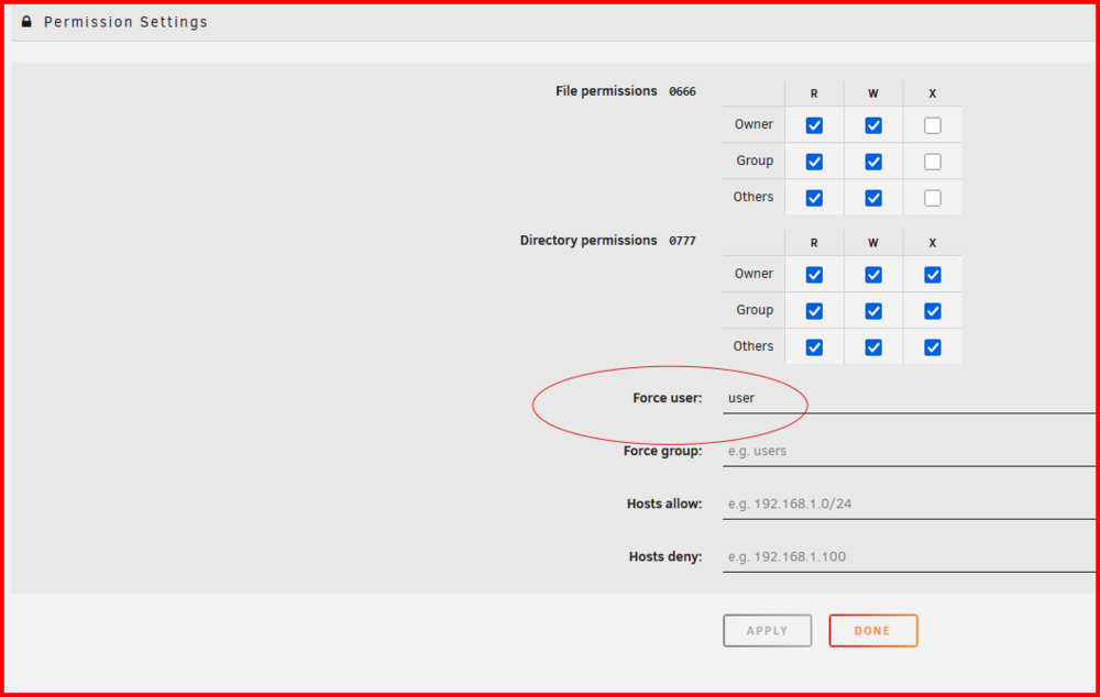

I found a problem. Forcing a user does not change a newly written file's owner to be what the 'Force user:' setting is. It still remains at 'nobody. (I tried two different valid Share Access users to verify this problem. I even restarted Samba...)
Edited by Frank1940
Thanks for the thorough testing, I'll take a look to see why it's not picking up that config change.
[EDIT] I just thought to clarify, I believe force user will only apply to file/folders created after the config is set, I assume that's what you meant by "newly written" but I figured it wouldn't hurt to confirm. [/EDIT]
So when I test locally, it seems to work for me. The force user and force group get written directly into the Samba configuration, can you check using the terminal/shell the configuration that's being generated?
The file /boot/config/plugins/custom.smb.shares/smb-custom.conf is the plugin's generated Samba config (included by main smb.conf). To check the actual Samba config being used:
cat /boot/config/plugins/custom.smb.shares/smb-custom.conf
And to verify whether it's being included properly:
grep -i "include.*custom" /etc/samba/smb.conf
You should see a list of shares each with the following format in (smb-custom.conf):
[books]
    path = /mnt/user/data/media/books
    comment = Books
    browseable = yes
    vfs objects = catia fruit streams_xattr
    guest ok = yes
    read only = no
    force user = zapbranagann
    force group = users
    create mask = 0664
    directory mask = 0775
    hide dot files = yes
Do your shares have the correct force user fields set? If so, that's the limit of what the plugin can do right now, and there might be something else interfering with the samba force user config.

Not sure what is going on.... Here is the output from testparm
In case you are not familiar with this tool, the [global] section is a list of parameters which have been changed from their Samba defaults. (If you run this program with the -v switch, you will get the output from every Samba parameter and its setting. Interesting to do if you want to see how configurable Samba is!)
Here is the output of the smb-custom.conf. (I have my Flash drive shared out– read-only –so I can look at the files on it from my Windows computer.)
I got it to work. I ended up stopping and starting the array. This, of course, forces a complete reboot of Samba. I could swear I had used your RELOAD SAMBA button BUT perhaps I didn't. I only remember that it seemed to happen in a fraction of a second.

I've pushed a new release which changed to drop-down fields for force user and force group to help remove potential errors/typos/etc. It now populates the valid users and groups from unraid (including system accounts) so it should work the same as the text input field without restricting what can be entered.
I downloaded the new release. I reset the 'user' drop-down field to 'None– use connecting user' and it worked just fine.
I did notice that the drop-down option lists are long and include every user and group on the entire system. This may prove to be overwhelming to many folks but lets wait and see what happens. I am assuming that you have made the defaults using the "None– using..." entry. That will probably work just fine for 99.999% of all users!

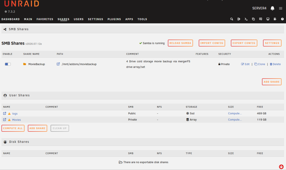

One more observation. There is no link to the built in Unraid File Browser. Let me give you examples.
For User and Disk Shares (Oval shows link to File Browser) :
For Mounted Shares:
For Array Devices:
I have no idea how difficult it might be to add in the link to the Unraid File Explorer but it would be a very nice addition if it could be done.
