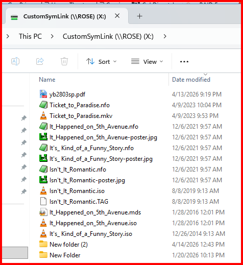

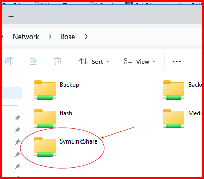

What will happen is that once you set up a custom SMB share using the plugin is that custom share will show up in the "root" of the server in Windows File Explorer. To show what this looks like, here is a screen capture of my test server in Windows File Explorer:
I have circled the Custom SMB share (SymLinkShare) that I setup to test this plugin out when it was being developed. I can then map that share as a mapped drive in Windows.
If you still confused install the plugin and test it out. I think you will find that it will do exactly what you are looking for. Below is a screenshot of that share mapped as drive X: on my desktop:
You can use any letter between A and Z to map the drive as long as it has not been previously assinged. It seems to be a convention to start at the end of the alphabet for mapped drives as Windows starts at the beginning to assign drive letters to both permanent and temporary drives.

Nope, they are going to show up there regardless of how you create the shares. (I thought you were trying to isolate an existing file tree by user rather than making a less cluttered display.)
Mapping the shares onto the individual PC according their 'need-to-know' is the only way I know to hide the details.
