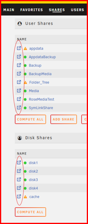

On 1/21/2026 at 11:46 AM, Frank1940 said:

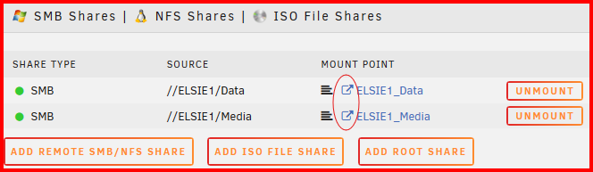

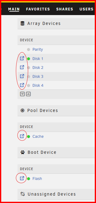

One more observation. There is no link to the built in Unraid File Browser. Let me give you examples.
For User and Disk Shares (Oval shows link to File Browser) :
For Mounted Shares:
For Array Devices:
I have no idea how difficult it might be to add in the link to the Unraid File Explorer but it would be a very nice addition if it could be done.

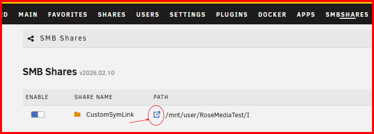

It shouldn't be too hard to implement that, I'll check how it's done in those other components.
[EDIT] I've added the File Browser link in v2026.02.10. You'll now see a browse icon next to each share's path that opens Unraid's built-in File Browser.
Edited by zapbranagann

@zapbranagann, Nice update to add in the link to the Unraid File Browser:
Everything seems to work fine.

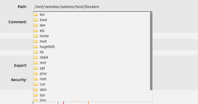

further you limit the share where I'm forced to click the folder paths.
Where I want to copy and paste the long list instead of click click click to get to the sub folder...

I've updated the plugin to allow you to paste paths in so you aren't restricted to click only browsing. I also checked the current plugin code and I don't see how it could erase/overwrite your existing smb-extra file, however the older versions of the plugin did do that and there was a left over script 'generate-config.sh' which I've removed. Would you be able to check if the problem is still happening with the latest version? If so, I'll need some more details so I can reproduce it and come up with a fix.

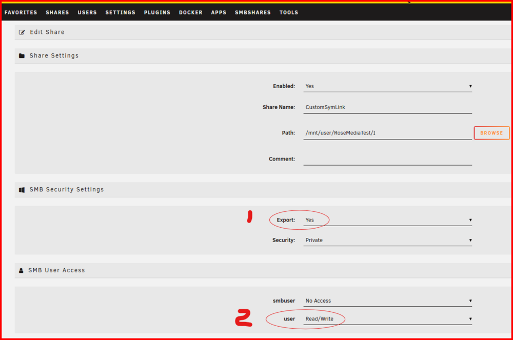

I suspect that you are not setting up the mapping properly. I have a share setup using This plugin as shown in the screenshot.
Now to use this share, I have to click on the "Edit" (which is off to the right of the above screenshot. That gives me this screen:
I have to export this share (# 1) and set the permissions for the various users (# 2).

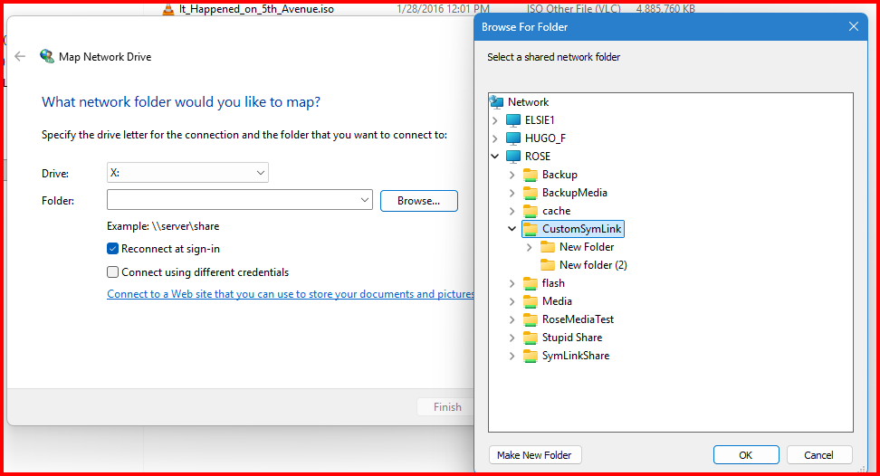

Then I set up the mapped drive as shown below:
Notice that I can see all of the shares which have been exported by this Unraid server and the one (CustionSymLink) created by this plugin is one of the ones listed. If you don't see this share, you can not map to it...
Edited by Frank1940
Thanks, yes I do see the RetroArch folder (which is the one created from this plugin) available to map to a drive in windows. So I would have to map the RetroArch SMB Share (/mnt/user/Emulation/RetroArch) as a network drive or location in windows and then when I access the share through that drive specifically it will use the permissions defined for the SMB Share.
But if I have a share called Emulation for the parent directory (/mnt/user/Emulation/) mapped to a separate drive in windows and I access the share through that drive and then navigate to the RetroArch subdirectory, my permissions will be based on the permissions of the Emulation share, not the RetroArch SMB share.
I didn't realize I had to map the SMB share to its own network drive and was hoping it would just allow me to grant write permission to the RetroArch subdirectory for a user under their existing mapped drive X:\ to the Emulation (parent directory) share. I actually don't mind having a separate share in Unraid for RetroArch and taking it out from being a subdirectory of /mnt/user/Emulation/, but within Windows specifically I was hoping to see the RetroArch folder/share as a subdirectory to the X:\ drive mapped to /mnt/user/Emulation/. I will look into that, but I think I misunderstood the use case for this plugin.
YES!!! All the permissions are 'attached' in that share that you setup using the Custom SMB Shares plugin. The permissions in the other share/path remain unchanged.
I realize that it is bit hard for most of us to get our heads wrapped around what is going on in this situation. Let me point you off to another thread which has a bit more information about what is happening behind the scene.
https://forums.unraid.net/topic/137806-creat-a-user-share-containing-a-portion-of-another-user-share/#comment-1251067
Edited by Frank1940
