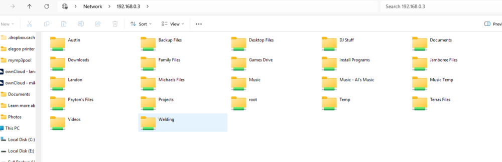

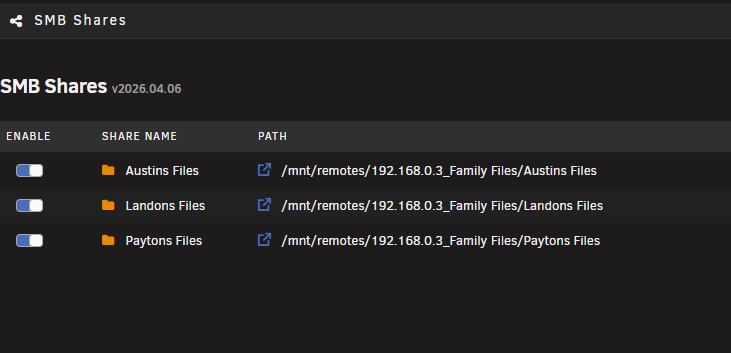

@zapbranagann
hi i trying to add a couple remote shares
but i get error message
This path is managed by Unassigned Devices (/mnt/disks, /mnt/remotes), which already provides SMB for it. Use a path under /mnt/user instead.
and i dont really understand what its talking about as i need a share
called 'Home Videos' and points to /mnt/remotes/192.168.0.3_Family Files/!Home Videos/
and 'Pictures' and points to /mnt/remotes/192.168.0.3_Family Files/!Pictures/
so i not sure why i cant do it and dont truly understand the error or how the UD page can create those links to show up as custom Samba Shares so i confused
i also need to add more user shares like
'Michelles Files' and points to /mnt/remotes/192.168.0.3_Family Files/Michelles Files/
'Larrys Files' and points to /mnt/remotes/192.168.0.3_Family Files/Larrys Files/
'Jason Files' and points to /mnt/remotes/192.168.0.3_Family Files/Jasons Files/
i install this app to be able to do this stuff... if i can no longer do this.. is there a way to down grade older version or alter this smb shares code to remove the lock out so i can do what i need it to do
what are the work arounds now that i need to make these work now?

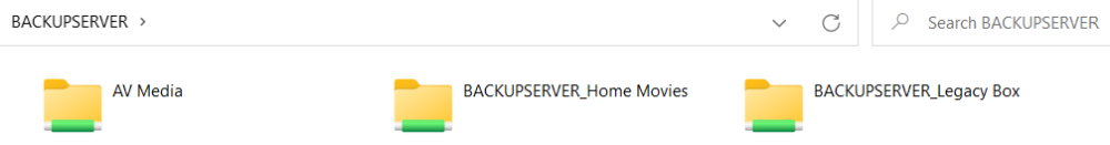

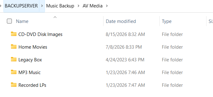

There is way to trick UD and get it to do what you want. I have a UD disk mounted:
With file contents:
I add remote shares for the UD disk folders I want to share:
You can change the name of the share by changing the "Mount Point". Be sure to turn on the share switch.
So then you see this in the Windows Shares:
When you add the Remote Share, you have to enter the share folder manually because the scan for the shares only shows the top level share. You can add any folder on the UD disk.
You can do the same thing to a remote share by adding another remote share that points to the remote share sub folders.
  • Add a main remote share "192.168.0.3_Family Files/" with Mount Point "192.168.0.3_Family Files". Be sure to enable sharing.
  • Add a remote share "192.168.0.3_Family Files/!Home Videos/" with Mount Point "Home VIdeos". Be sure to enable sharing.
  • Add a remote share "192.168.0.3_Family Files/!Pictures/" with Mount Point "Pictures". Be sure to enable sharing.
  • And any others you want.
You will then see "Home VIdeos" and "Pictures" in the network shares.
You need to add the sub folders manually in the add a remote share dialog.

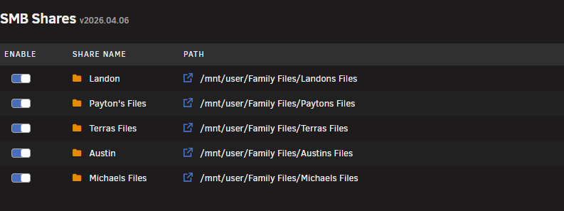

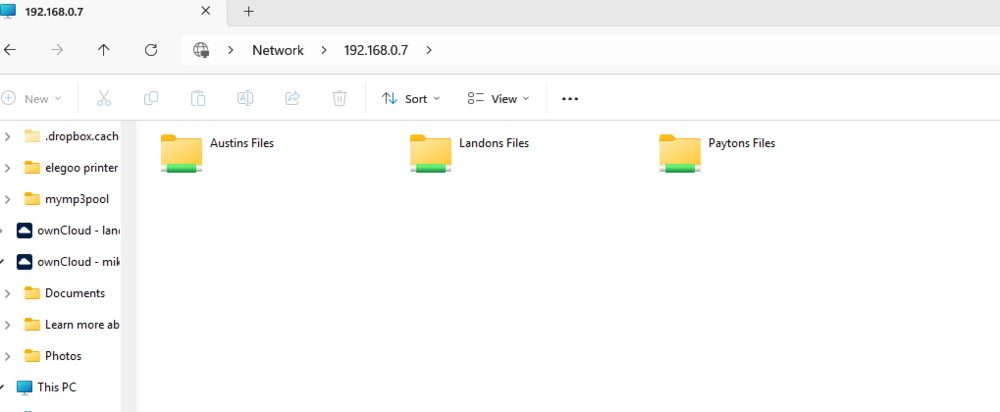

@dlandon i dont think i doing it right.. as what i had before was working fine till the programer had to break it so i cant do what i did before
so i tried what you said kinda as i was kinda confused.. what i did was add server 192.168.0.3/Family Files and then i tried Share Folder Landons Files but it went white i not sure if thats because i already have the share already..
and i dont know how you mount a remote share to point to the remote share as it asks for the ip address of the server..
but this is what i have .. as i need to add more users and the custom shares was a good program but not so much now since the reason i liked it is now locked out .. so i dont get it.. and he didnt provide instructions how to do what is grand fathered in how you do it in UD shares.. so i lost
