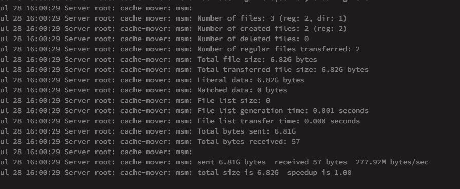

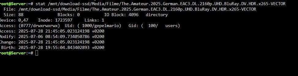

  8. Sorry, Unfortunately, I am not able to understand everything you wrote. Can you please check my scrennshots ?In in my opinion the amateur should have been deleted yesterday.

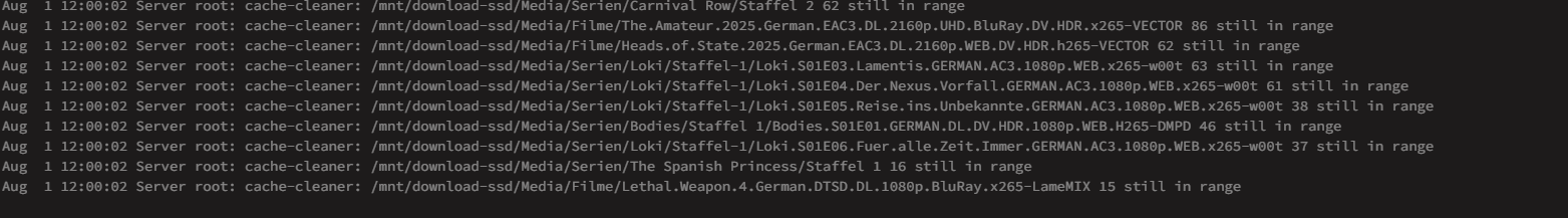

  9. Ok, the cache cleaner is not working at all. Every file is " still in range" disks="" pool="download-ssd" subfolders="Filme Serien" filetypes=".mkv" wait_todo="120" move_excl="yes" move_excl_list="/mnt/user/system/mover/mover_excl.txt" move_tune_list="/mnt/user/system/mover/mover_ignore.txt" rsync_mode="folder" rsync_move="" rsync_copy="rsync --stats -azht --mkpath" switch_mode="switch" time_keephours="24" time_keephours_sub="720" subfolder_keep_sub="" target_keephours="user0" use_recycle="no" recycle_folder=".Recycle.Bin" unraid_note="Yes" unraid_syslog="yes" script_cron="*/5 * * * *" clean_cron="0 */12 * * *" mediaserver_type="emby" mediaserver_url="http" mediaserver_host="192.168.178.2" mediaserver_port="8096" mediaserver_key=" mediaserver_only="only" script_cron_state="started" clean_cron_state="started" exclusions="" rewrite_source="/media/Media:/mnt/user/Media"

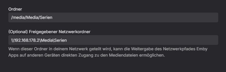

  12. root@Server:~# wget -q -O - "http://192.168.178.2:8096/emby/Sessions?api_key=2e5701c3fc314112b67b4f10c6483e7b" | \jq '.[] | {NowPlayingItem: .NowPlayingItem.Path} | select(.NowPlayingItem!=null)' | \sed 's|{||g;s|}||g;s|"NowPlayingItem":||g;s|"||g;s|^[ \t]*||;/^[[:space:]]*$/d' | shuf -n 1 /media/Media/Filme/The.Surfer.2024.German.EAC3.DL.1080p.BluRay.x265-VECTOR/The Surfer (2024).mkv
  13. Did you mean the attachment ?
