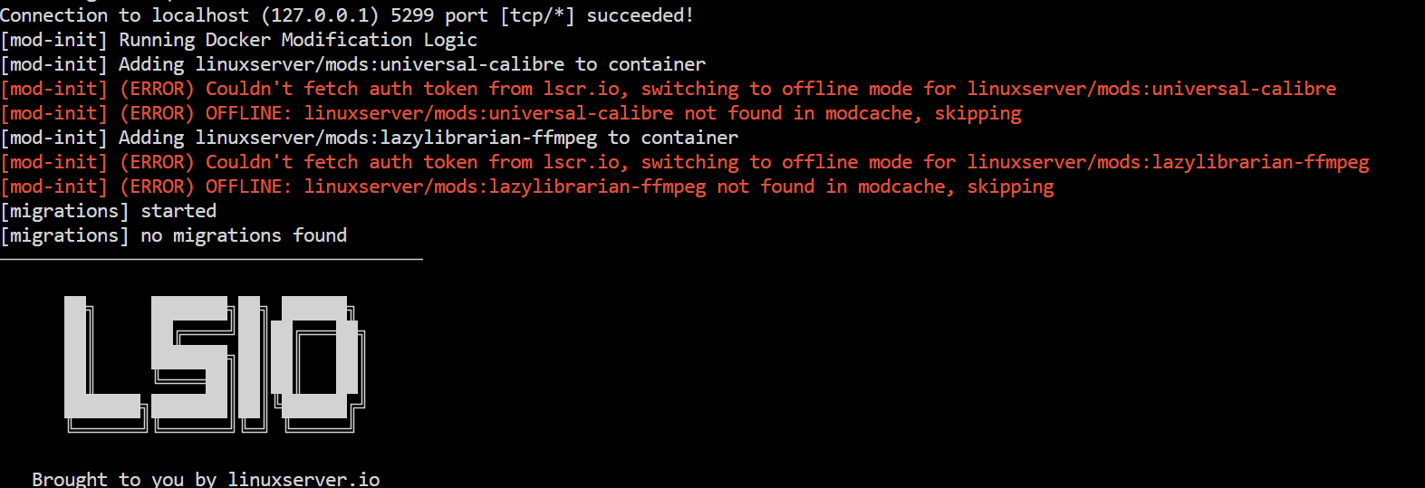

  11. I have trouble with the DOCKER MOD for Calibre being added to the container. I have followed the documentation and added the DOCKER_MODS environment variable with the value linuxserver/mods:universal-calibre|linuxserver/mods:lazylibrarian-ffmpeg The config page in LazyLibrarian for Calibredb import program has also been set to /usr/bin/calibredb When the container is starting I get the below errors. Using the console for the same container I can with no problem access the internet (tried e.g. simply by curl ifconfig.me). I have verified the files and the /usr/bin/calibredb folder is in fact missing in the container, which of course makes the Calibre import function to fail. Any ideas why this is the case?
