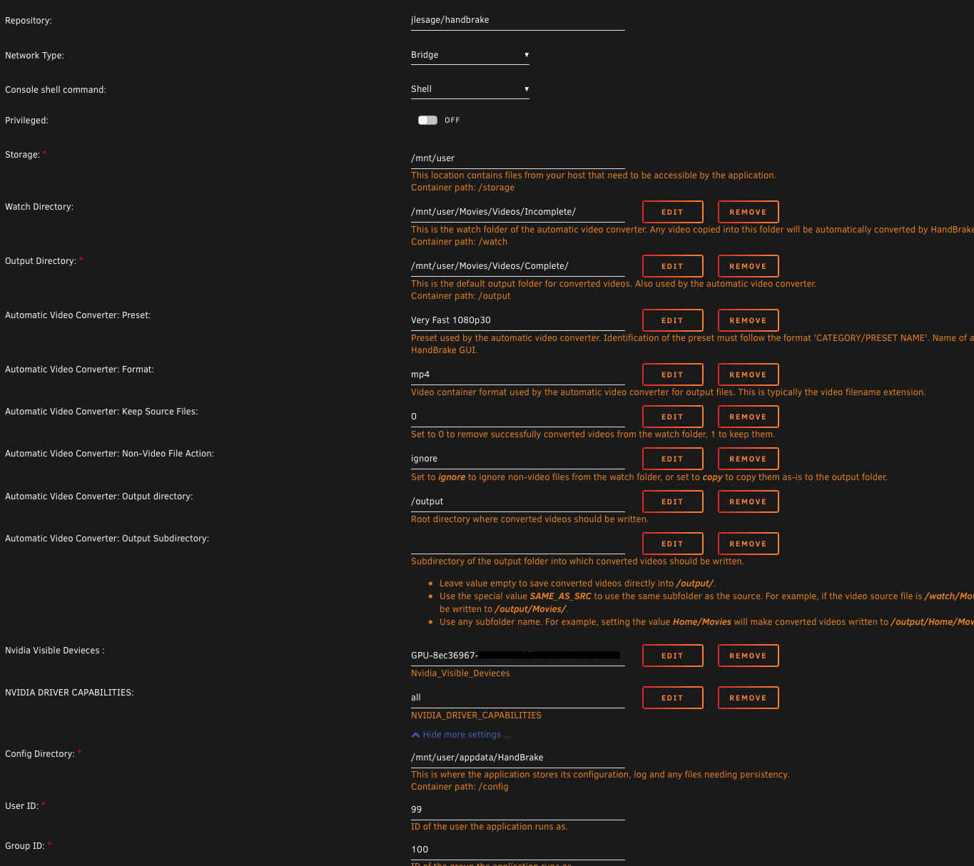

So I just wanted to see if anyone could help me with Handbrake to do GPU transcoding? I can't figure out why its not working. I am running 1.3.3 jlesage/handbrake.
Have you also added the parameter '--runtime=nvidia' to the Extra Paramerters when you switch on the advanved view in your template?
Please keep in mind the application itself also has to be compatible with Nvidia and when it's not compiled with Nvidia support then it can't work.

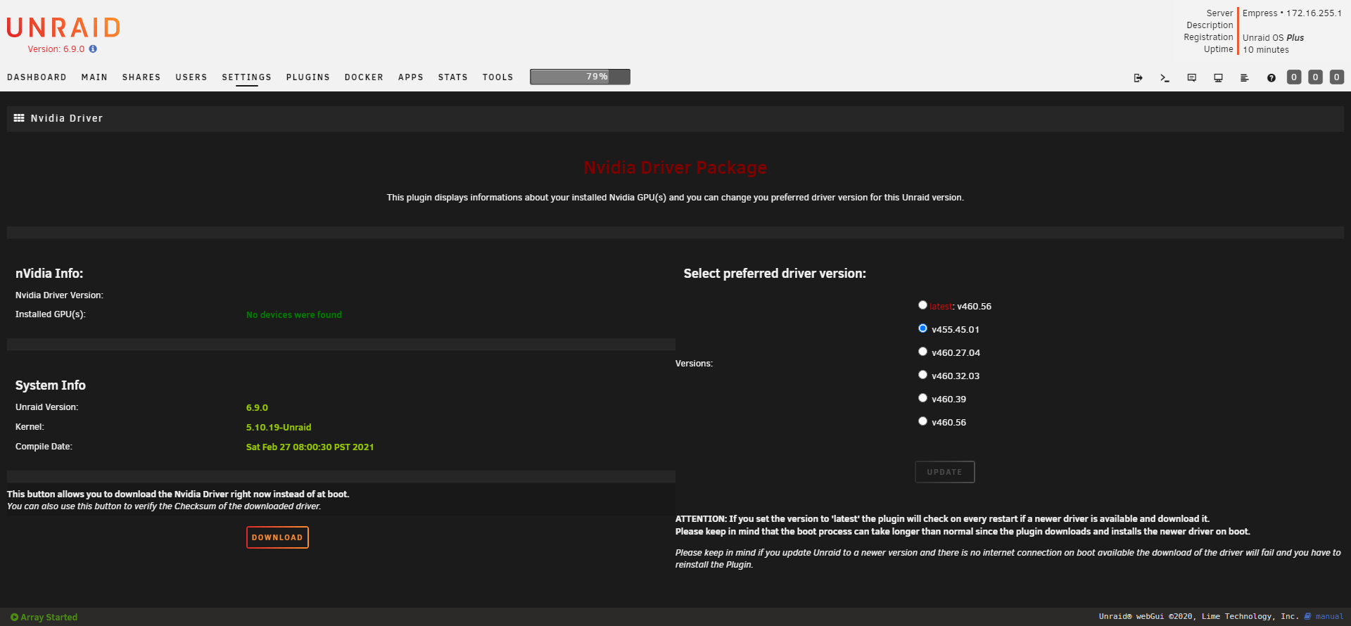

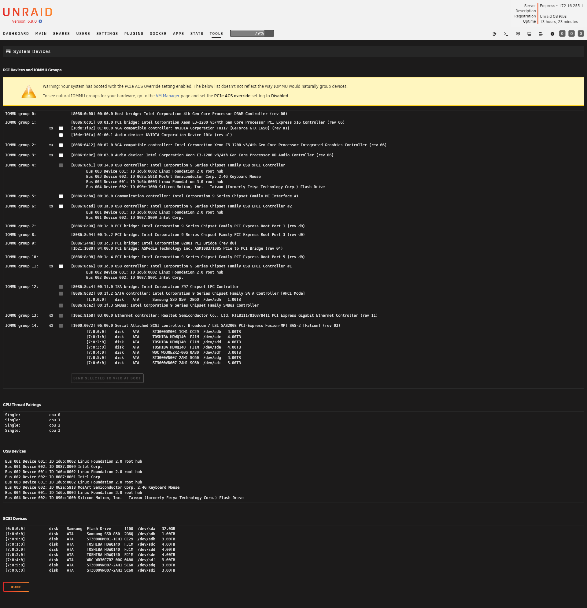

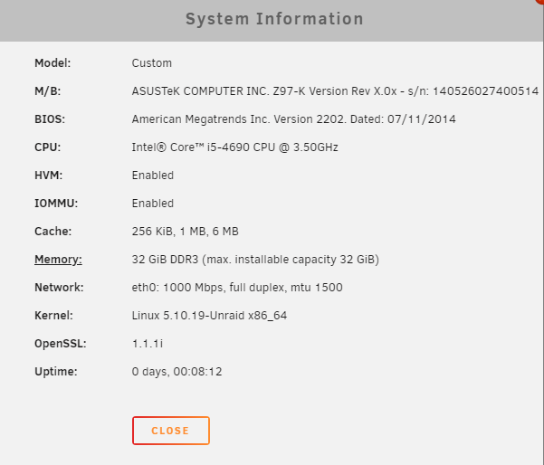

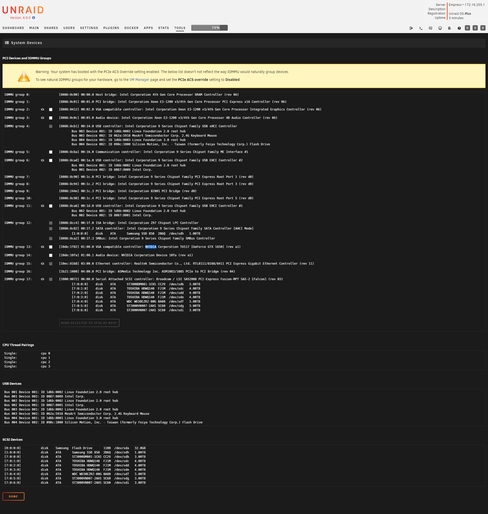

I am having trouble getting this plugin to detect my Nvidia Geforce GTX 1650.
I have tried all options for ACS Override as well as trying the different versions of the driver which show up in the plugin page (I have checked btw, and all these drivers should be compatible with the card).
On an earlier version of Unraid (pre 6.9) the same graphics card was working and I had even managed to get the Plex container to make use of it - but it stopped being detected one day out of nowhere.
Attached are various screenshots, showing the plugin page, IOMMU groups, and nvidia-smi output for each of the different ACS Override options, and additionally one image showing the system info.
What can I do to troubleshoot and fix this? The card works fine in another machine (Windows 10).
Thanks
Dan
This would nothing do to the plugin and the way that the driver detects the card.
Without the Diagnostics (Tools -> Diagnostics -> Download -> drop the downloaded zip file here in the text box) I really can't tell what's the problem here.
EDIT: Also I would recommend to upgrade to 6.9.2 first.

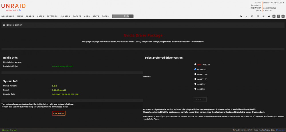

Ok thanks - I have upgraded Unraid to 6.9.2 and ACS is back on disabled since you said that doesn't matter.
The plugin still shows "No devices were found" and nvidia-smi says the same.
Diagnostics attached
Thanks
Thanks

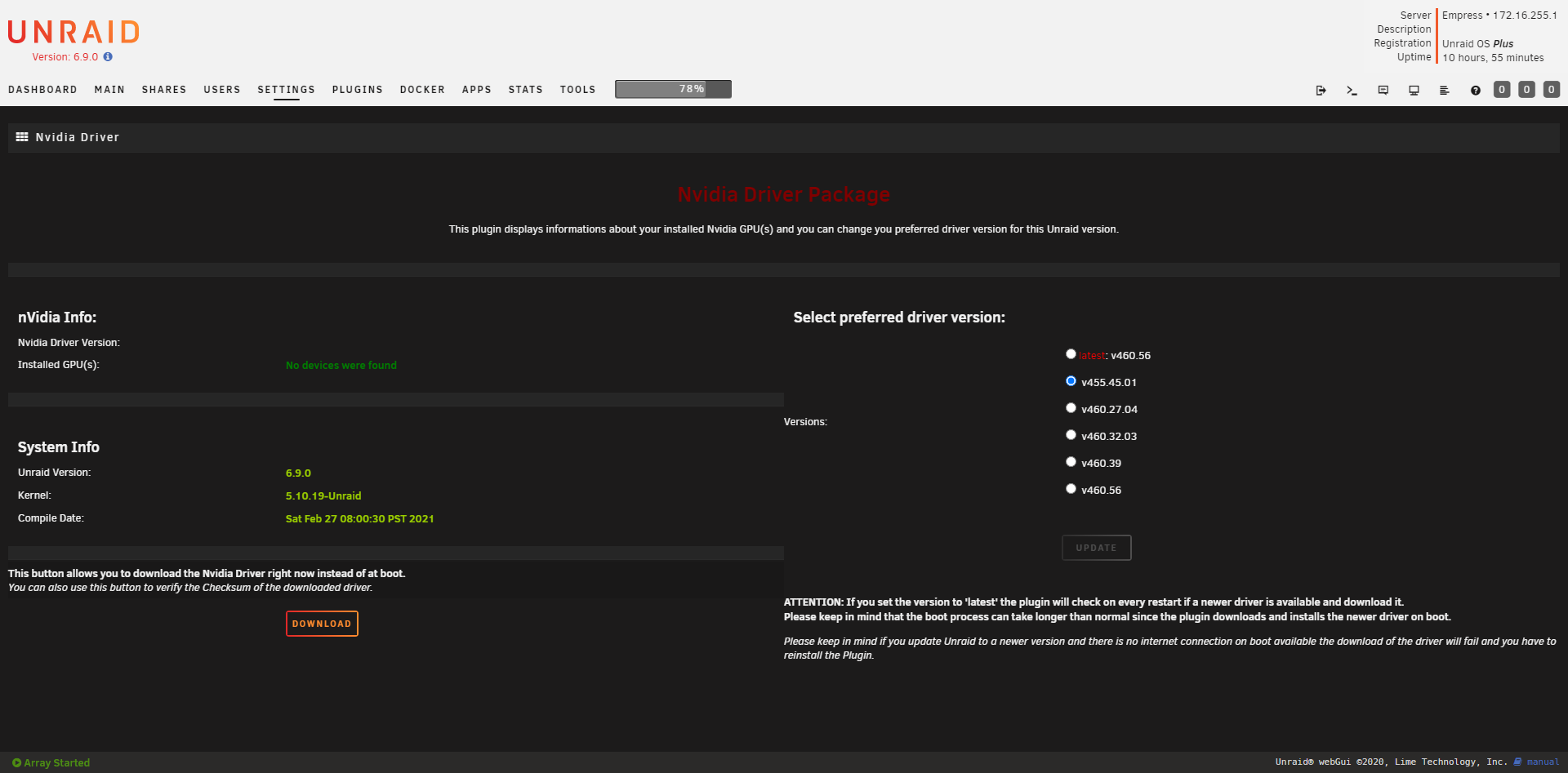

Unfortunately that made no difference to the problem - still can't find the card according to the plugin page and the nvidia-smi output. I have changed my driver selection to use the "Production branch" (I'm doubtful it makes any difference here but once it's working I want to stick to stable builds only).
New diagnostics attached in case that's needed again. The server has been restarted twice - once after updating the plugin and once after changing the driver selection. The diagnostics are from the most recent boot.
Thanks
Dan
empress-diagnostics-20210527-1805.zip

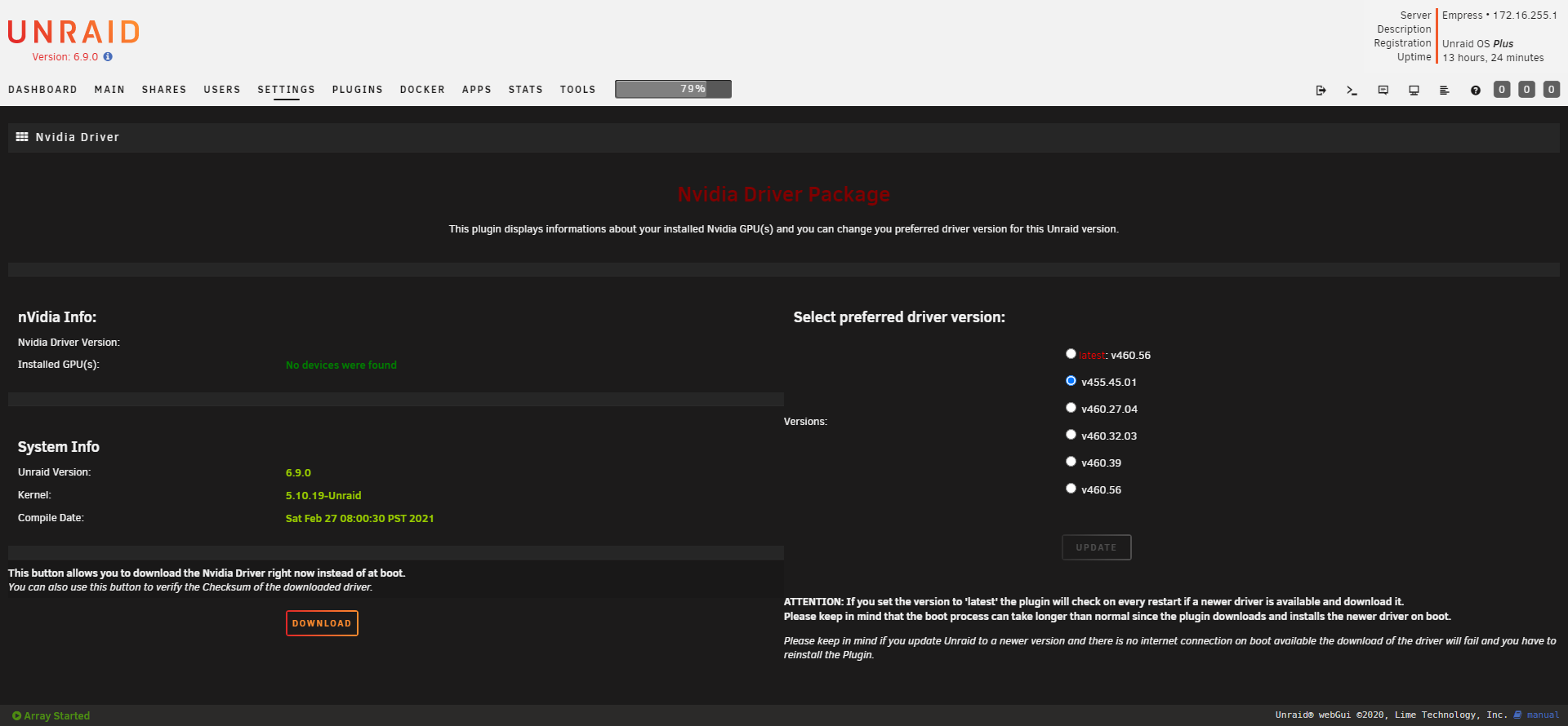

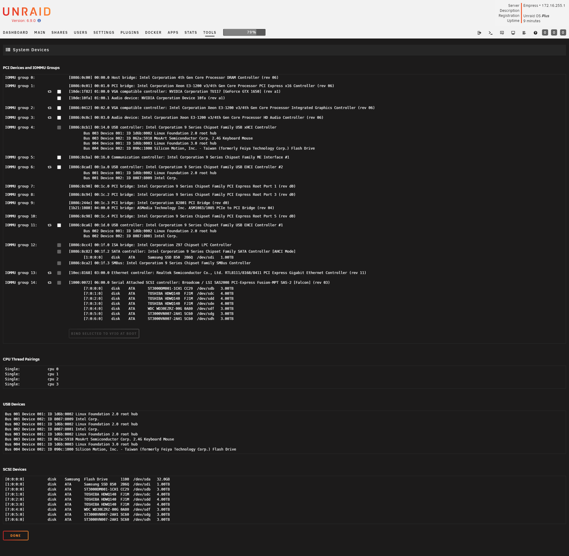

This seems like a hardware related issue, are you sure that your card get's enough power from your power supply?
Please make sure that you enable above 4G decoding in your motherboard.
Is it eventually possible that you put the card in a system where it works under Windows, create a new Unraid USB Key with a Trail key (don't start the array), install the CA App, then install the Nvidia Driver plugin and after that look if the card is recognized on this system (just to be sure that it's not a issue of the hardware combination cpu/motherboard/gpu?
The last thing that you can do is to reset your BIOS (only if you know how to set back everything back so that you can boot Unraid).
Also make sure that you boot Unraid with Legacy Mode and not UEFI.
The card only takes power from the motherboard and it SHOULD be enough but that's something I need to check - maybe with all the hard drives I've added since the time it worked has caused a shortage of power?
Not sure what above 4G decoding is so will look into that.
It's a pain in the butt but yes if it comes to it I have another system I can use to temporarily run unraid and test the card that way.
The BIOS has been reset at least twice since I have been having the problem so I'm not convinced I could make a difference doing it again, and I am booting with Legacy Mode already so that's definitely not the issue.
I will try the 4G decoding, check the power situation, and try the card in a temp unraid server and get back to you.
Thanks

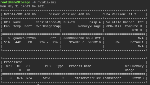

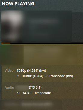

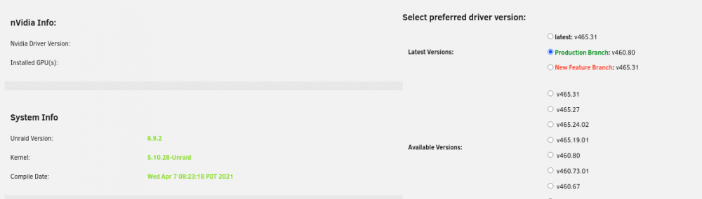

I've run into an issue I can't figure out.
I noticed my Plex server stopped using hardware transcode, so it was sucking up the CPU instead.
When I added "--runtime=nvidia" to the extra parameters in the docker from Linux Server guys.
I was using the latest version of the driver (v465.31), and the UUID of the GPU was showing.
So I decided to go the for the production version instead, and rebooted the server.
Now it's no longer showing the UUID of the GPU.
I can't figure out what has changed, and I'm not sure how to troubleshoot it.
Any ideas?

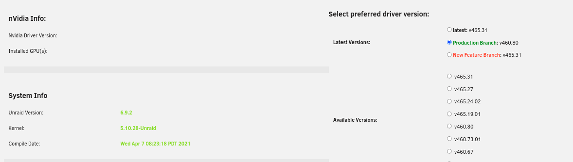

Please post your Diagnostics (Tools -> Diagnostics -> Download -> drop the downloaded zip file here in the text box), otherwise I can't say anything...
What does it show instead?
It's just blank:
I've added the diagnostics below.
nanostorage-diagnostics-20210531-0820.zip
2 hours ago, Nanobug said:
It's just blank
What is the output of 'nvidia-smi' in the console?
Thank you! :)
EDIT: Can you try to do a 'modprobe nvidia' (without qutoes) from a terminal after you tried the command 'nvidia-smi' from above?
Nothing:
This:
Nothing:
This:
It seems that the driver isn't installed.
Can you try to press "Download" on the Plugin page and tell me what happens?
It popped up with a new driver, so I need to reboot. But right now (before the reboot) it says:
Gonna reboot, and get back to you in 5-10 minutes.
EDIT:
It's working atm...
Edited by Nanobug
It works now.
I did verify the checksum before I posted here, since I was talking to the Linux Server guys on Discord.
It's hard to tell what worked, since it had an update to the production driver at the same time.
Anyway, thank you for your help, as always :)

I only noticed it since it randomly saw it CPU transcoded on my Plex server.
1 minute ago, ich777 said:
That's a good question, some cards display more than others do, what is the output from 'nvidia-smi' now?
Eventually make a short post in the GPU Statistics plugin support page.
Looks fine to me, and it's transcoding as well:
