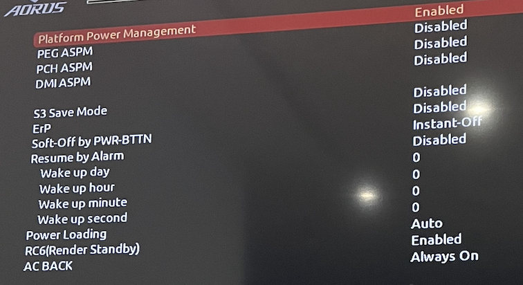

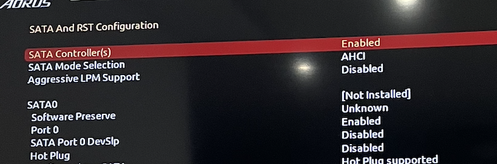

  8. Maybe you are right, but the only power saving settings I found are these both and they are disabled... All three ASPM Settings are manually off and the LPM Support too Do you have an other idea?

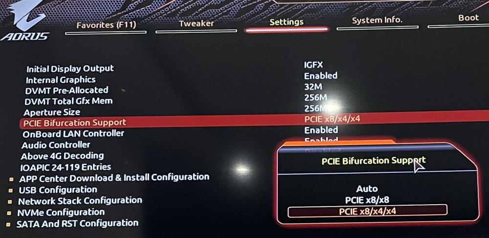

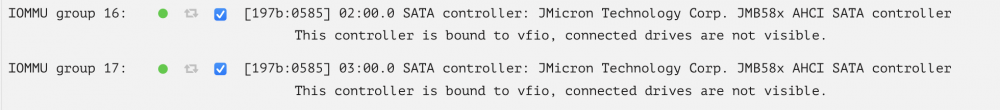

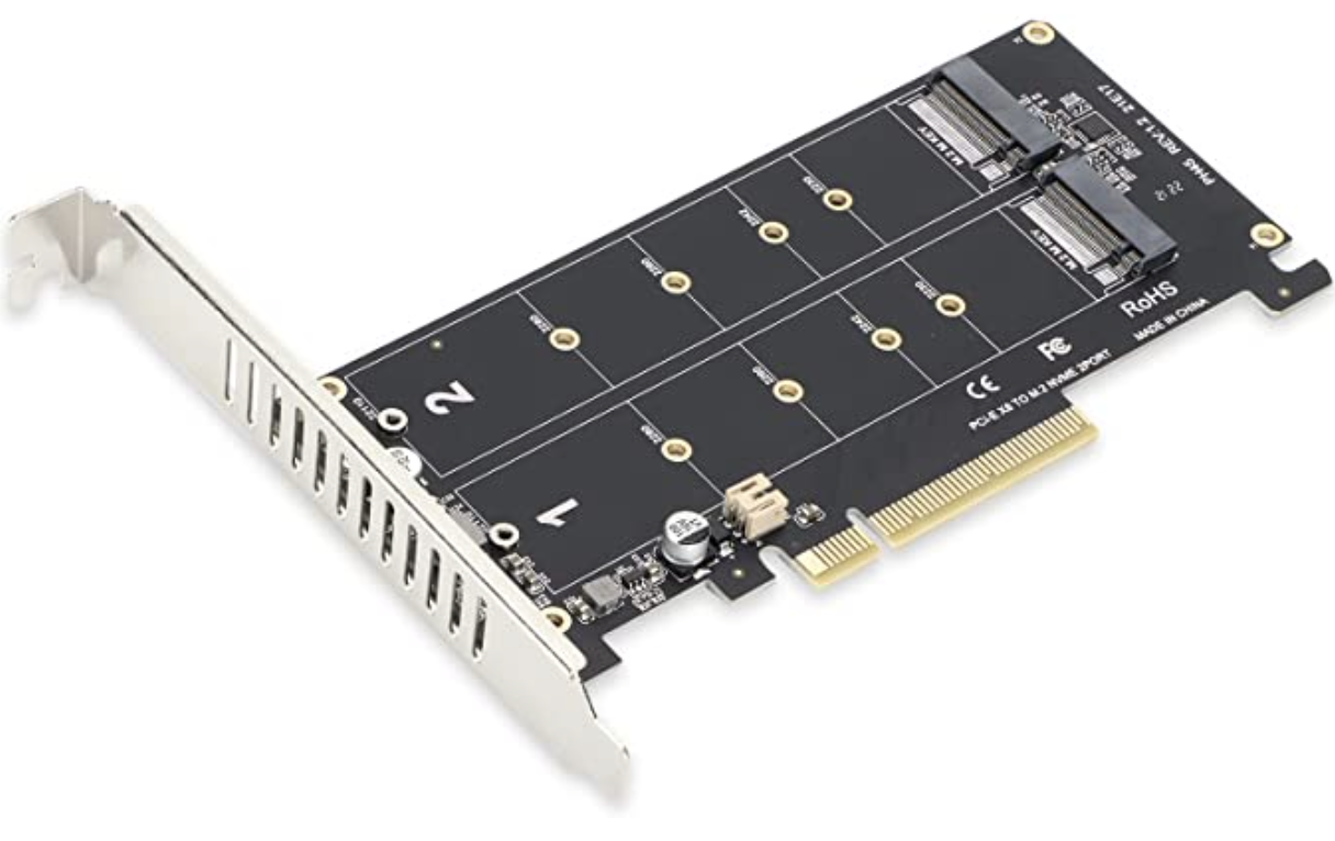

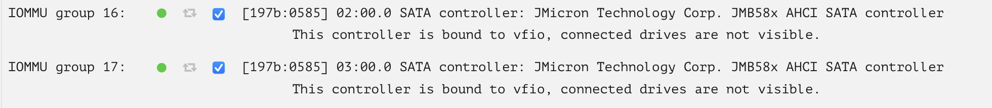

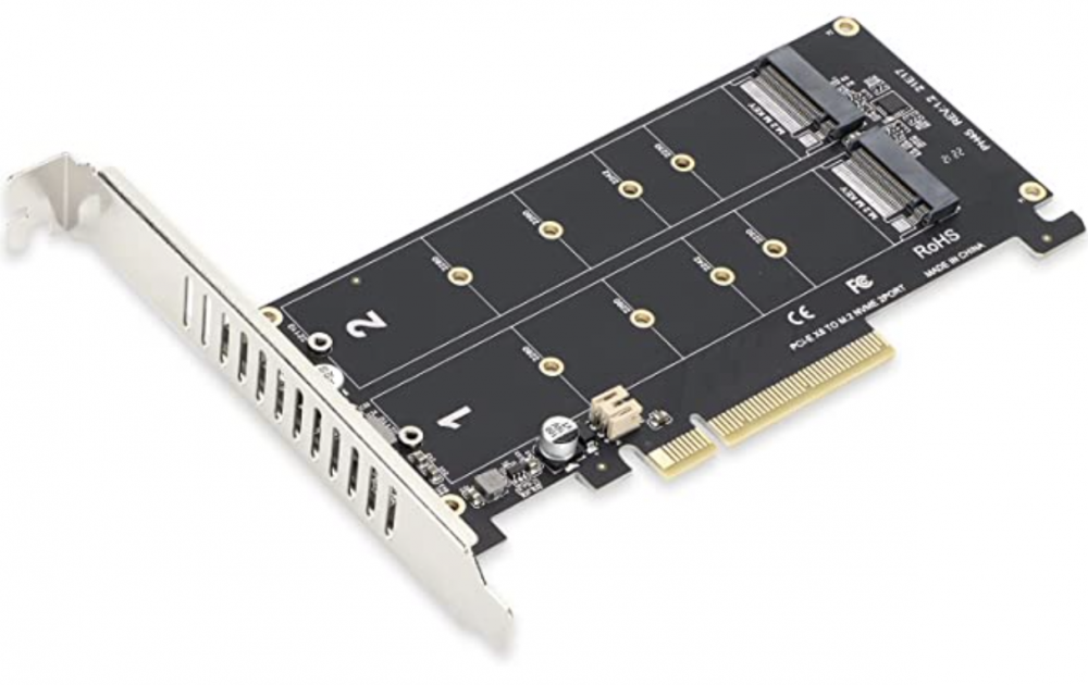

  10. Hi @all, my mainboard is a Gigabyte z590 Aorus Master which has 3x mechanical x16 PCIe Ports. The first and the second one is connected to the CPU and the third to the chipset. For the first both i can configure the bios to these bifurcation modes: Auto, 8x/8x and 8x/4x/4x. I selected 8x/4x/4x and put only in the second slot these PCIe to 2x M.2 Adapter Card in: Dpofirs Adapterkarte mit 2 X 32 Gbit/s Erweiterungskarten, Dual M.2 NVMe SSD zu PCIE X8 M Key Festplattenkonverter Leser Erweiterungskarte, Unterstützt Full Speed NVME SSD/M.2 PCIE(ph45) In these PCIe Adapter I would connect 2 of these JMB585 SATA Controller cards with 5x Sata ports each. Unraid itself detects all fine. Both JMB585 are shown correctly and the connected HDD's will also shown and accesable: (in this picture the HDD's were not shown because they are bounded to VFIO for passing through to a VM) The problem I have is when I passthrough both devices to one and the same vm I get the error: internal error: Unknown PCI header type '127' for device '0000:02:00.0' I also tried to play with these arguments in the syslinux config at the boot: vfio-pci.ids=197b:0585 or xen-pciback.hide=(02:00.0)(03:00.0) which I had from this thread because of the same Vendor ID of the both JMB585 But still the same Error 127... When I go with the mouse in the system devices over the first JMB585 this pops up (maybe one other an other person know what to get out of this information): Inside the VM and its template I passthrough the devices like this: <hostdev mode='subsystem' type='pci' managed='yes'> <driver name='vfio'/> <source> <address domain='0x0000' bus='0x02' slot='0x00' function='0x0'/> </source> <address type='pci' domain='0x0000' bus='0x02' slot='0x00' function='0x0'/> </hostdev> <hostdev mode='subsystem' type='pci' managed='yes'> <driver name='vfio'/> <source> <address domain='0x0000' bus='0x03' slot='0x00' function='0x0'/> </source> <address type='pci' domain='0x0000' bus='0x04' slot='0x00' function='0x0'/> </hostdev> <memballoon model='none'/> </devices> </domain> I think here is all fine and like the way it should be done... //EDIT: The freakiest part of the things: Here it should be added that it did not work all the time, and I just left the server on for 1 hour or so. I tried it again and it starts the VM... So slowly I despair of the sense here. Could it be that after an unraid, i.e. host reboot, it takes a while until it stops addressing the PCIe devices and they virtually "go into standby" so that they lose the "already booted status"? I shut down the VM afterwards and could restart it immediately without any problems... buuuut when I did Unraid itself restarted and I get again error 127. After many try I can not reproduce this described scenario... At this point I have to give up and will be happy if you guys can help me! Thanks a lot for your time and reading my problems!!!

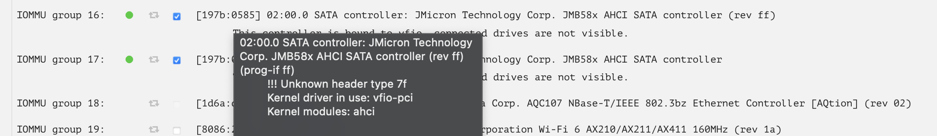

  11. Sonst noch irgendwelche Tricks auf Lager? Habe die Kiste nun 2 mal neugestartet und einmal 30min und einmal 60min gewartet. Ohne Erfolg. Somit war das irgend so ein Zufallsding, das es vorhin einmal funktioniert hat. Umgesteckt wurde nichts. Ebensowenig an den Bios Settings oder ACS Override Settings was geändert. //EDIT: Die beiden JMB585 haben ja die selbe Verdorr ID. Wenn ich mit der Maus über den ersten gehe erscheint folgende Info. Vielleicht hilft es ja: Bei den USB Geräten, sofern diese die selbe Verdor ID haben gibt es ja auch Probleme und da wird mittels folgendem Workaround getrickst. Dies lässt sich aber auf PCIe Devices nicht ableiten nach meinem Verständnis: VM USB PASSTHROUGH MULTIPLE DEVICES WITH THE SAME VENDOR/PRODUCT

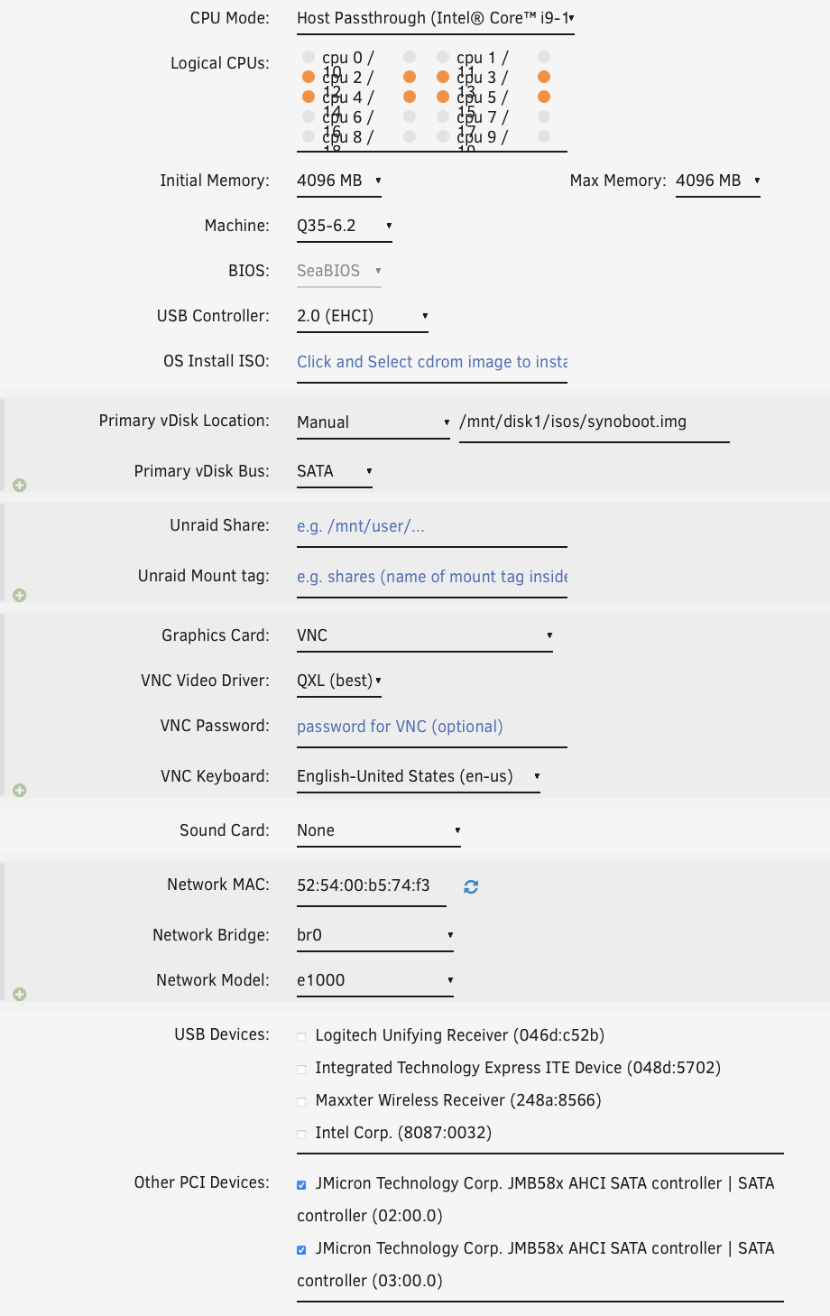

  13. Hi @all und Hi @mgutt, aus dem Thread mit den 20 bzw. 24 Sata Ports Erweiterungskarten hast du ja gelesen, dass ich ein PCIe zu M.2 Adapter und darin 2 M.2 zu 5x Sata Controller mit jeweils einem JMB585 Chip zum testen da habe. Die Windows VM läuft weiterhin wie oben beschrieben mit dem angepassten Bios ROM ohne Probleme. Parallel beides zum laufen bekommen habe ich nicht. Somit habe ich aktuell alle PCIe Devices entfernt und nur die neue Adapterkarte mit den beiden JMB585 Controller im zweiten (der beiden direkt an die CPU angebundenen Ports) verbaut und diesen in den Settings auf x8/x4/x4 eingestellt. Damit kann der zweite Port beide Controller erkennen und zeigt in Unraid auch brav beide an - ebenso die daran angeschlossenen HDD's. Beide Controller habe ich an VFIO gebunden und ebenfalls in der Syslinux Config geblacklistet. Ebenso habe ich diese an die VM angehangen. <hostdev mode='subsystem' type='pci' managed='yes'> <driver name='vfio'/> <source> <address domain='0x0000' bus='0x02' slot='0x00' function='0x0'/> </source> <address type='pci' domain='0x0000' bus='0x02' slot='0x00' function='0x0'/> </hostdev> <hostdev mode='subsystem' type='pci' managed='yes'> <driver name='vfio'/> <source> <address domain='0x0000' bus='0x03' slot='0x00' function='0x0'/> </source> <address type='pci' domain='0x0000' bus='0x04' slot='0x00' function='0x0'/> </hostdev> <memballoon model='none'/> </devices> </domain> Es kommt beim Start nun immer die Fehlermeldung wie davor schon auch bei der Win VM mit GPU und fehlender ROM. Oder wie du sagst der nichts aussagende Fehler 127: internal error: Unknown PCI header type '127' for device '0000:02:00.0' Du sprichst oben von: Für solche Fehle gibt es verschiedene Lösungsansätze. Hast du noch was in der Trickkiste auf Lager? Bei einem JMB585 kann ich ja keine modifizierte Rom einhängen wie bei der GPU... //EDIT: Hier sei ergänzt, dass es die ganze Zeit nicht geklappt hat, und ich den Server eben angelassen habe für 1 Stunde etwa. Ich habe es nochmal probiert und siehe da er startet auf einmal die VM... So langsam verzweifle ich hier an der Sinnhaftigkeit. Kann es sein, dass er nach einem Unraid also Host reboot eine Zeit brauch bis er die PCIe Devices nicht mehr anspricht und diese quasi "in den Standby fahren" damit sie den von dir o.g. "bereits Hochgefahren Status" verlieren? Ich habe die VM danach herunter gefahren und konnte sie sofort ohne Probleme wieder neu starten... Unraid selbst neugestartet und erneut Fehler 127. Ich lasse ihn wieder 30 min stehen und versuche es anschließend erneut.

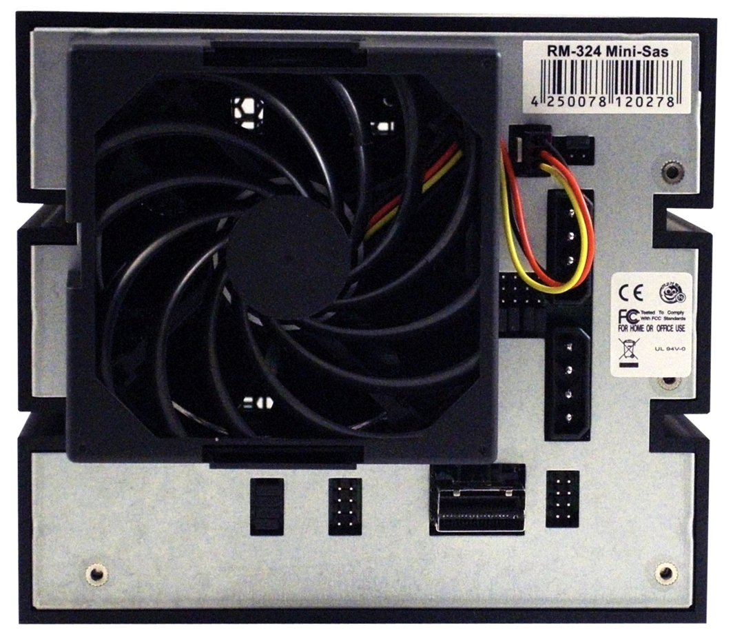

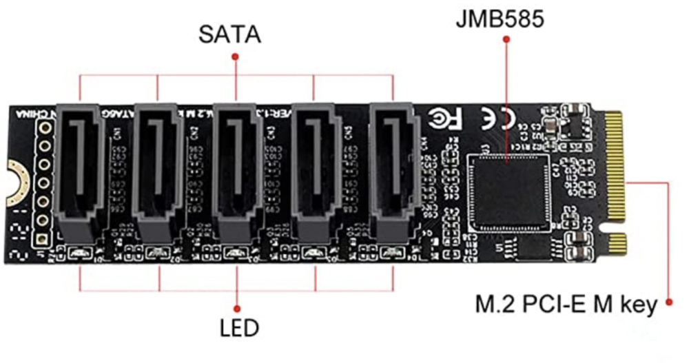

  14. Danke habe ich schon bestellt kommen morgen an. Werde heute dennoch mal mit 3 single Platten die noch frei sind mal mit dem LSI 9211-8i ein raid5 in der vm aufbauen und anschließend gehen die beiden JMB585 tauschen und die Platten verstreut über beide Controller durchreichen. Hier gilt es dann zwei Hürden zu schlagen. 1. den Fehler ‘127‘ zu vermeiden beim durchreichen der Controller 2. hoffen das der Synology VM für das RAID5 die Laufwerks Reihenfolge und Aufteilung egal sind. Das habe ich vielleicht missverständlich ausgedrückt. Als ich meinen Server vor drei Jahren aufbaute hatte, waren die Backplanes noch nicht vorhanden. Somit hatte ich den LSI 9211-8i direkt an den sata Platten mit den o.g. Kabeln im Einsatz. Als dann später die Backplanes kamen, mussten SFF zu SFF Kabel her. Jetzt wo ich das hier gerade schreibe fällt mir ein, das ich mir damals schon die Frage der Reihenfolge in den Backplanes gestellt hatte. Damals aber via Try and Error einfach ausprobiert und es hat geklappt. Also entweder hatte ich Glück und habe in beiden Backplanes die Reihenfolge korrekt erwischt oder dem raid ist es egal in welcher Reihenfolge die Platten kommen.
