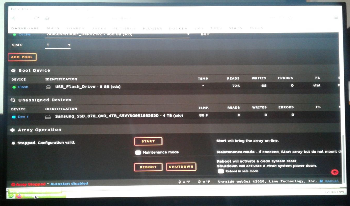

I am using UnRaid OS version 6.9.1 and booting straight into GUI mode on the same stand alone machine. Additionally, I am using an LG 4k Monitor which is connected to an Nvidia 710 card via an HDMI cable and also have an Nvidia 1030 for my Ubuntu passthrough.  The problem is my UnRaid OS GUI resolution makes everything on the display appear very big as shown in screen capture below:
When I go to the DISPLAY SETTINGS area in the GUI I cannot find any monitor resolution setting that will allow me to see my GUI in a 4k resolution.
How do I install an UnRaid OS compatible Nvidia driver that will allow me to view my UnRaid OS GUI in 4k mode?  Any tips will be greatly welcome.

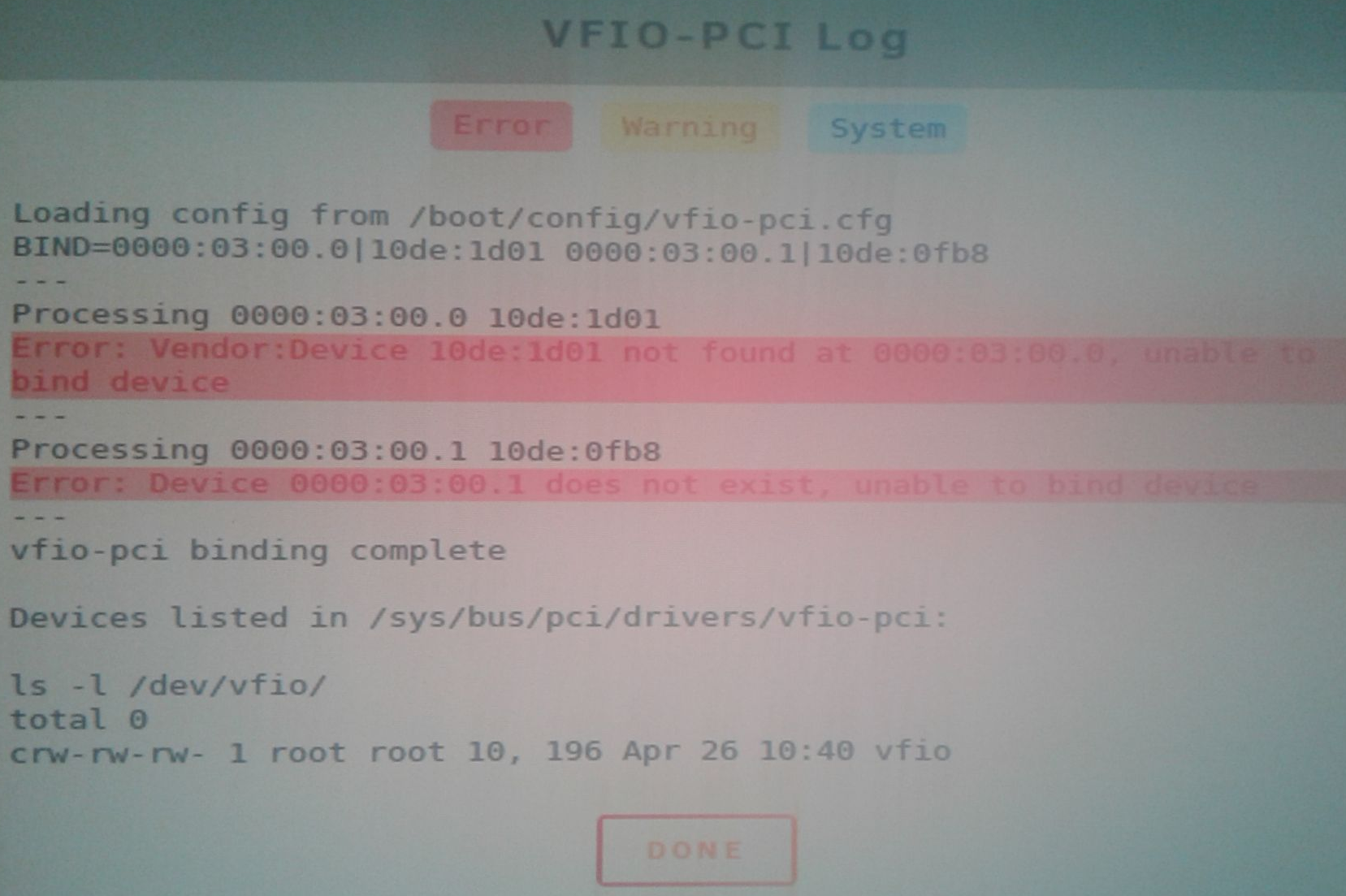

I am adding the screen capture below which shows my VFIO PCI Log. The pink errors are associated to my 1030 card which is showing up missing after I installed my 710 card.  The ERROR reads: "Vendor:Device #### not found at ####. Unable to bind device."  One error is for the GPU and the other error is for the Audio on the GPU.
Does anybody in the community have any advice on how I could fix the error below so my 1030 card can come back as a passthrough binded device? Before adding the 710 card my 1030 card was working correctly and I was able to launch my Ubuntu VM remotely from my Windows10 client PC.  However, I now seek to no longer use my Windows10 client PC and do it all within the UnRaid OS GUI mode environment which is the reason I have added the 710 card.
What is the correct way to install a 710 Nvidia card to the motherboard so the 1030 card installed on the primary PCI 16x slot does not end up dissappearing in the UnRaid OS?   My goal is to dedicate the 710 card to support my UnRaid OS in GUI mode and my dedicate my 1030 card to support my Ubuntu VM as a binded passthrough device.  Any advice will be greatly appreciated.  Thank you for your time.
Unless the supermicro bios has the ability to let you choose the boot gpu (not a common option), you might need to swap the 710 to the top (x16) slot which is typically a primary GPU slot, and then move the 1030 to the x8 slot.
If you do this, you will have to update the binds and the vm config for the gpus, as the hardware addresses will change.
Actually disabling the onboard might have changed the hardware addresses in itself, maybe try setting these again (bind + vm config) before doing the above

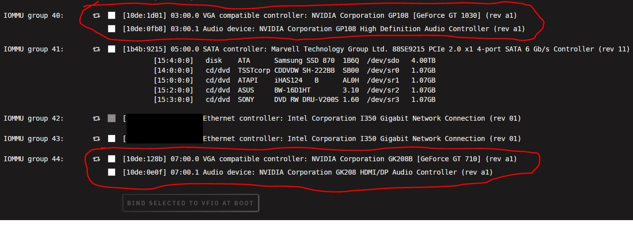

Thank you for the post Tjb_altf4.  This problem with my 1030 card dissappearing from my UnRaid OS System Devices list after I addied a 710 card seriously kicked my butt.  I spent an entire day fixing this problem.  Not sure which of the three approaches listed below fixed the problem:
  1. I reset my Supermicro Motherboard BIOS to factory default settings.
  2. I deleted the SpaceInvader One VBios dump script.
  3. I deleted the data found in the /config/vfio-pci.cfg file located on the Flash drive.
The result is shown in the screen capture below. In short, I can now see both my 1030 card and 710 card listed in my UnRaid OS System Devices like it suppose to be.
Now I have the ordeal of re-establishing my 1030 card as a passthrough card to support my Ubuntu VM.  I plan to re-apply the SpaceInvader One Vbios dump scipt to make that happen. My confusion is how SpaceInvader One in the middle of his video shows he also applies his script to to his 710 Nvidia card.
In my case I think I should only apply his script to the 1030 card and not my 710 card. And then after I apply his script to my 1030 card I am going to do what you mention about clicking on the BIND VFIO AT BOOT button after I select my 1030 card.  Nevertheless, my question is if it is necessary to apply SpaceInvader One VBios Dump script to both my 710 and 1030 cards?  Any advice will be much appreciated.  Thank you for your time.
