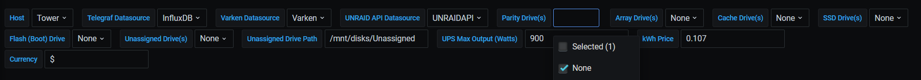

  1. Found the issue! i didnt had device_tags = ["ID_SERIAL"] set in [[inputs.diskio]] All working now!
  2. love the dashboard! have been trying to set it up. 90% works. the only thing i am not able to figure out is how to get the SSD section to work. i think it is because for some reason i am not able to get disks to show here they all show as in the screenshot.. i went through my telegraf.conf again with Gilbn's guide, but everything is setup according the guide. any ideas?
